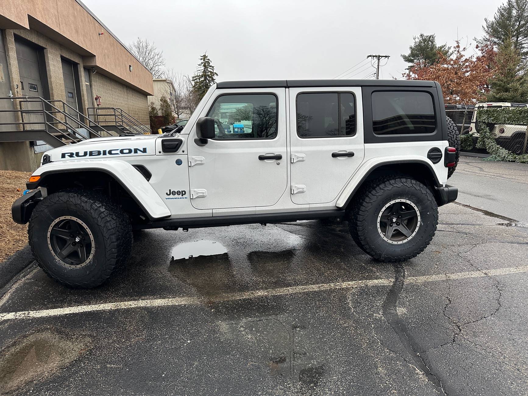

37” K02 mounted. No rubbing even on uneven roads / streets or going over potholes and dips. 2.5” lift should be more than enough for off roads.
Meanwhile the tazer JL mini instal did not go smoothly. I now have ABS and traction lights on. Probably procedural error. Will reset, unmarry and try again tomorrow.
You ended up going with the mopar 2” lift and the 37s clear? I have the mopar lift but I added .5” spacers to get a bit more. I’m planning of switching my 35s for 37s soon.
