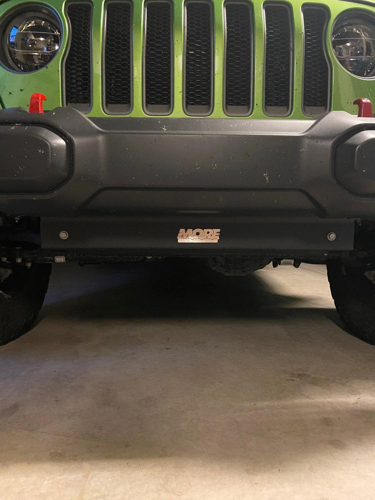

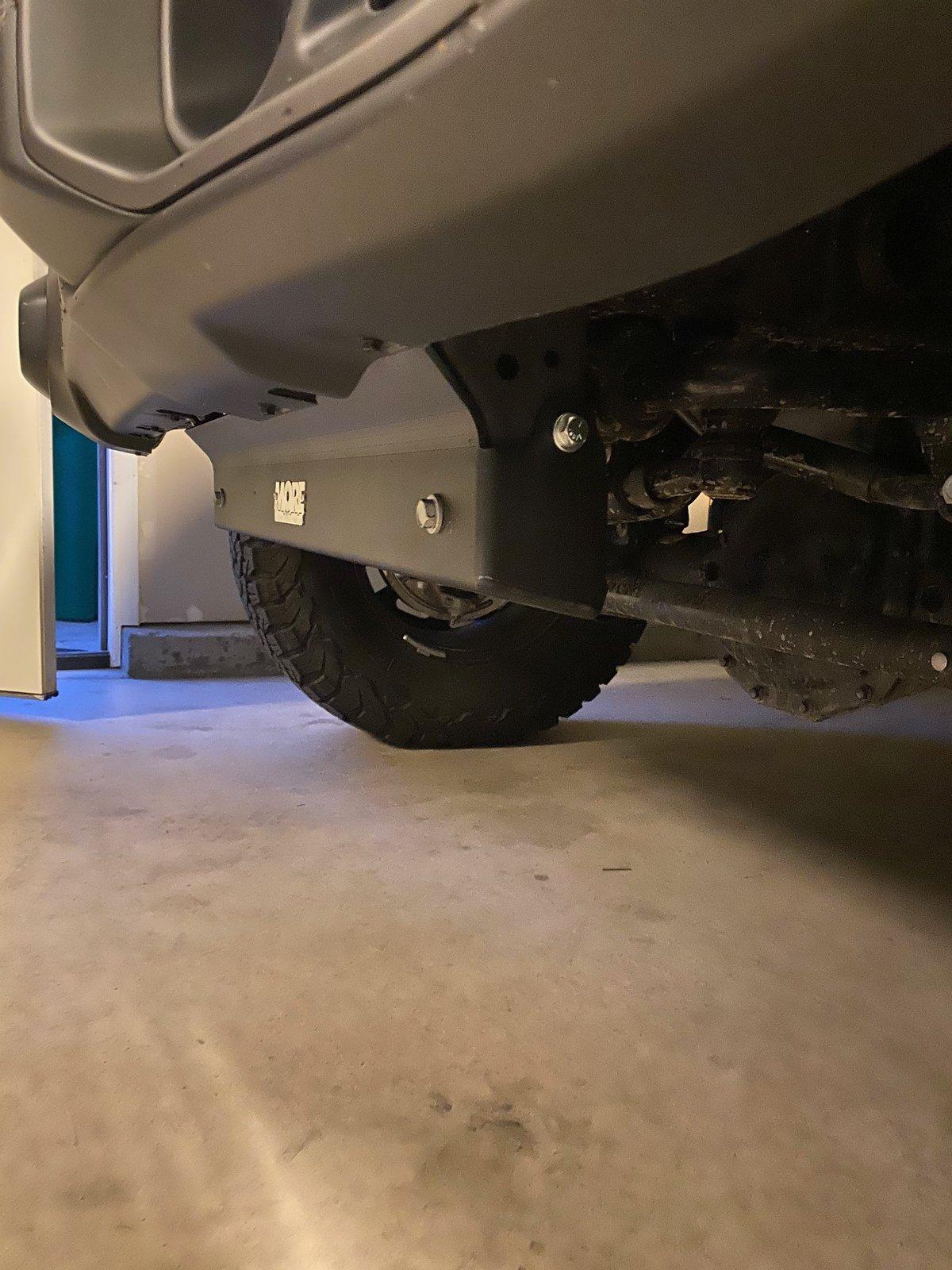

For the factory plastic front bumper, the M.O.R.E. front skid plate can be used. I just put it on my 19 JLUR. It's a very easy install (took longer to remove the factory plastic shield/thin steel skid) than to bolt on the M.O.R.E. unit. It's also thicker than the steel bumper skid plate.
If you ever move to the Jeep steel bumper, it should still work. This skid will not work if your Jeep came with the steel bumper group. The frame ends are different. I originally tried installing it on my 18 JLUR with steel bumper group and it did not fit.
Jeep Wrangler JL JLU Rubicon rock guard IMG_0245
Jeep Wrangler JL JLU Rubicon rock guard IMG_0246
