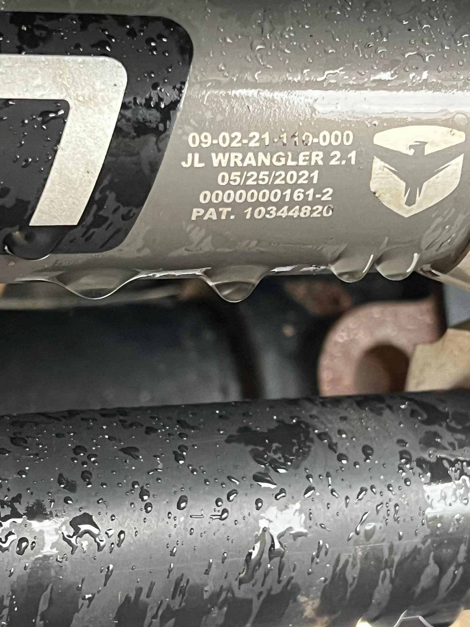

I got the Falcon EF 2.1.
The garage also told me that the caster angle was a bit high. But problem only appeared after the tie rod and stabilizer changes. Caster angles was already on the high side for almost a year.
I will check the torque myself and make sure everything is tight.
