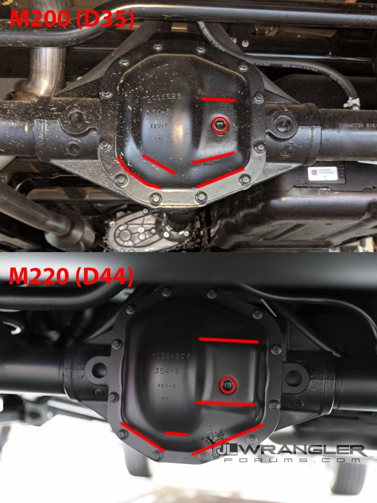

I do have the tow package it also says anti-spin differential which I thought only came in the Dana 44.Not so quick. My window sticker says 3rd generation Dana 44 HD rear axle, but I actually have the M200. The Dana 44 (M220) is "standard equipment", if you add an automatic transmission you now get the M200, unless you get the tow package then you are once again back up to the M220.
Yup, you have the 44 then.I do have the two package it also says anti-spin differential which I thought only came in the Dana 44.
