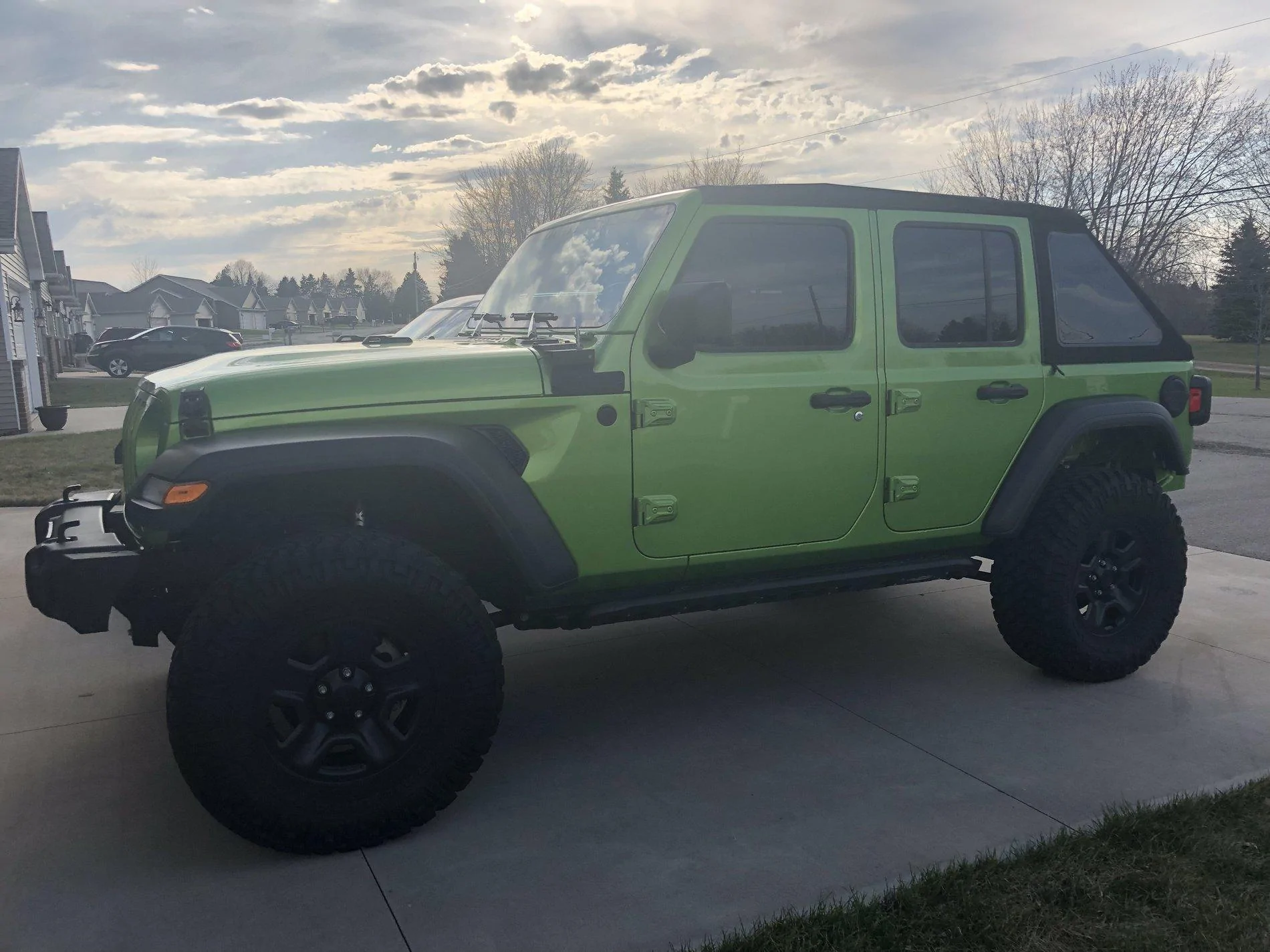

Jeep Wrangler JL JL Trektop IMG_2707

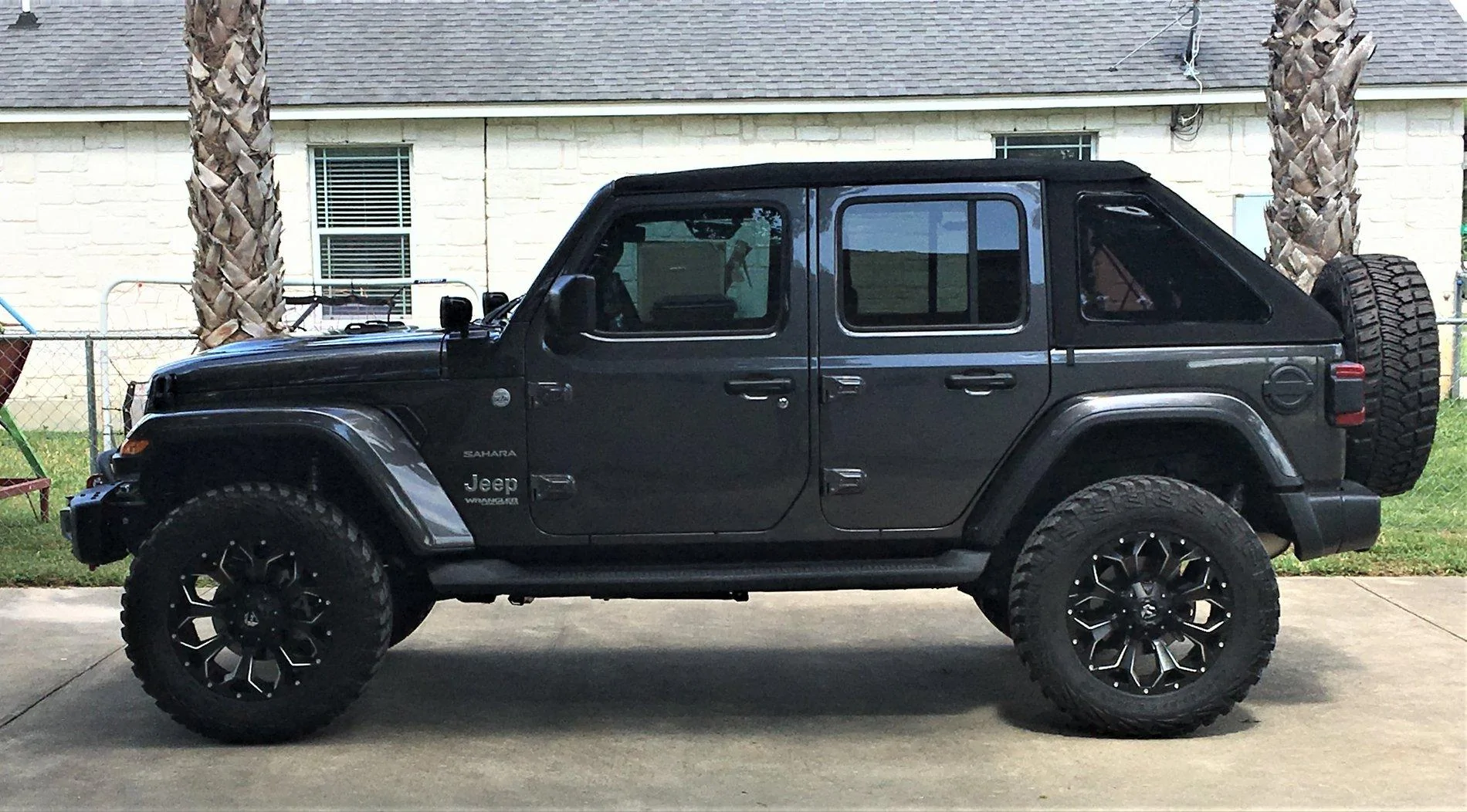

Jeep Wrangler JL JL Trektop IMG_2698
So this past weekend, I put on my trektop on my jeep. It took me approximately 4 hours for the installation and have to say that I really like the way it looks. I let it sit out in the Sun for two days between 80 - 85 degree weather to allow the twill/material to stretch and set on the Jeep. The third day, I drove it up 70 mph with no flapping at all. I was very surprised that I couldn't tell the wind noise difference between the hard top and the trektop.... It was actually quiet.
The following day I drove it to work, which is approximately 35 miles away from my house and mainly open highway with no issues at all. Later on that evening on my way home........ It all started " the flapping of death" from the rear window at 65 mph. I slowed down then it stopped, but then the "flapping" again started at 65 mph. As soon as I got home everything seemed to be intact together. The following the day it did the same thing.
I have to say it's very disappointing especially for the amount of money that we all paid. I'll be calling bestop customer service to report this issue
