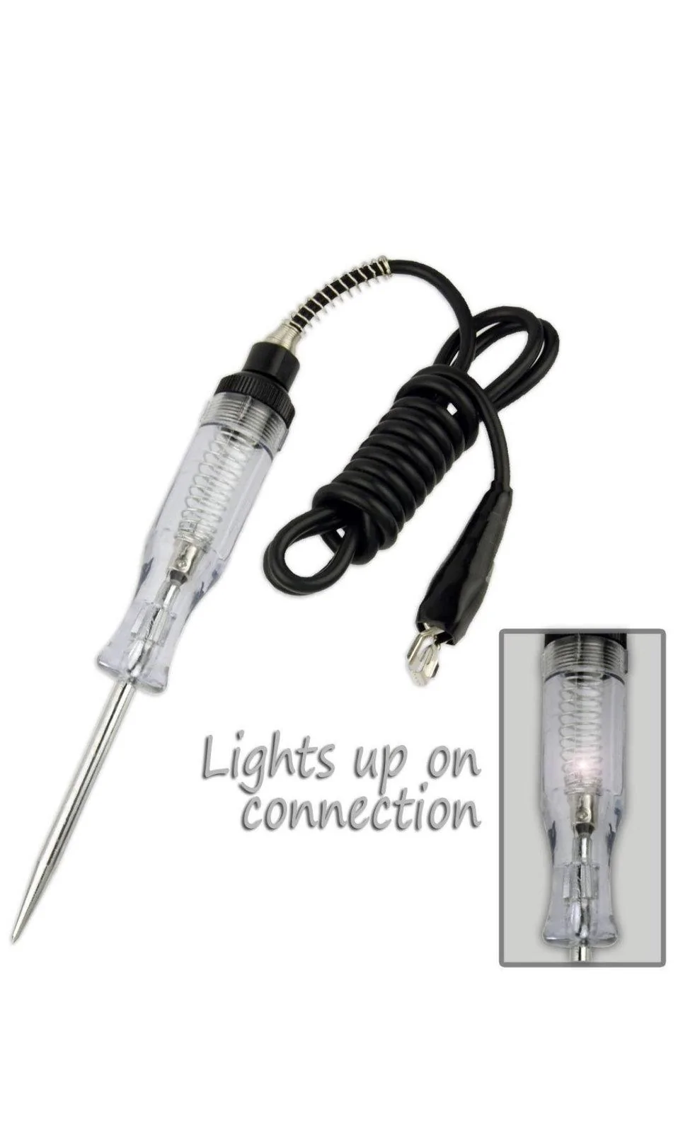

No I just used a basic light test tool. Alligator clip on one end and probe on other. Lights up for all but that pin. Same on both plugs, the 4 and 7. Can hook up any other vehicle to trailer and all lights work there as well. I don’t get any power on the 3rd pin down. It’s like this tool.
