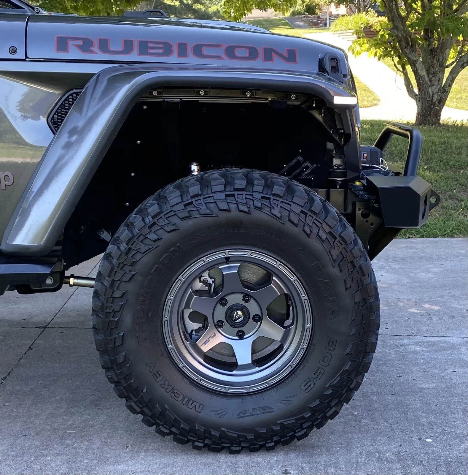

Thanks for sharing!! How did the paint process work for the rugged ridge fenders? They look great
it was “good”...but not great. The RR Flares are textured, so if you want it to be flawless, it will take some considerable prep. They are not bad though, and definitely something i can live with. The trade off of having a factory “trimmed” look, outweighs the anal retentive tendencies I have of the texture coming through the paint. Lol.
Thanks for taking the time to respond. For what it’s worth, in the pics they look great. I definitely sympathize with wanting chopped fenders but with a factory look. There are hardly any good looking fender or fender chop options on the market. Your solution is one of the best looking I’ve seen
