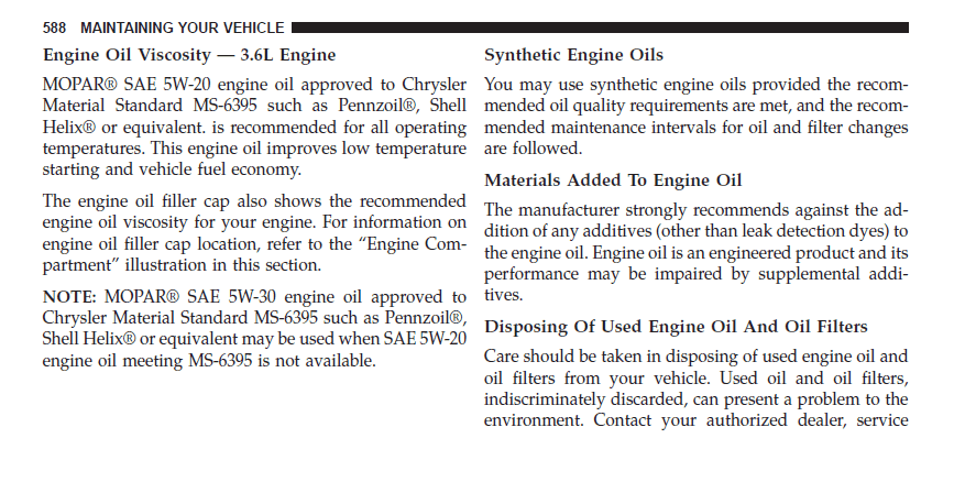

@dayusmc
Here is a screen shot from the JK owner's manual. I also have attached the JK Owner's Manual here.

Thanks. Those oil threads get so long and confusing... I must have read it wrong.

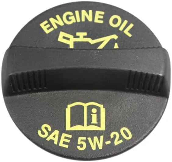

All I buy is 5W20 containers of full synthetic motor oil. I use 5W20 for JK's and JL's.
FYI: Oil Filler Cap and Oil Filter Housing Cap are in form, the same, for both the JK and JL....
BUT .... the Oil Filler Cap, the JK is labeled 5W20 and the JL's is labeled 0W20.
The oil filter housing cap, OEM Part# is 68191350AA for both a JK and JL.
Jeep Wrangler JL JK Gas Cap??? Mopar Oil Filter Housing Cap - 68191350AA
