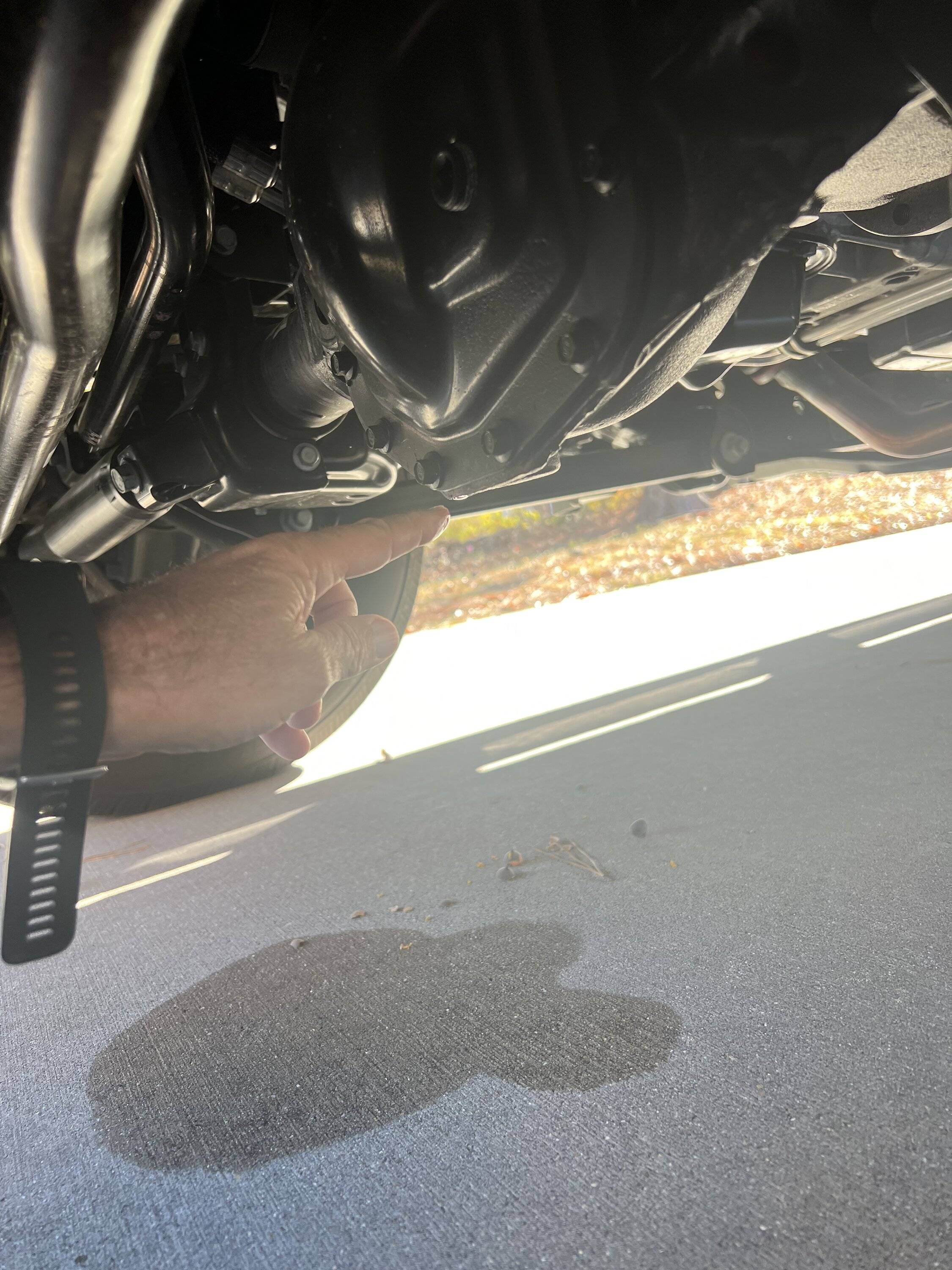

Yesterday I also noticed a small leak of fluid coming from the bottom of my engine. Hmmmm.

Oh no...Have you had it diagnosed yet?

I’m taking it into a Jeep dealership next Wednesday. That’s the earliest appointment they had to check it out.

So, the dealership in Atlanta told me that the leak is actually engine coolant coming from a faulty hose that was installed in the factory. However, because of the Auto Workers recent strike, the part was just recently shipped, and is currently sitting in a parts depot in Atlanta. The dealership has had my Jeep Wrangler for 19+ days. The Ed Voyles dealership had no loaner vehicle for me.
The “lurching” I’m told is probably a software issue.
Frustrating.
