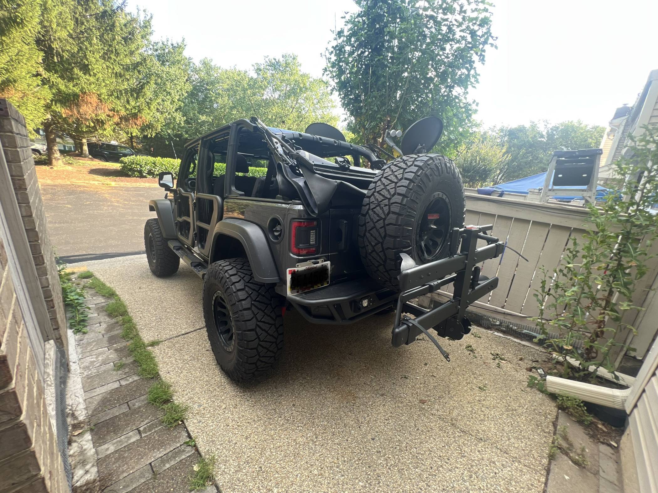

It’s ok no worry’s I hope you guys had great time. Here my jeep
Jeep Wrangler JL Jack mount IMG_1798
Jeep Wrangler JL Jack mount IMG_1810
Jeep Wrangler JL Jack mount 71080644923__0F0D4367-49F9-46F8-B4A9-657FD5235225
Jeep Wrangler JL Jack mount 71080638922__6BC1D609-7406-481A-849A-CE2D8B94592F

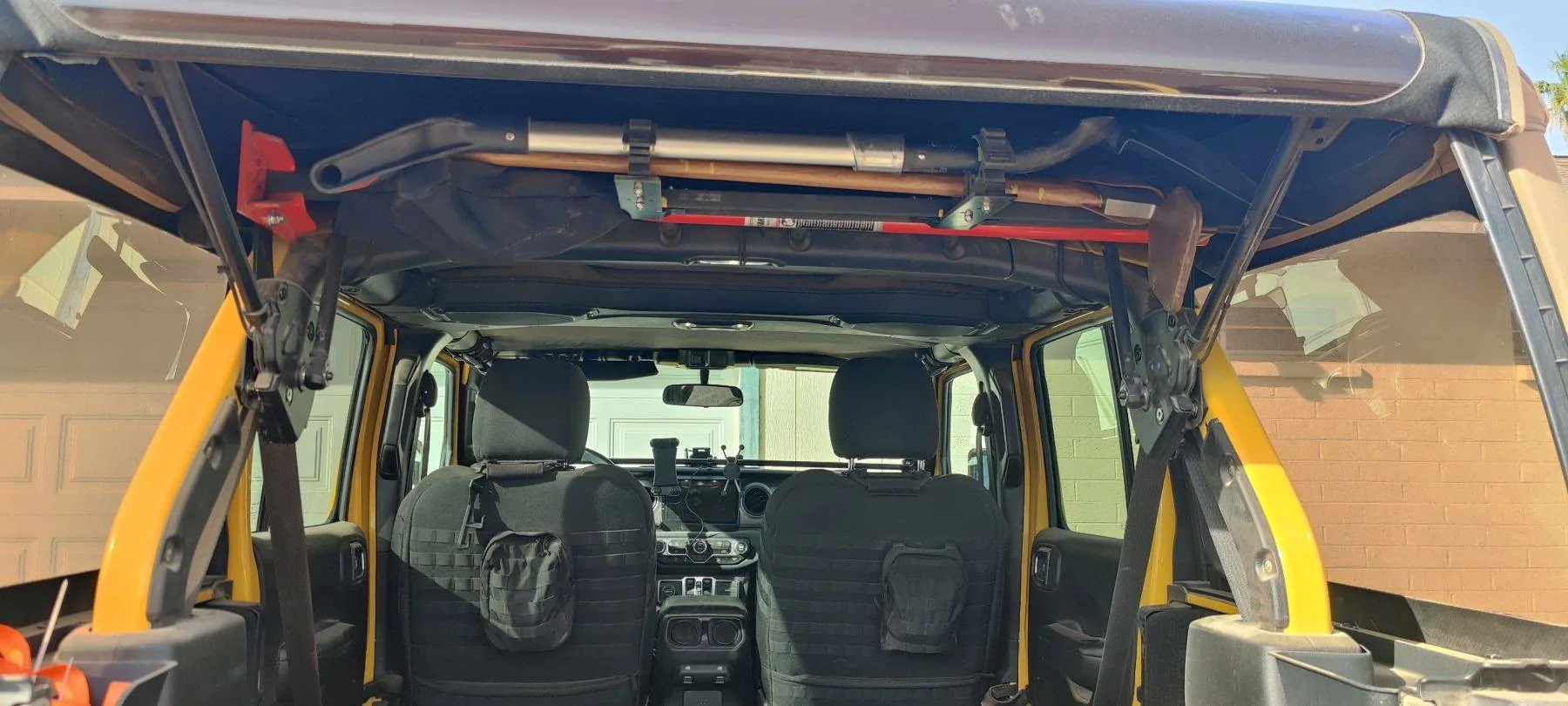

I went out & put the shovel back in the mount. Brought back all I did to get it all mounted. The jack kit only mounts the jack, to mount other items requires the Hi-Lift Accessory Bars. A combo kit with the jack and accessory bar kit can be found Here. Also worth noting the top can't be put down with jack in place.

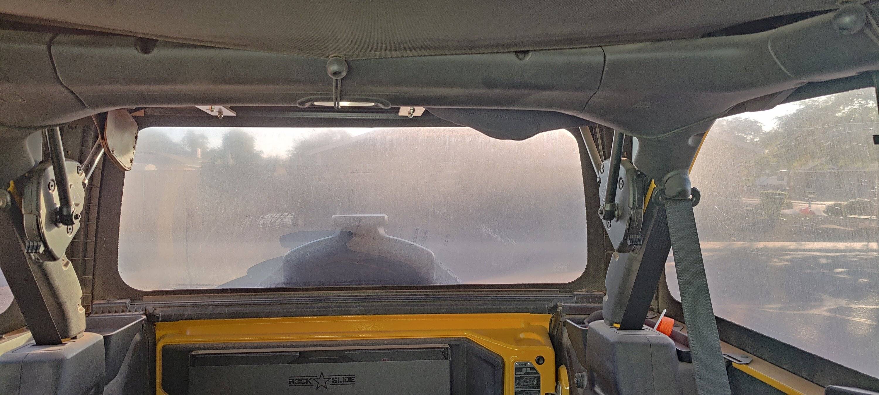

This image is from driver seat looking back:
Jeep Wrangler JL Jack mount IMG_20231204_083748

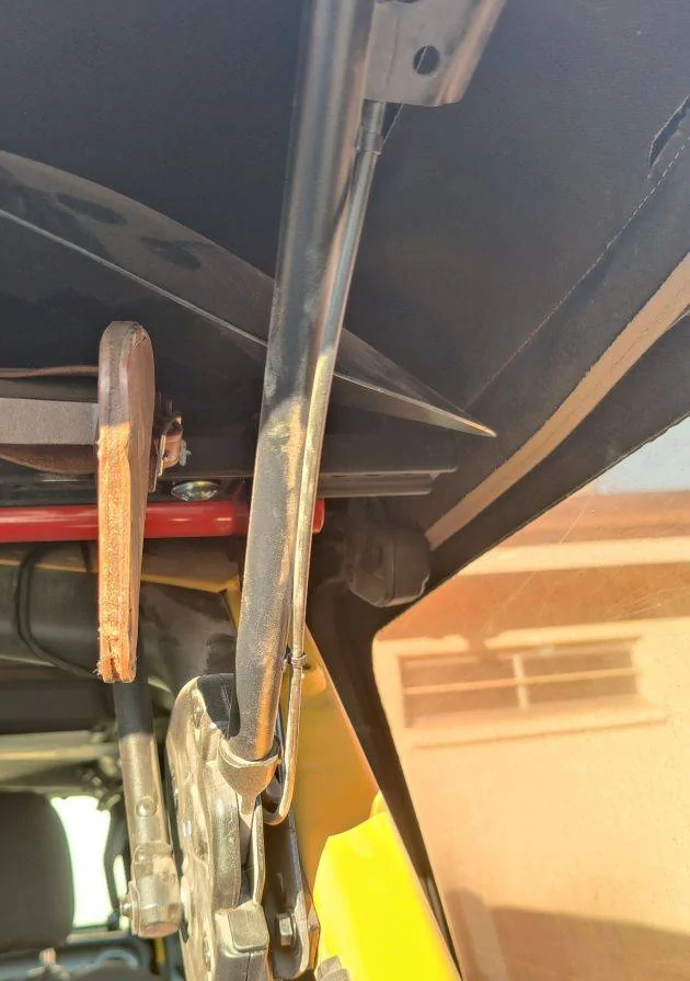

Pics of the mount with the Pulaski still in place.
The yellow is from a paint marker pen. I need to redo the ones on the ax handle. I put marks
on everything so I can place them back in position that works after use.

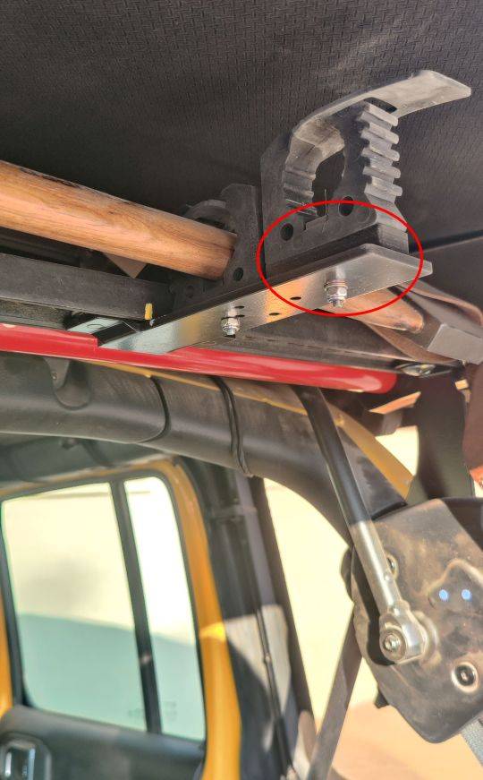

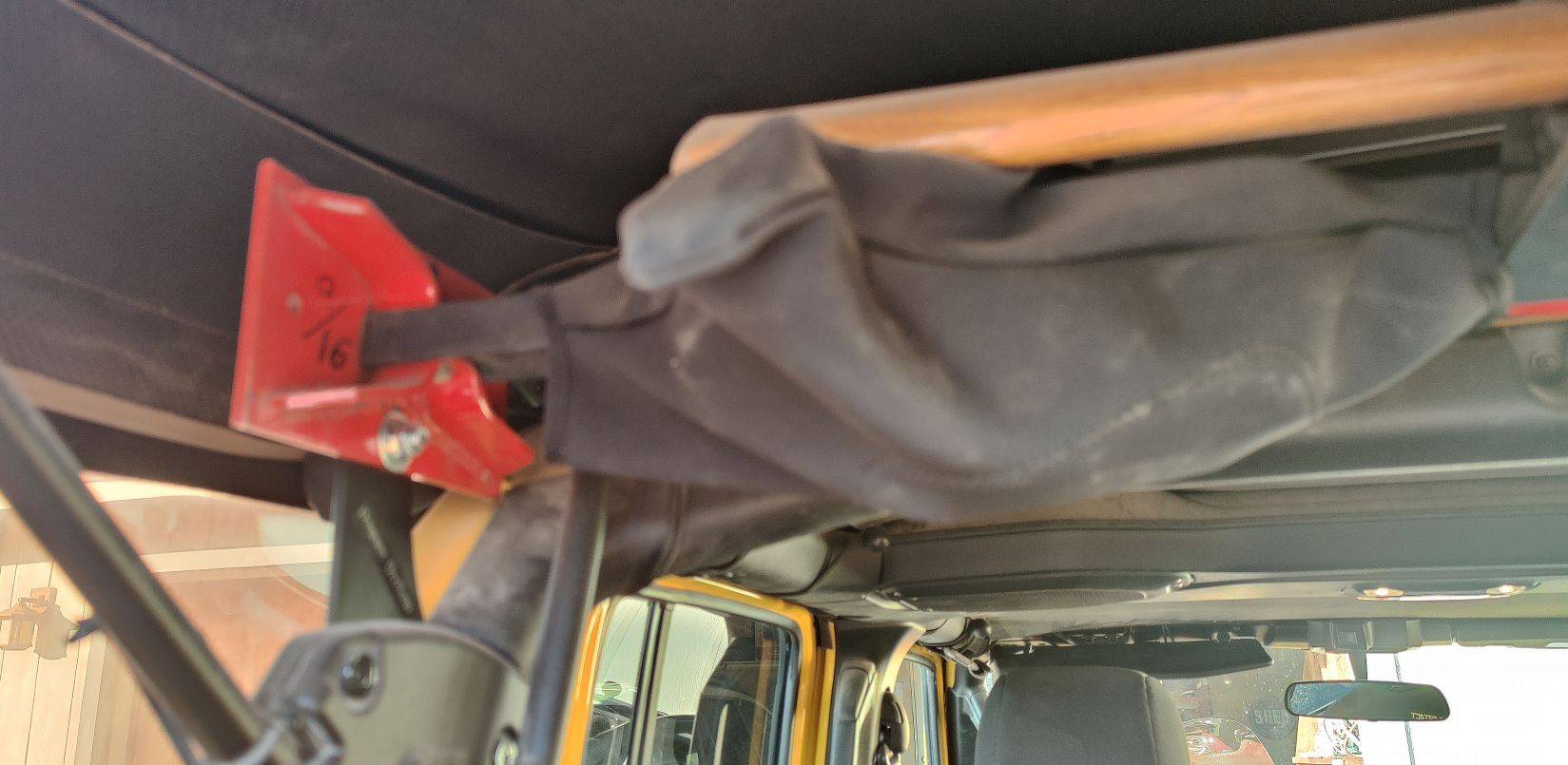

I made a spacer for the monkey fist (red oval) on the right so shovel would clear the Pulaski.
Jeep Wrangler JL Jack mount IMG_20231204_083229

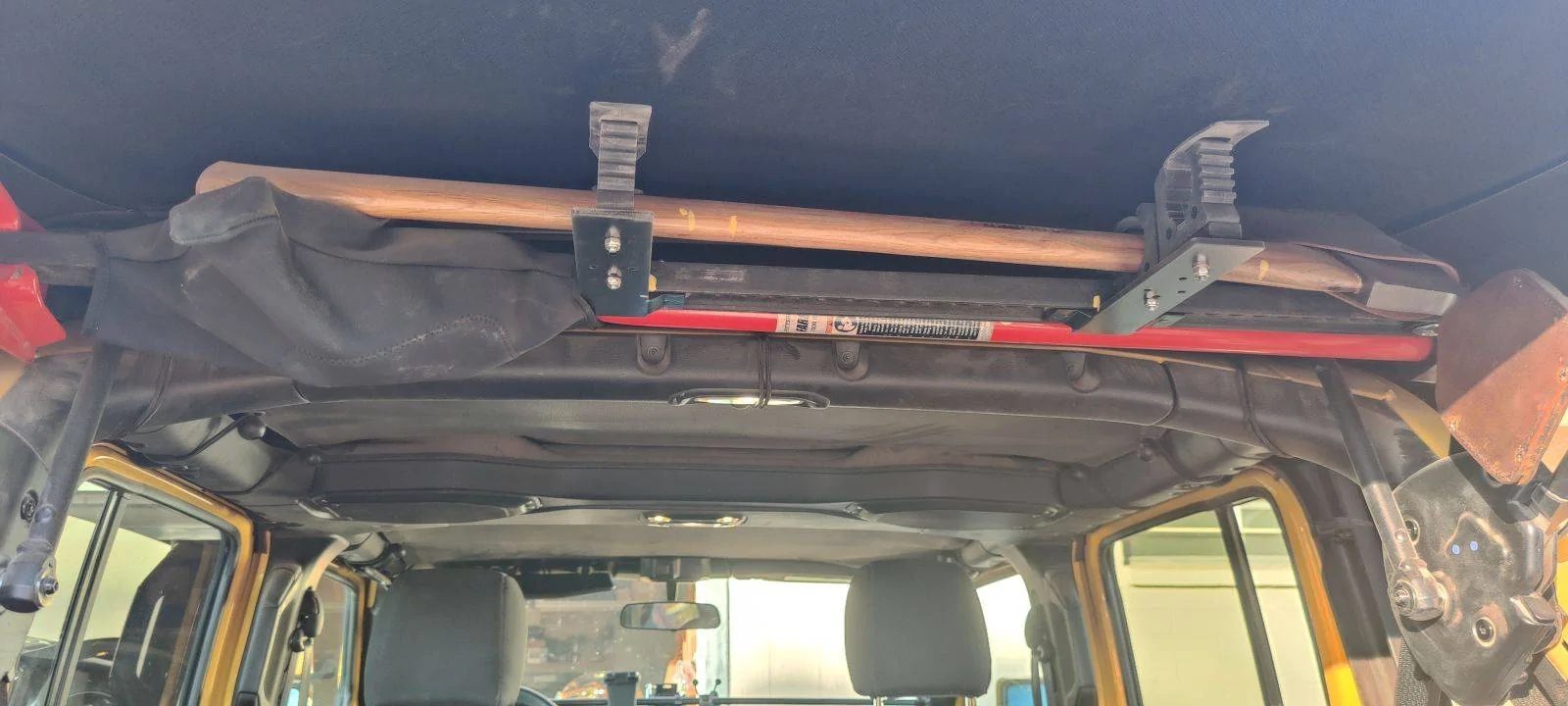

Everything mounted.
Jeep Wrangler JL Jack mount IMG_20231204_101926
