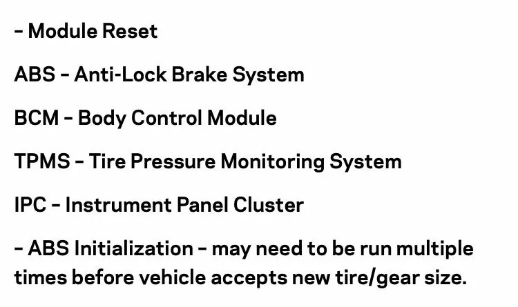

What are you using to reset the codes?

I just had these same codes pop up. I tried to clear them with the Tazer, but it won't clear them. How do you perform the reset mentioned above?
So I ended up resetting everything to stock and then going through and doing the tire size, etc again. After that I did the abs initialization and it cleared it out.

All is good now. After centering the steering wheel I went for a 10 mile drive to get my mail and just before I got home the light went out on it's own. I used the Tazer to check for codes and there were none. Never thought the steering wheel being off-center for such a short time, (4 mile drive), could cause something like this. Really makes me miss my CJ7 at times.
