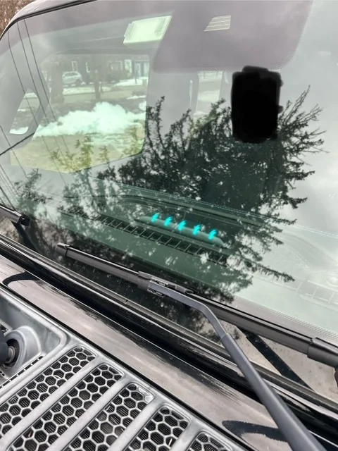

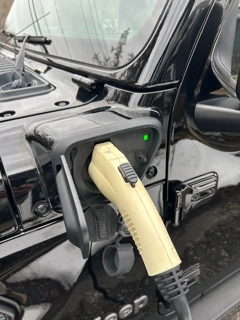

I picked up my '22 Wrangler 4xe this morning after having the 68C recall update done yesterday afternoon. The vehicle drives normally as it should with no noticeable difference in operating. As for the issue, once the charge cycle completes, the blue dash lights and green charge port indicators go off as they should. However, after an hour or two, the charge light indicators come back on. The five blue lights remain solid as well as the green charge port indicator. They will stay on until I unplug the vehicle. The dash screens are all off and key fob is not close. I've cycled the vehicle multiple times with no change in the behavior. Has anyone else experienced this pre or post the 68C update? I am not seeing anything else reported on here or the 4xe forum. The dealership also doesn't know.

Just to add to this - I unplugged the charger last night. This morning, the HV battery drained 5% overnight which has never happened pre the 68C update. Would love to hear from anyone else who has had 68C done to see if they are seeing these behaviors.

Thanks for the reply. I have never used the charging schedule and double checked nothing was set via the Jeep and it wasn’t. So not sure the schedule is the cause?
I can only suspect the 12v battery is getting low at this point (3.5 years old) and the recall install’s heavy load on it expedited its near death. Or there is an issue with the software itself. Will post an update when I learn more.

I had the 68C recall completed. The other evening I plugged into a Level 2 to charge. The indicator lights went off after the charging was completed, but I did not unplug.
A few hours later I saw the indicator lights were back on. Left it plugged in and went for a walk with my dog. When we got back, the lights were off.

Thanks. For mine, the lights will always come back on 1.5-2 hours after the level 2 charge completes. They will stay on for a long time but eventually do turn off. But will be back on in the same 1.5-2 hours timeframe again. There hasn't been a time they were not mostly on at this point. This is only when the vehicle is plugged in to be clear.

Mine is now fixed and operating as it should. The dealer worked with Jeep's Techline to reinstall the software. Techline helped them follow the proper protocol to undo and redo.

Unfortunately this issue has returned. Seems like others on the 4xe specific forum also have experienced the same or similar iterations of this but with no resolve. @alphawolff would appreciate your insight here if you’ve seen any cases of this at your shop. Thank you in advance and appreciate all your input on here.

Just replace your 12v battery and see what happens. Make sure you don't have battery per-conditioning enabled or hvac scheduling turned on to verify those aren't the cause
