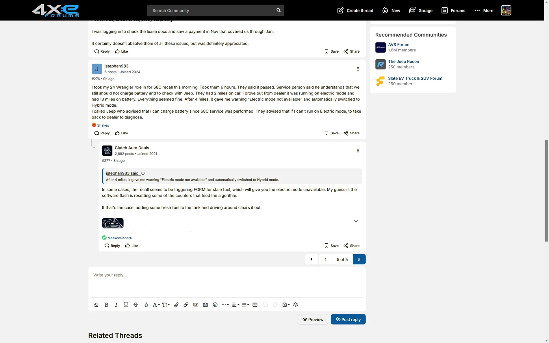

Not sure if this is related or not, no mention of check engine light. Let us know what you find out, or if it self-corrects somehow.

Interesting, I dont think it's that because it's not giving me the FORM message and it's definitely had fresh fuel pretty often lately - including late last week. If it's doing it still when i go out this morning, ill be calling them. I may take it to advanced auto parts as well to see if it is throwing any codes for the CEL

CEL flashing before start means the emission monitors aren't set. They are reset during the flash updates and subsequent DTC clearing. Ignore that.
The other issue you mentioned seems random and I've heard of it before with the most recent software updates. Not sure if there's any actual fix without a CEL being thrown.

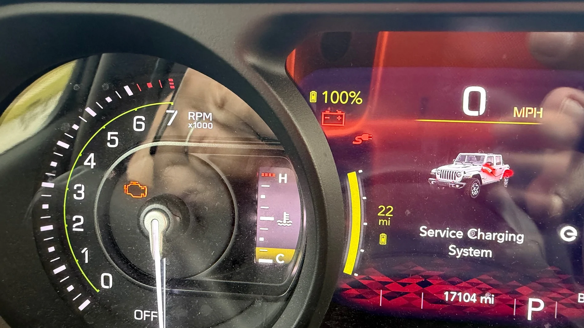

I got the recall “fix” done on mine a few weeks ago. Never had any problems before the fix and it was running fine after the fix. When I started the Jeep yesterday, the gas engine went on right away and then everything just shut off at the end of my driveway.
I let it sit for a few hours and then I got it to start again. Drove it to the dealership near my house and left the key in the dropbox. Only a few miles away. It was struggling to go over 25-30mph on the way there. Max Regen, Air Conditioning, and a few other things not working on the way there. Battery stayed at 100% for the whole drive.
Service Advisor called me and said they're working on diagnosing now.

"A case has been opened through Stellantis for you. It will need a battery - system states Replace HV Battery Pack. When I get more information, I will notify you ASAP"

I had the 68C recall visit at the end of December. The report from the service call said it passed the battery test. A week or so later it wouldn't shift out of park and gave the message "service charging system". I took it back to the dealer and they said it needs a new battery. Waiting on that now.
