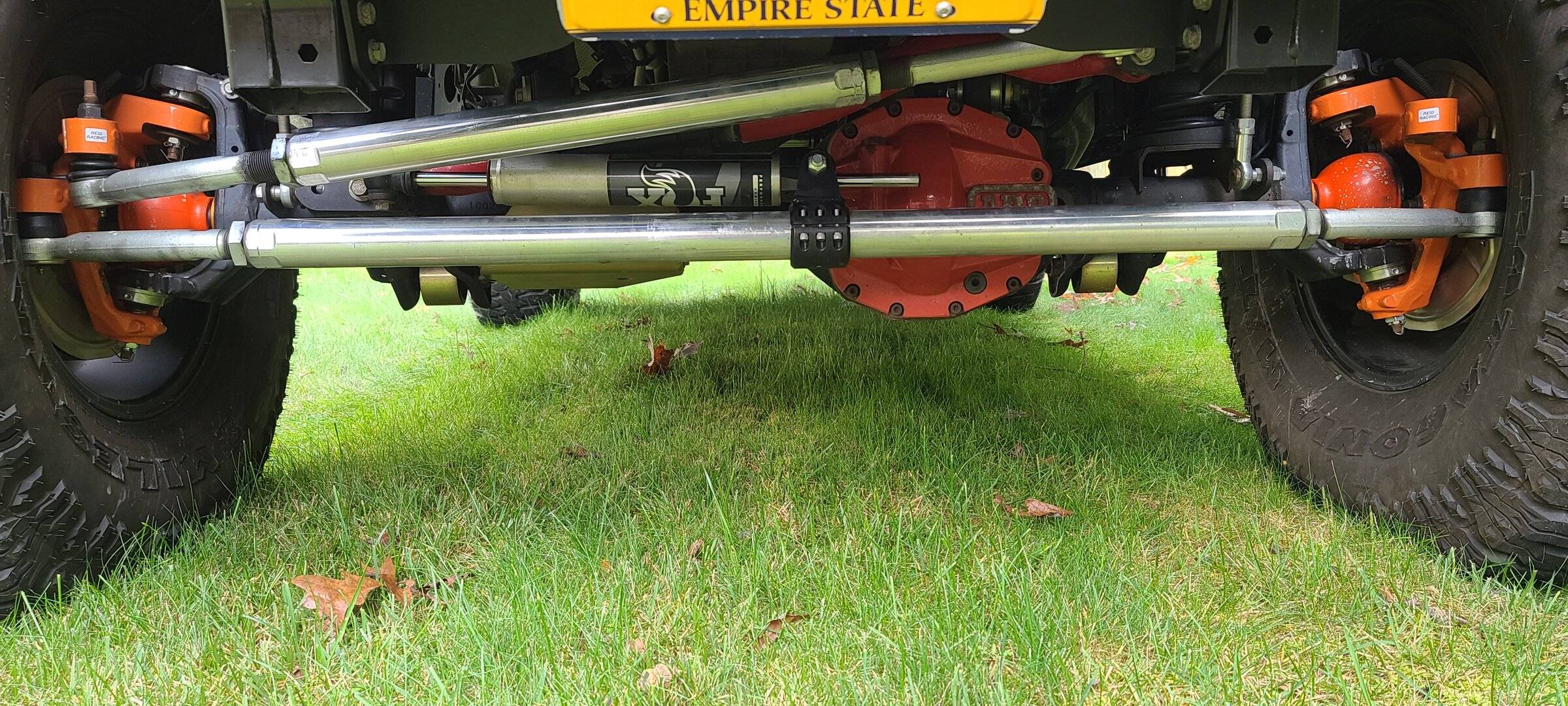

Thanks again for the advice. Do you feel the OEM is good enough for most lifts of 4"?
The oem bottom mount location of the drag link? Yes, it's perfectly fine for 4.5" of actual lift and below. I got 4.25" of actual lift from the 3.5" Metalcloak Gamechanger, and the bottom mounted drag link worked just fine. I had the full SteerSmarts front end linkage set for nearly 50k miles and they are great components. I just recently swapped them out for even stronger components, but still stuck with bottom mount.
