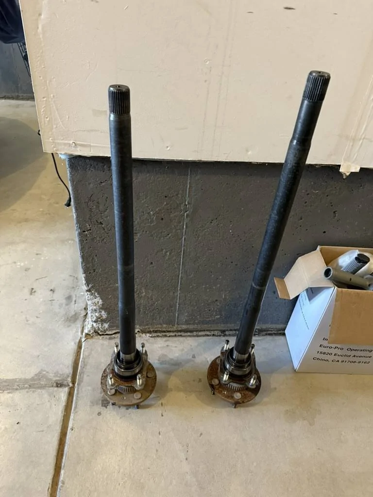

Thank you all for your insights and replies! Do you think replacing the axle shafts to chromoly shafts is a good fix?
I guess it would also offer a significant upgrade over stock.
I do have a Sahara with Dana 44 Narrow SelecTrac.
Jeep Wrangler JL Is this so simple? F54F01CF-446E-46C1-97C8-5420AF1692F4_1_105_c
Bearings going was my excuse to finally upgrade to chromoly. Though in hind sight, the stock shafts are in perfect condition and it could have justified me buying a press for the next time the bearings go. 🤷‍♂️
