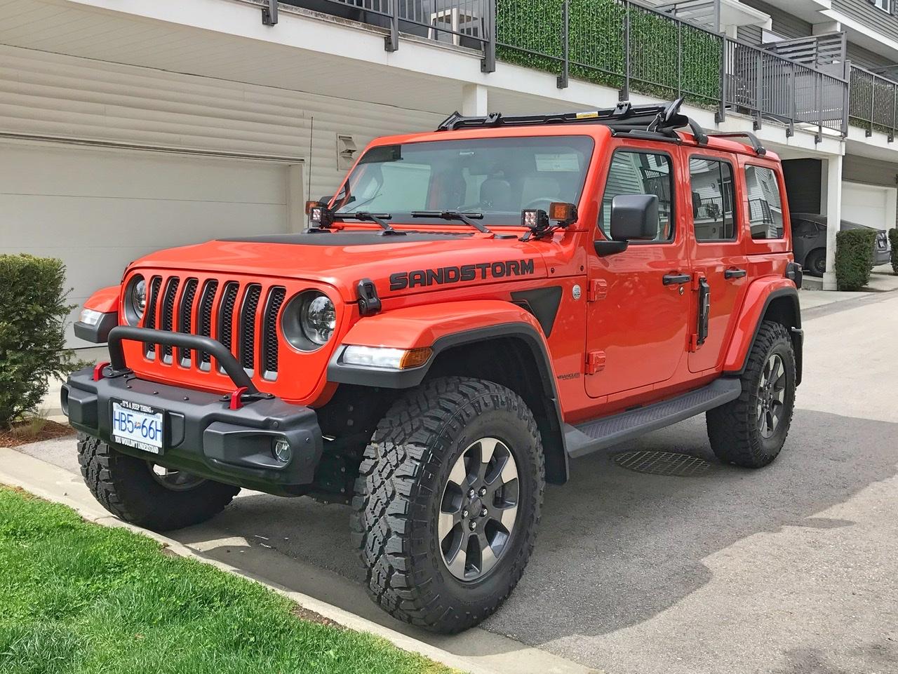

Even though you said you got the Sahara for a good price, but for the cost you are dumping right now onto the Sahara, not sure why you didn’t just get a Rubicon instead and deal much less headaches. The axle swap and regearing plus labor itself probably brings your Sahara to Rubicon pricing and you are still missing rear locker, 4:1 transfer case, electronic sway bar disconnect, high tuck fenders and etc.
FYI my Sahara runs on 35s (stock axles, stock gearing, no wheel spacers) just fine without doing any of that.

What size tire do you have on there? I thought the stock 18” rim could only hold a 33”? I am jealous of you being able to run logging trails and such in BC.
Arterius2
Jerry
Dec 29, 2018
42
3,527
4,857
Vancouver, BC
2018 JLU Sahara 2.0L
They are 35”, 285/75/18 Duratracs to be exact. Special ordered from Canadian Tire when they were on sale for $300 per tire.
