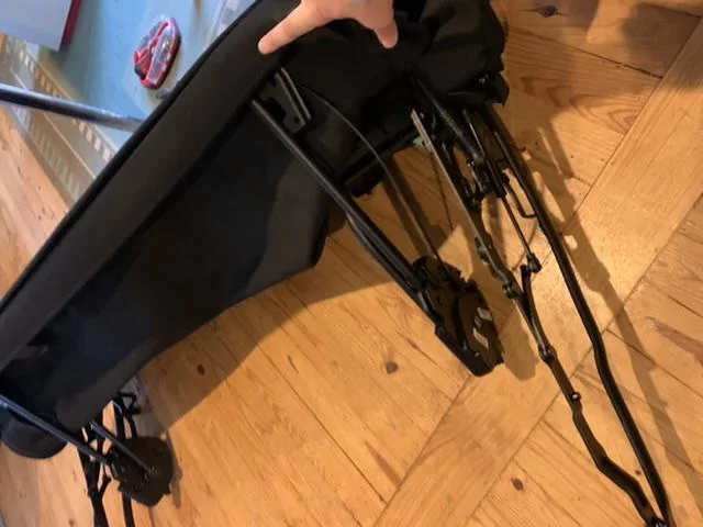

I figured it out... Now just need to try and explain it.
The reason it seems to unlock so easily when it's assembled on a jeep and NOT so easy when it's off is because each of the locking mechanisms can "twist" when they are bolted in. But they can't do their necessary "twist" when the Diabolical plates are in place.
SO with an extra set of hands you need only grab the bottom of the mechinism with one hand and push the top of it the other direction with the palm of your other hand and TWIST... You'll feel it twisting "with much effort" but as it's twisting you'll get this "AH HA!" feeiling, knowing that this is gonna work... while your assistant "very easily" flips the switch! I'm going to try and upload a little video showing it being done.
To be more clear, the mechinism isn't "twisting" when it's bolted in. YOU are twisting the mechanism by hand when the whole setup is NOT in the jeep. It's probably only going to make sense when I get this video uploaded.

I made a video of how to unlock the top when it's off of the vehicle. Should help to explain the process by seeing it in action.
MUCH better Video than the one I was trying to upload. And “pivit” is a much better description than “twisting”. But anyway... YEA, what he said!!! Do that! Ha!
