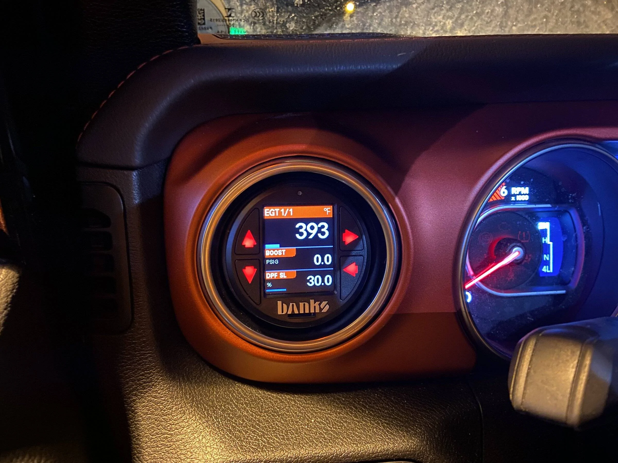

Installed the Banks idash gauge tonite. Pretty slick little unit, lots of data you can look at. Any suggestions for what to watch? I’ve got EGT from bank1/sensor1, boost, and DPF soot load. Anything else/different I should be watching?

You should be watching regens status too.
I like the way it fit in the air vent and looks OEM. You installed it yourself?

I get oem regen messages from the GDE tune. And thank you, I did install it myself yeah. I’d do it differently if I did it again. I found a kit for the JK that is meant for this type of install. The vent internals look the same, can’t confirm if it fits tho, but it looks like it should.
I plugged the vent pipe upstream to keep the heat away from the gauge. i took the vent out of the red dash panel, took that completely apart and I hole sawed the outer piece, then removed the other 2 vent fins but left the pivot points on the sides. Once it’s apart it makes sense, wish I took pics of that.

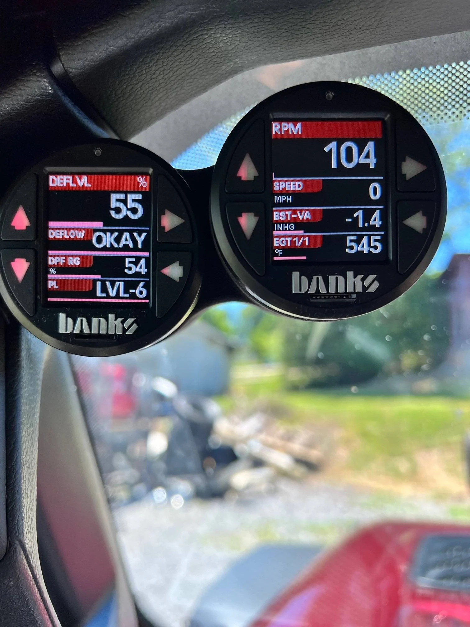

how does that interfere (or not) with the use of your visor?

Easy install. The gauges came with a template for drilling the holes. It was a plastic template thta fit the pillar plastic for a perfect fit. No Guessing.

Yes, The visor can only go straight down. The single or double pod mount would interfere with unrestricted operation of the visor.
I have a single pod up there too and it does get in the way of the visor.
