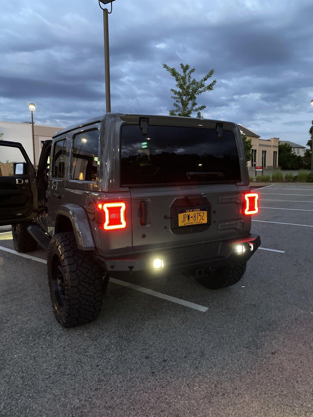

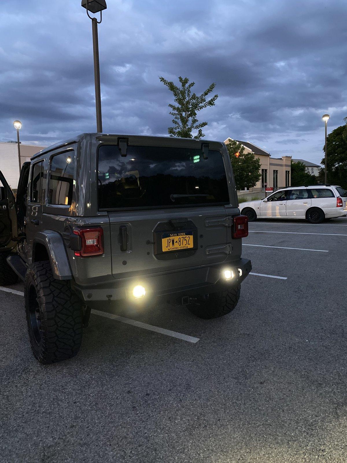

Just installed my new rear bumper with 3" block lights for reverse. Was working good for the day when I would put the car in reverse and kick on - then at night for some reason, they stayed on in all modes. Park, Drive...etc. Did I not install them correctly?
Any input would be great. See pic.

White wire w/ beige trace on the drivers side is what I used and works as it should.

ok I will check it out. I think I am going to order flush mount Baja ones anyway so I will swap
