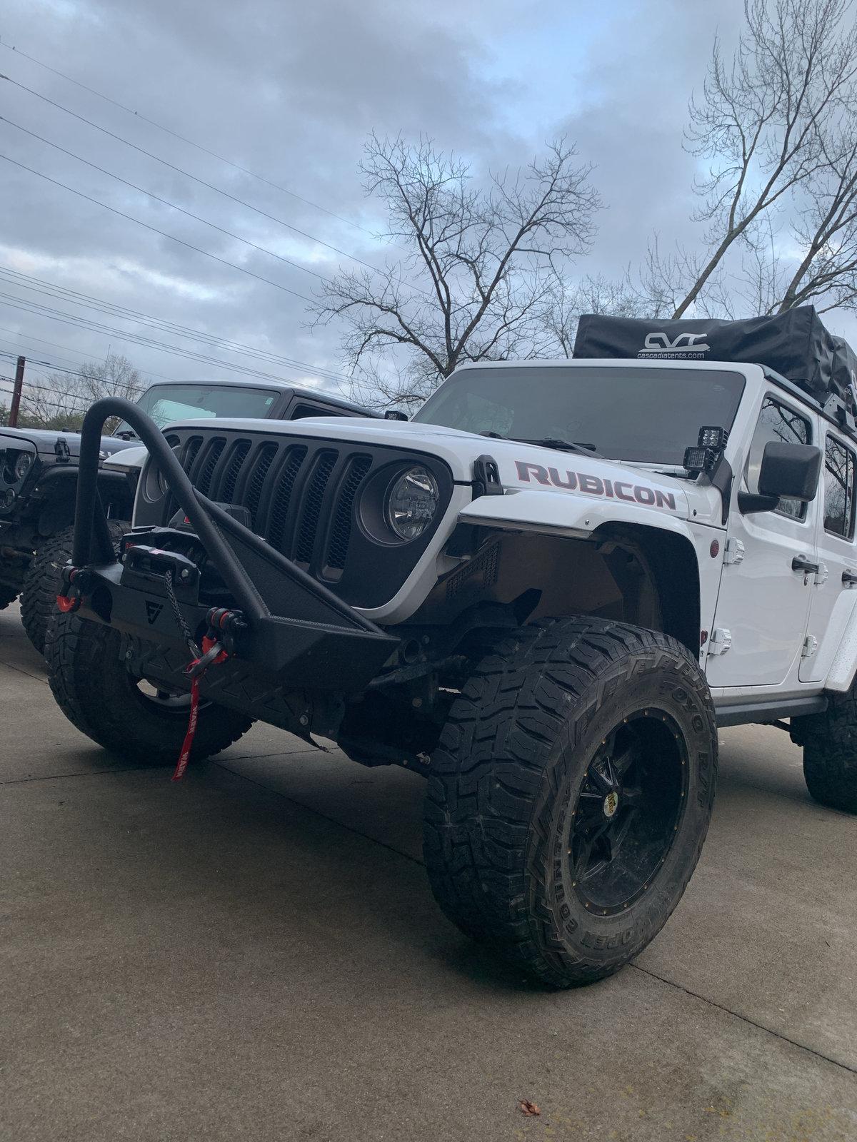

@SilverRubi this is the American Adventure Labs inner delete with 35s and a 2.5 inch lift. I’m about to do 38s this weekend.
Jeep Wrangler JL Inner Fender Removal 495C4A5D-2196-43A7-9632-B9D32FE1F15D
