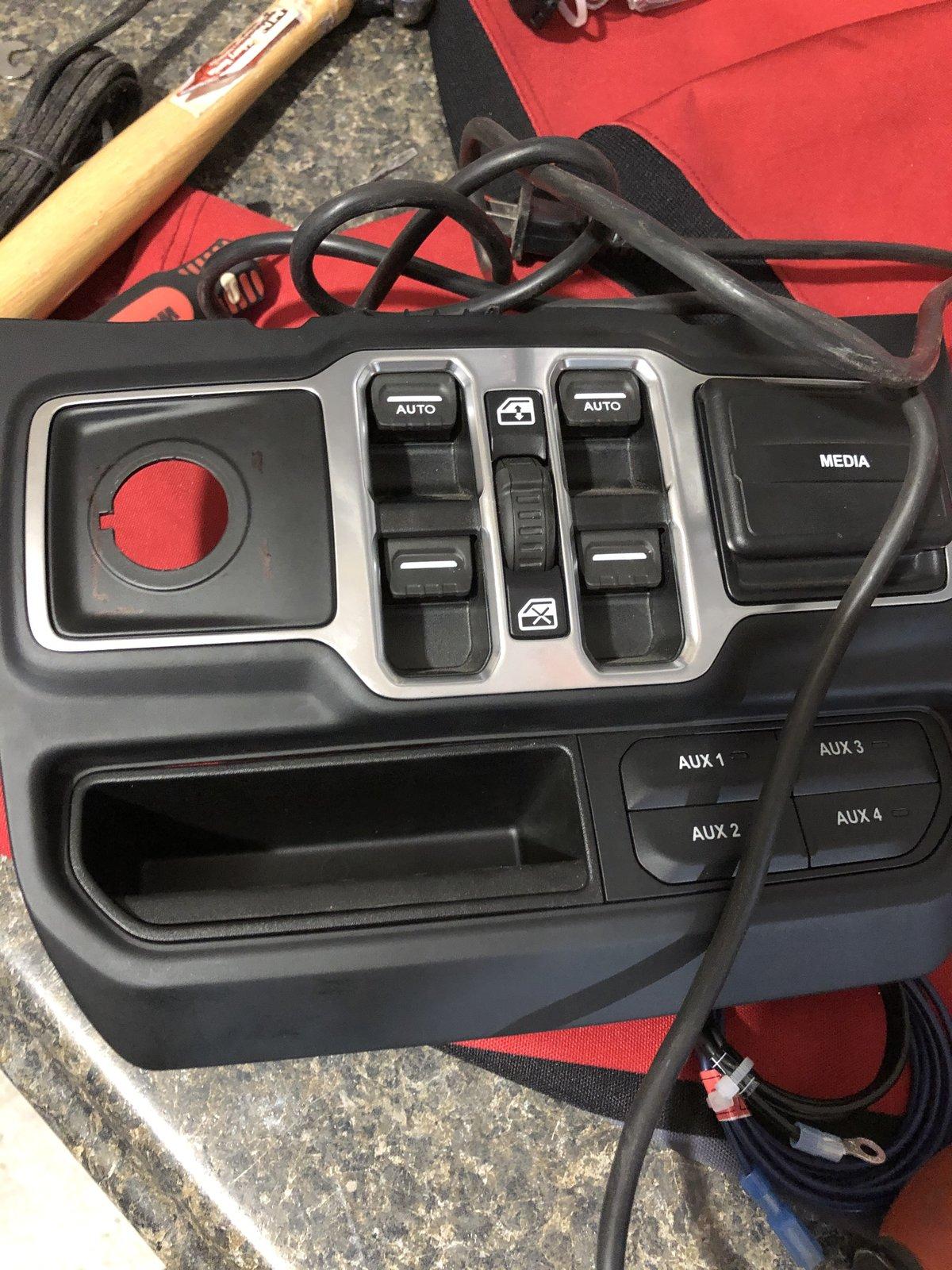

I used a pre-wired switch panel from 12volt guy And installed it in the cigarette lighter location. I wired the switch panel to the winch remote wires so I have the option of using the remote or the switch. I ran the wiring from the winch up the drivers side engine bay through a grommet
panel with lighter removed

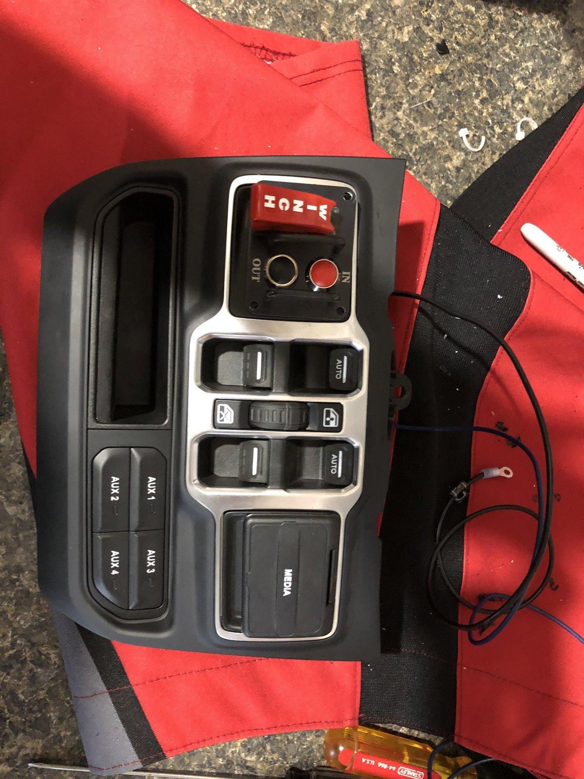

Adding switch panel to the accessory panel (don’t mind the old breezer covers)

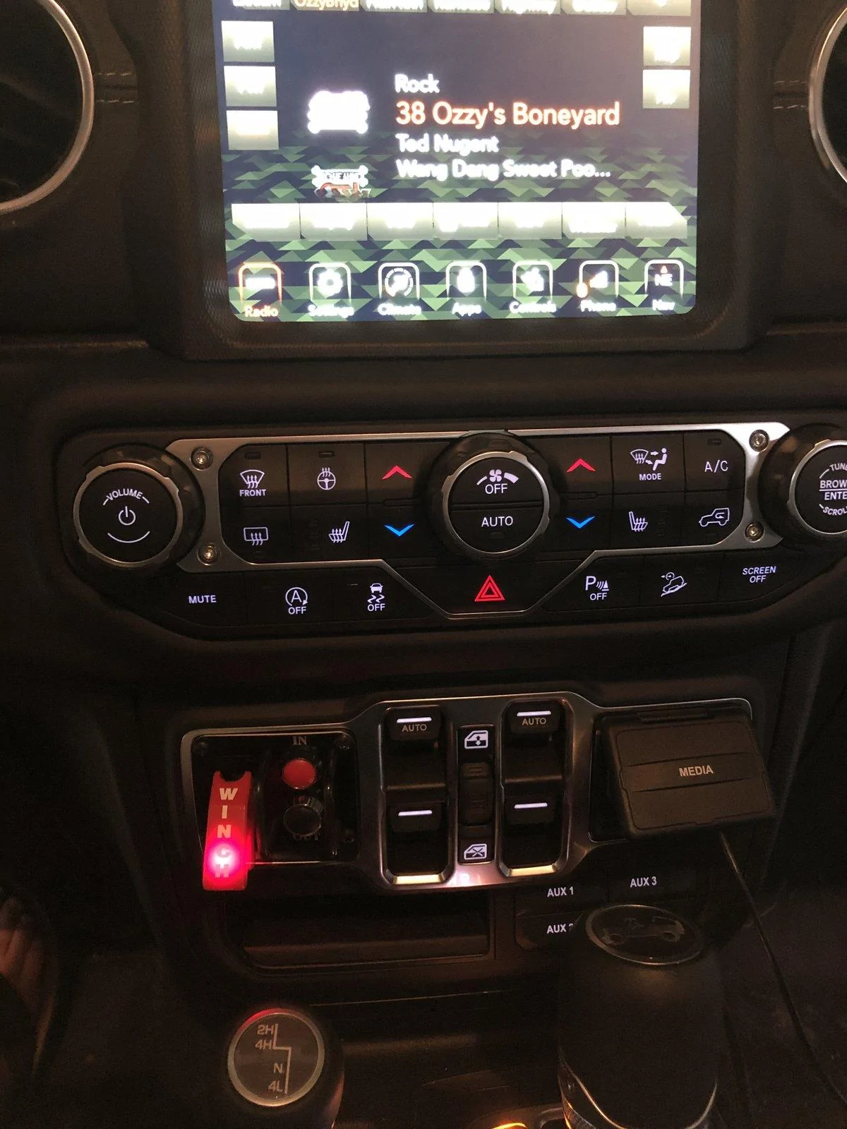

Final installed version
Jeep Wrangler JL In cab winch controls 1594953225022
Will I use this often? Absolutely not. But I haven’t used the cigarette lighter since I bought the Jeep. I wheel with good buddies and we pull winch lines for each other so it should work out well for my needs, should they arise. And it’s much more convenient than getting out in the mud or snow to hook up a remote.

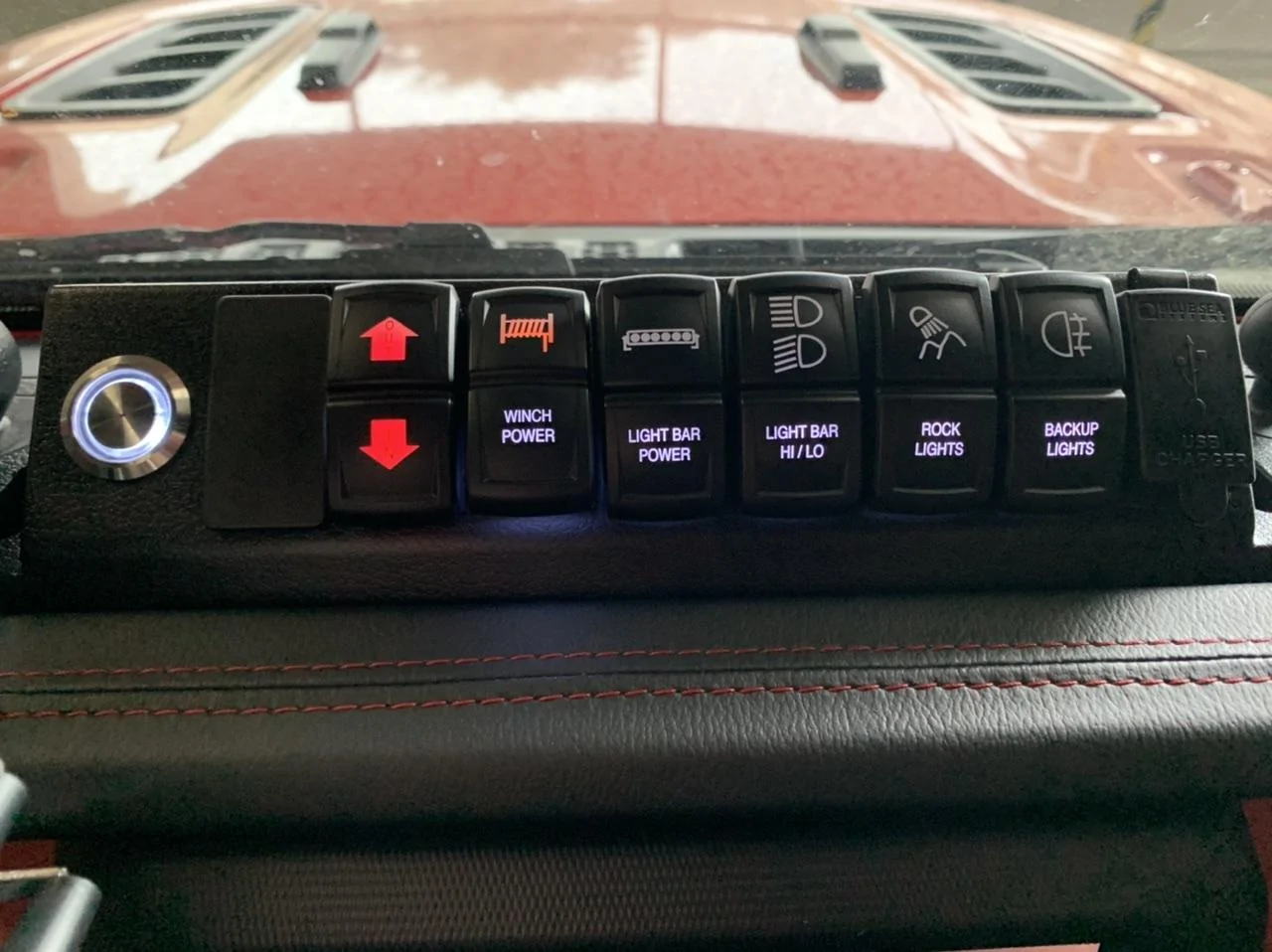

For me, it’s twofold. First, I’m not a big fan of wireless remotes, especially for something like a winch where a dead remote battery or poor wireless connection could lead to a non-functioning and/or unreliable winch in what is likely an already precarious situation. Second, in-cab controls look clean and are just always there and ready. No digging the wired remote out of a storage cubby to hook it up, no wires running through a partially opened window, no control cable draped along the side of the Jeep rubbing on the paint. It’s by no means necessary, but when factoring in the other reasons you already mentioned, it was worth the time and effort for me.
My setup:
Jeep Wrangler JL In cab winch controls 9C8ABEE3-5717-41DB-8337-A75FB775C0A0
