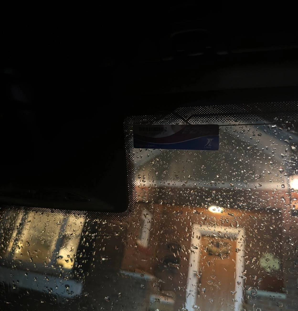

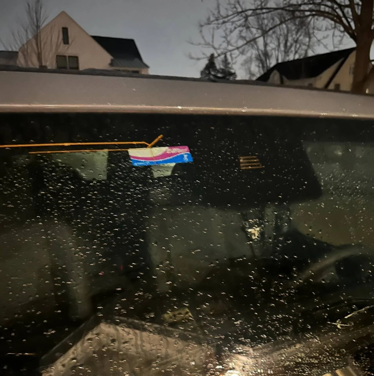

I received a new IPass (toll transponder, EZPass affiliate) sticker recently, they do the RFID sticker rather than a transponder. I applied it kinda sorta as instructed, but then got the nasty gram saying that the system wasn’t picking it up, they were tolling me via license plate and I needed to order a new sticker and mount it better.
Not sure where to put it. They said “behind the rear view mirror” but also more than 2-3” from windshield rail and 6” from any electronics. Thats basically in the center of my windshield lol.
Where do you guys put these things, especially with the radar cruise?
Current location (sorry it’s a dark rainy night)

You put the sticker right over the in-windshield radio antennae (The yellow line you see). That's probably why it isn't working. You need to put it down lower on the windshield.

If I switch to the driver’s side and put it up as high as possible in the blacked out section, would that work better do you think?

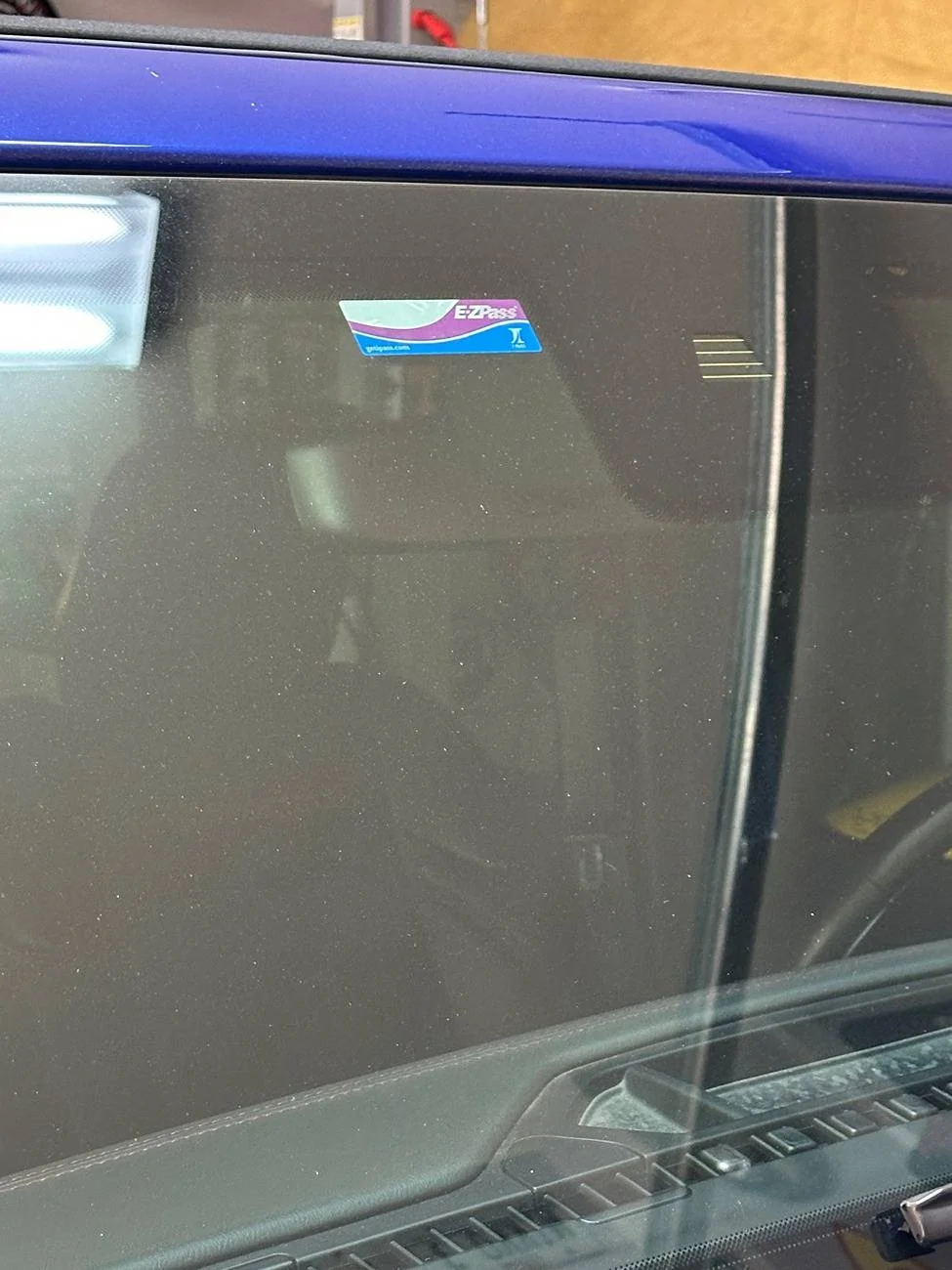

I think mine is in the same spot, but I don't have the window antenna being a 2020. No problems outside of how horrible it looks. What a shit state ....

The instructions specifically state to keep it something like 3" away from anything else, so don't put it at the very top of your windshield.

Not very helpful for the OP that has the antenna in the windshield and the adaptive cruise box.
The issue is there's not much room to avoid these items. The windshield itself is not that big.

Exactly. If I followed all of the directions it would be in basically the center of the windshield. So trying to figure out what works best.

The instructions also say to put it in the black sections on the windshield, which conflict with the “not within 3” of other items” guidance.
