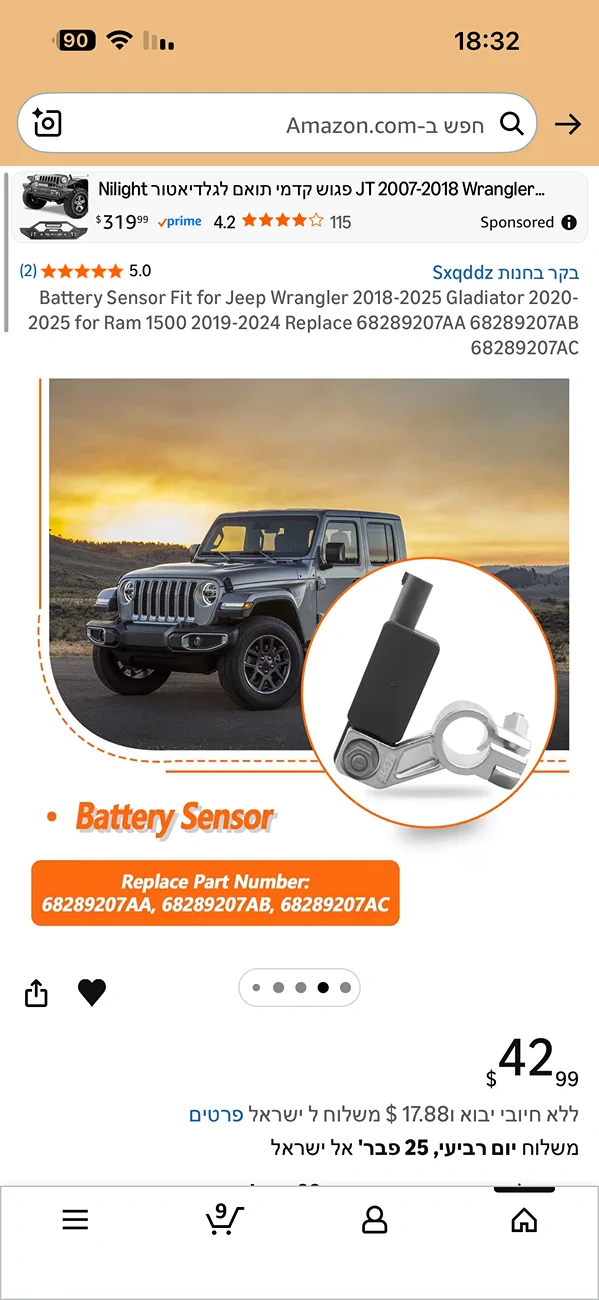

I think its ibs sensor , and i cant find the oem part , so i’am thinking about ordering aftermarket from amazon , can it work properly ? Any thoughts about it all
(oem price almost 400$with delivery , amazon for aftermarket 42$ )

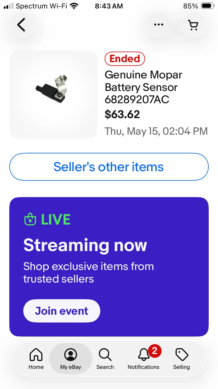

I got an OEM off eBay.
mine got damaged. Not sure that’s your problem, and it will cost you 60 bucks to find out.
I’ll search there , ebay take 1 month to get the order , amazon 3 weeks max 😅 , thanks a lot 🌹

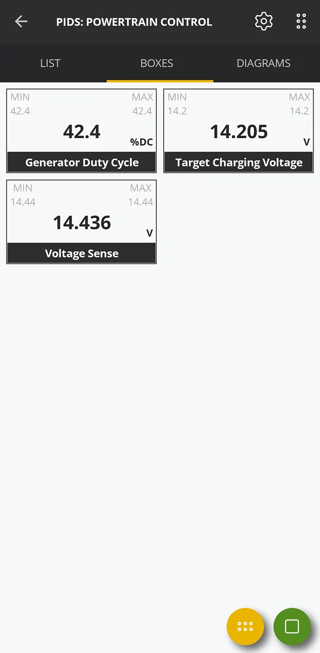

Thanks for the replay , my scan show voltage 14.3 when idle , do you mean to put the wires for the test , on the block of the alternator and the negative of the batterie/chassi ?

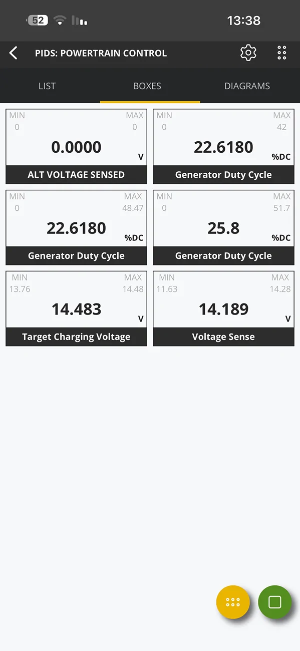

Alternator PIDS are in the POWERTRAIN CONTROL module (demo values shown):
I dont have this in my app , how come 🥲🫠

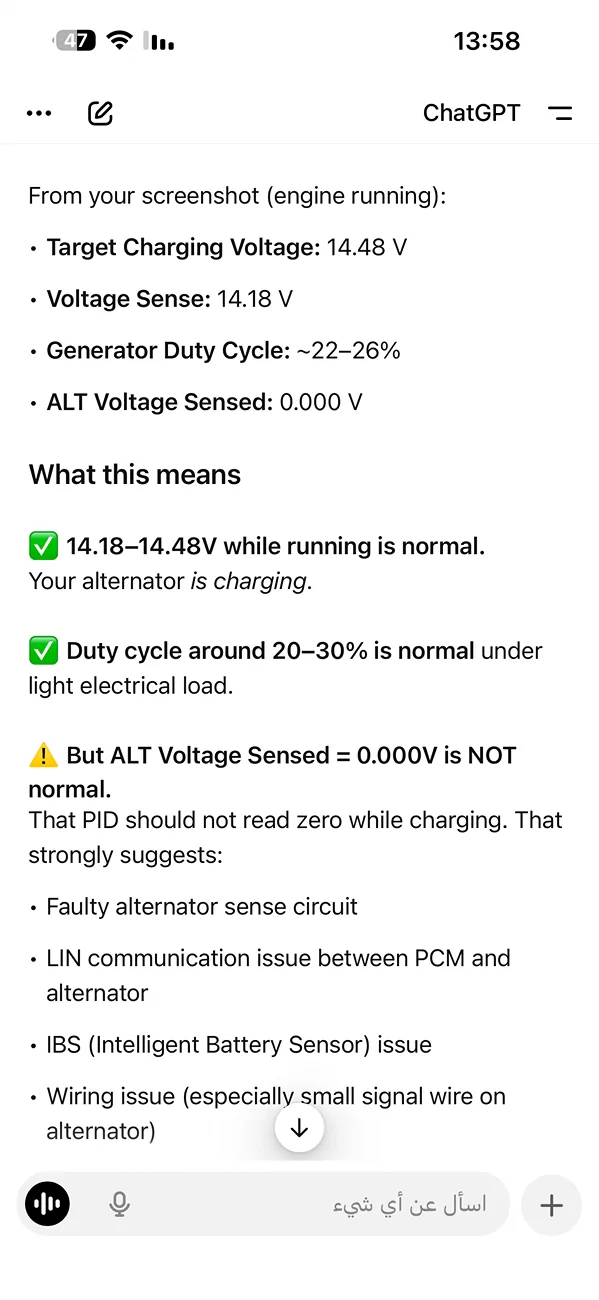

i done the test , when was accelerating the light came on , didnt have any changes in numbers on the app screen , i asked chpt and this is what he answered between all the things that he mentioned , what you think ?
