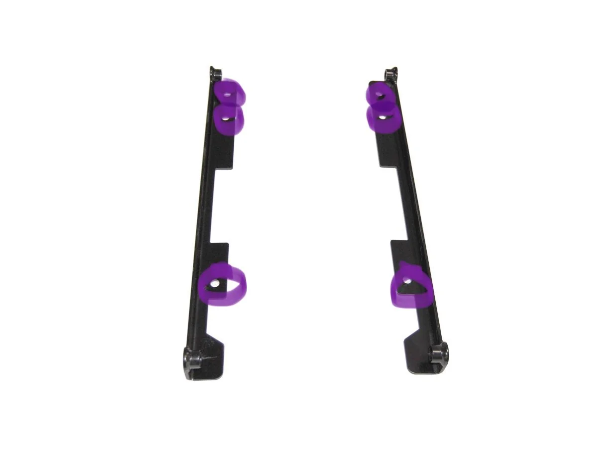

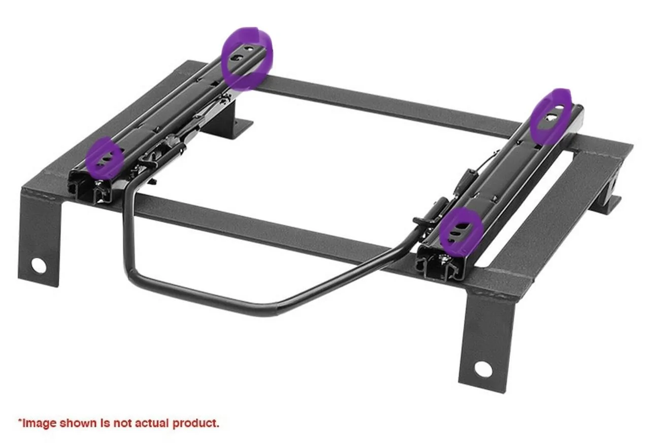

So after doing a little looking, I’m fairly sure I could use both Corbeau and PRP JK brackets to get them installed. That would make the brackets/sliders nearly $200 per side though.
if you look at where I marked, you could run a bolt through the holes and secure with a nut. The PRP brackets are designed to work with factory sliders so it’s the same concept. Which brings me to my next point, would the JK version work on the JL? I asked PRP but they wouldn’t tell me.

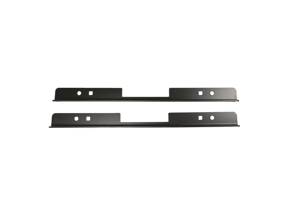

Just use PRP's universal angle mounts. As long as that slider is 14" W they should work fine, and worst case scenario - you'll just have to drill some holes in the mounts to line up with the bolt holes on that slider. It's also half the cost than the JK adapter..... PM me if you have any questions
