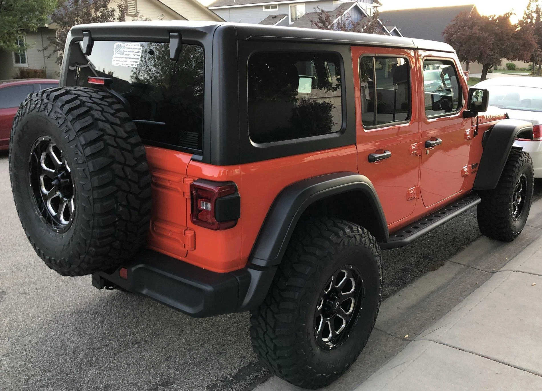

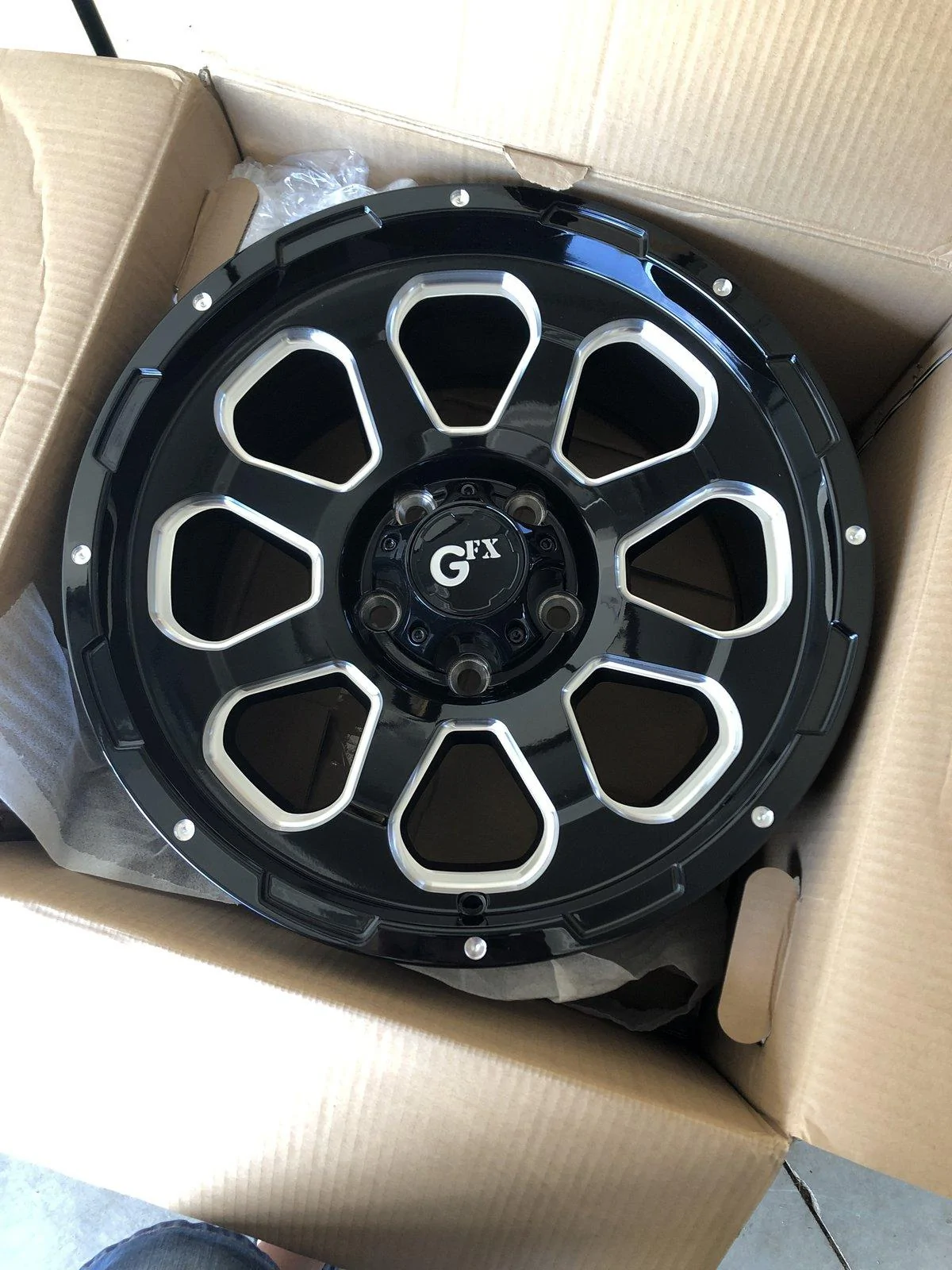

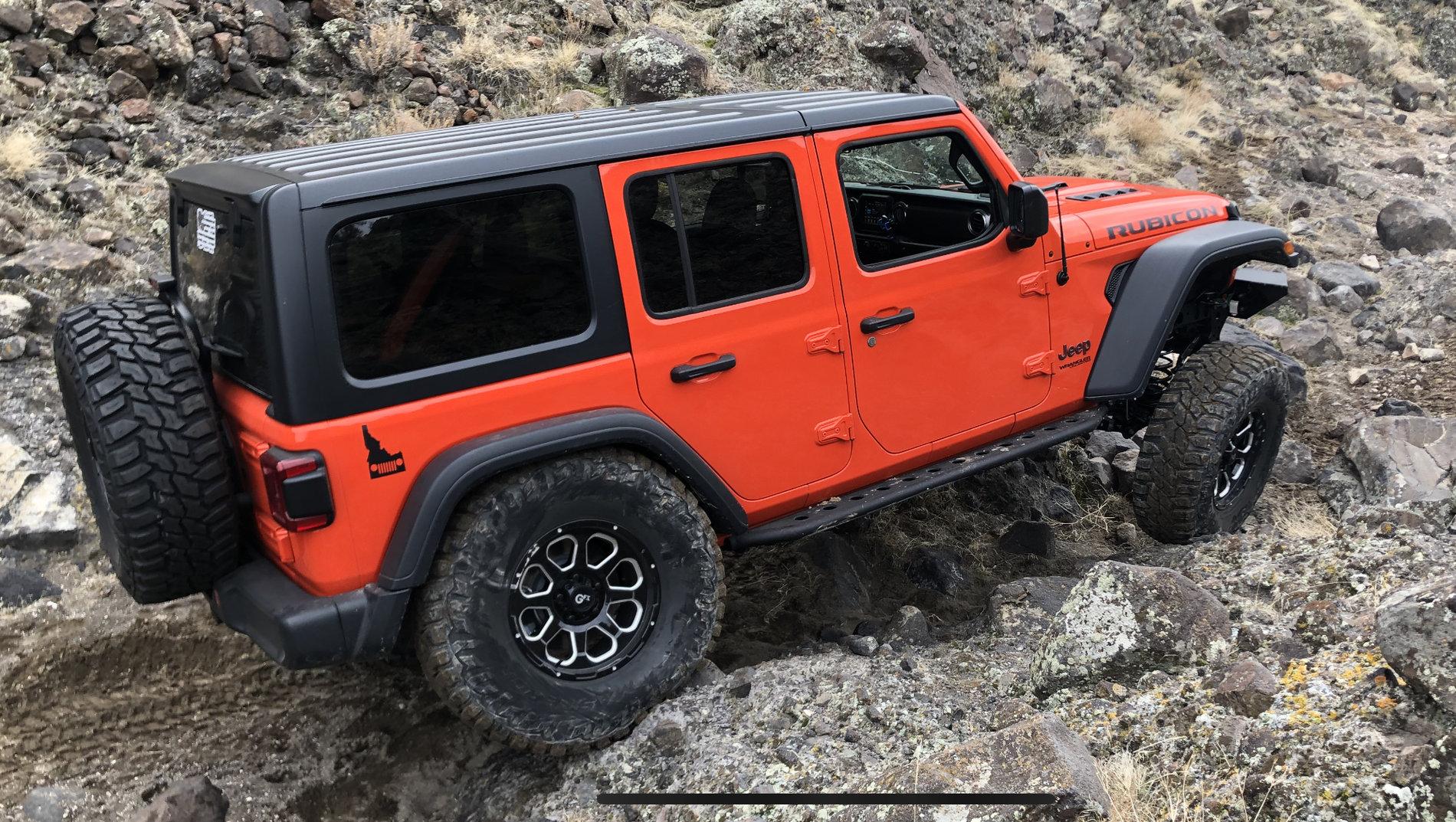

I have 17x9 +12 offset wheels with 37x12.5 on the mopar lift. I only rub the rear inner fenders a little bit under certain flexing conditions. Unless the LCA’s are shaped way different than stock a little bit of positive offset should work. My wheels are from discount as well. Don’t have any pics from straight behind. Sorry about that.
