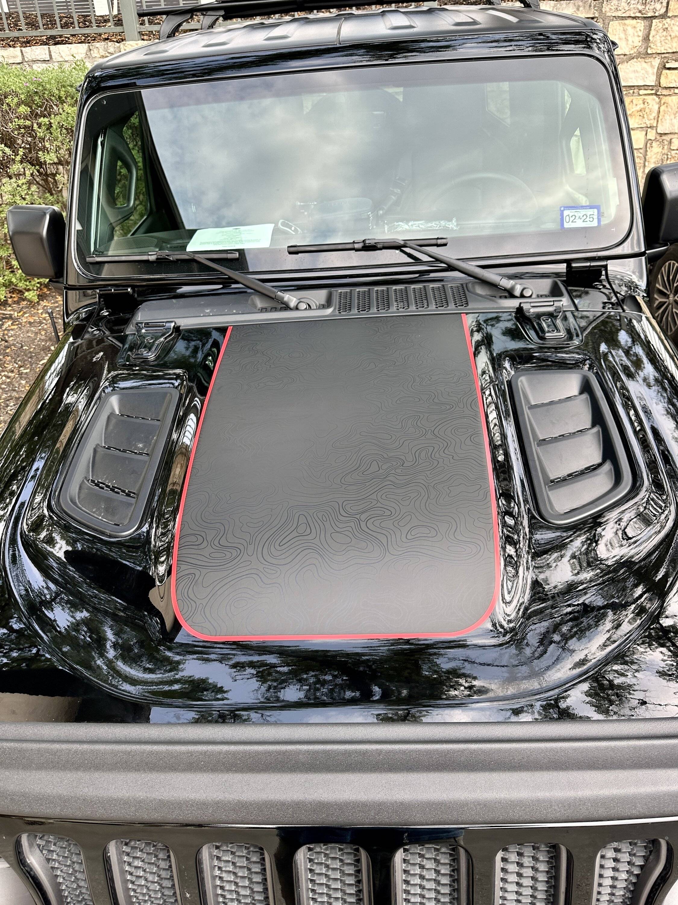

Thank you so much for your help. Here’s the end product (still have to reinstall the nozzles).
