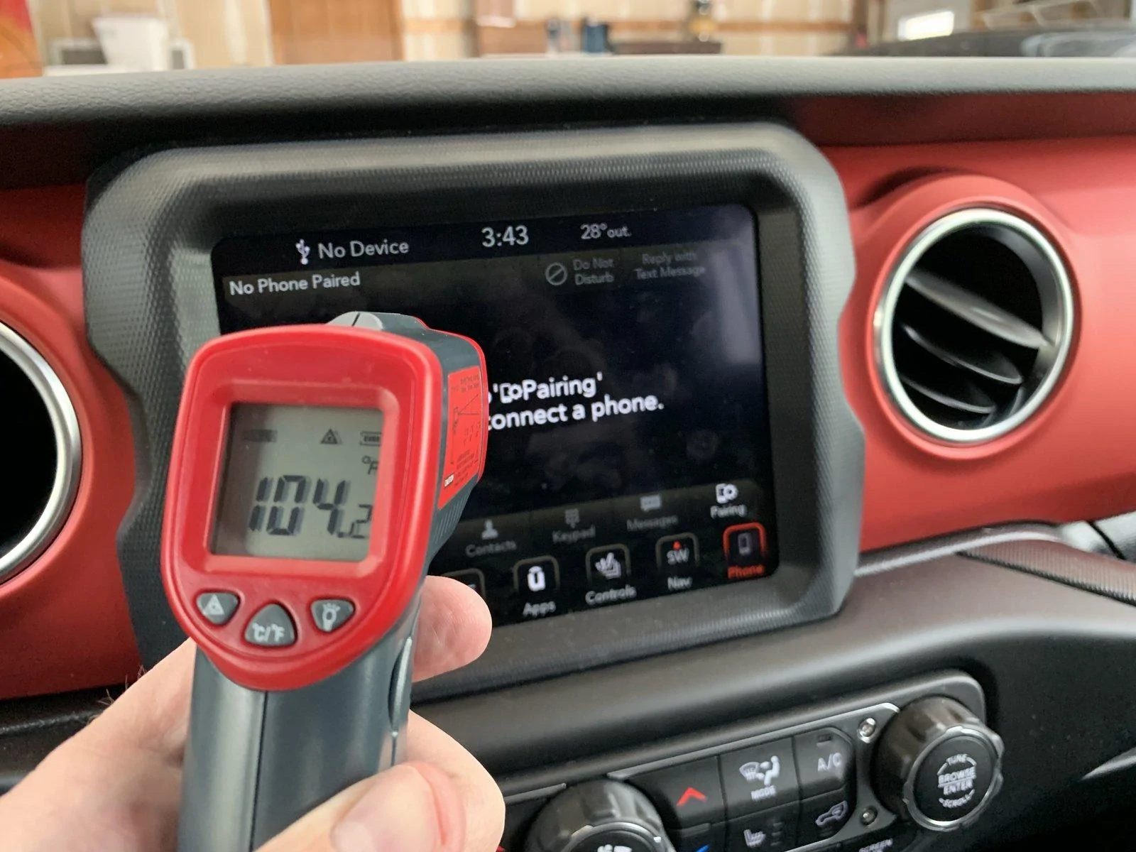

I love my Jeep, but something is definitely wrong. It was 28 degrees F outside. I wasn't running the heat in the jeep, and after 45 minutes of driving the Uconnect screen was 104.2 degrees F. That's insane!! I can tell that it gets even hotter when I drive for longer periods of time. Jeep has an issue here that needs to be fixed.

It doesn't get Hot 8.4

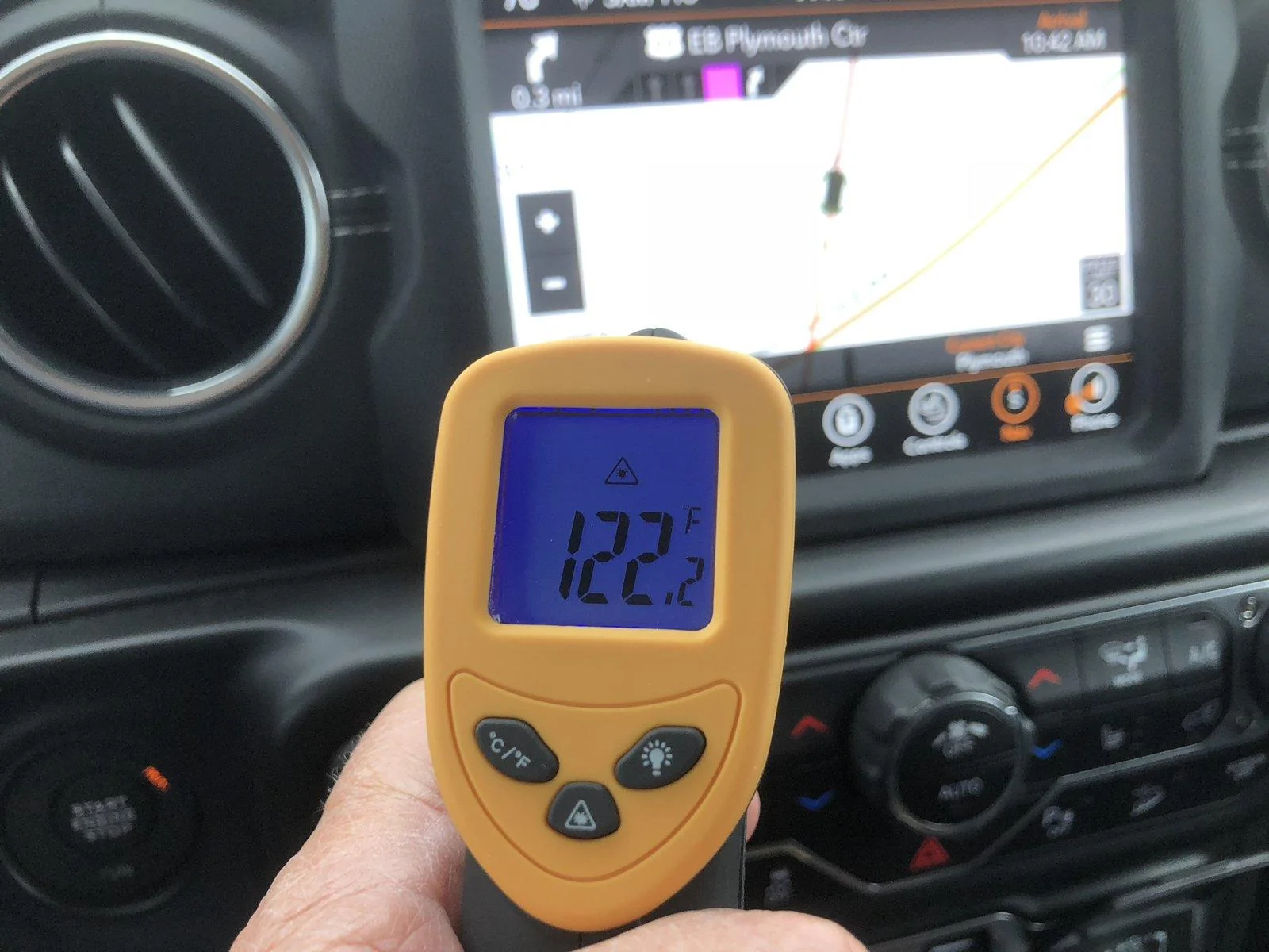

My Jeep is back! They had to replace a steering dampener. It drives like a different vehicle! As for the screen, I’ve not checked it yet, but before it was replaced temps were going into the 120’s...
Glad that it drives better Seansun01! Would be curious if the temperature issue is resolved. Mine is getting up that hot as well.
