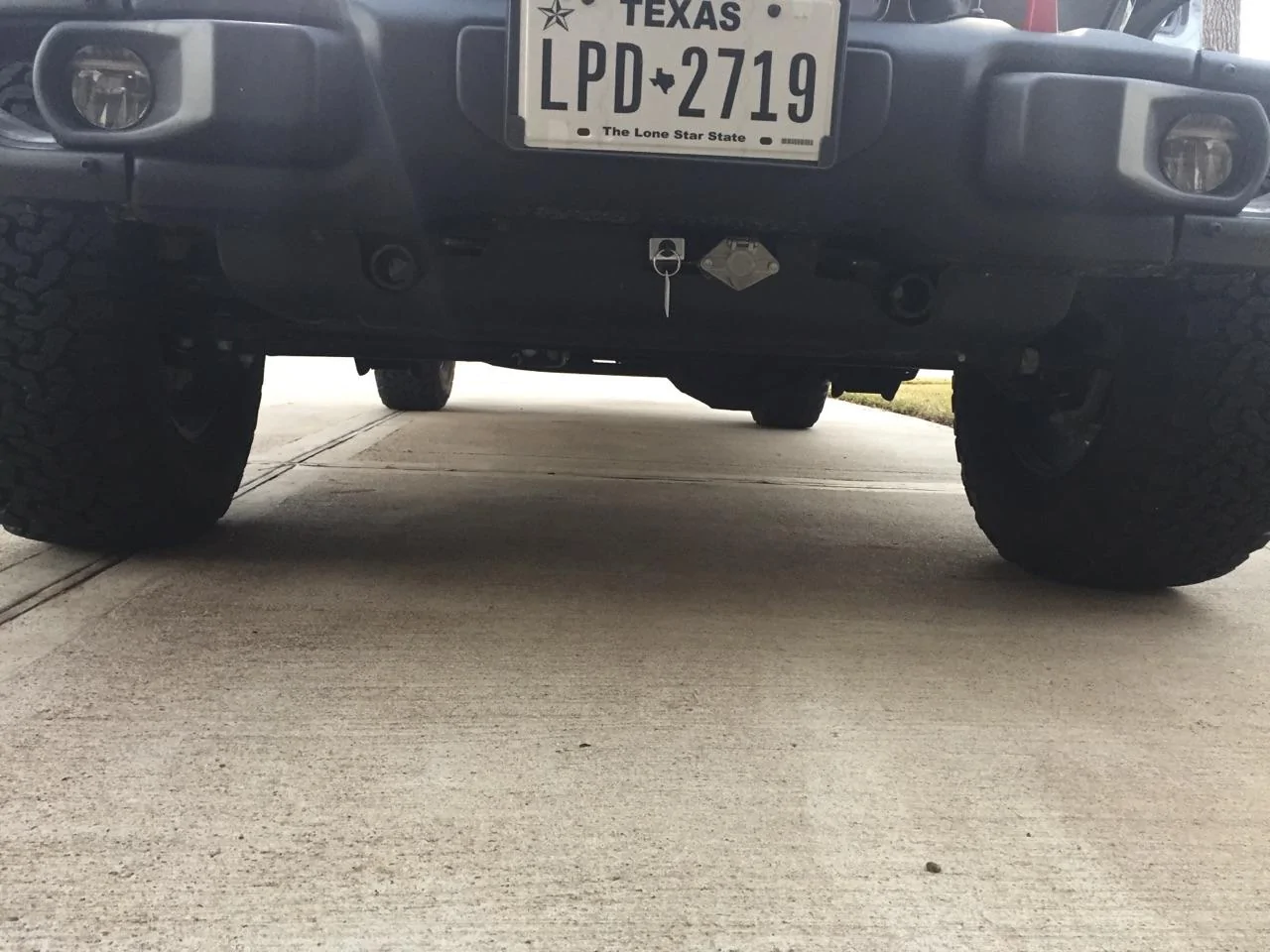

I flat tow my Jeep behind the coach. I have the roadmaster base plate installed - see pic. My wife and I go off road as much as possible. It's just the two of us, retired - so we're out there goofing off when everyone else is at work, we need a winch. My local installer says he can't put the smittybilt X20 in the front bumper as it needs to mount where the base plate is mounted.

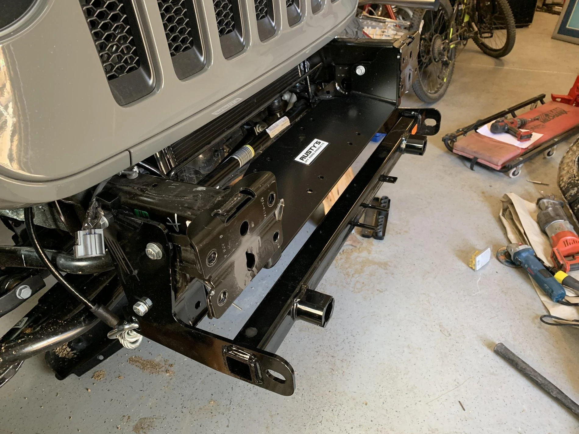

Thats the reason I installed a Blue Ox towing baseplate and a Rustys winch plate. I have a stock steel bumper. Both Blue Ox and RoadMaster said that I couldn't add a winch and use their baseplate. Roadmaster was right, Blue Ox was wrong. Blue Ox baseplate is totally compatable, no mods needed at all.
These are the pics of my setup before I reinstalled the bumper. FWIW, Jimac on this site also has the same setup on his gorgeous Red Rubicon.
I guess this does not help you at this point since you already have the Roadmaster installed. Unless you sell it and put the Blue Ox on.
