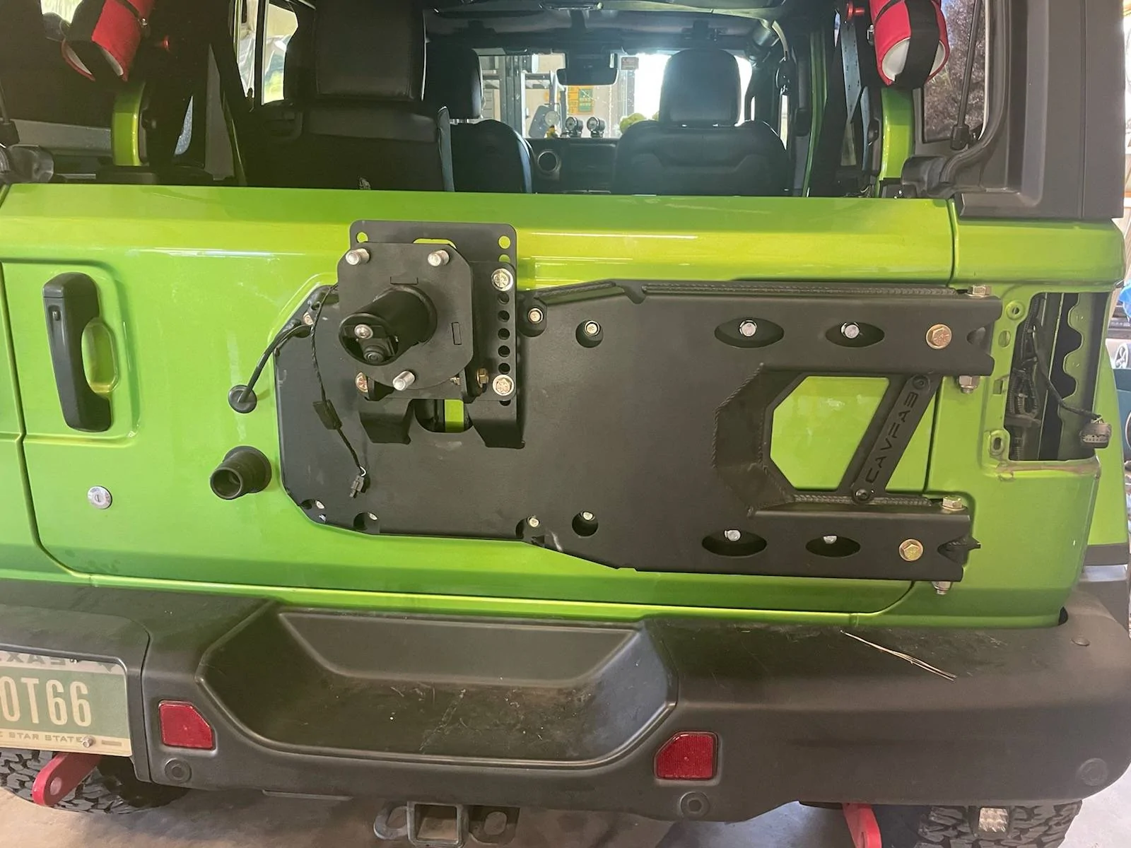

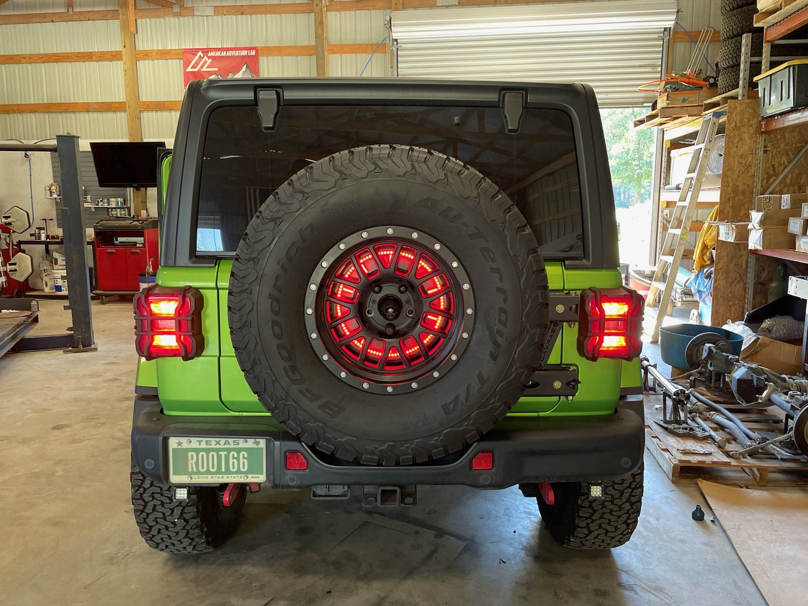

I had to remove it and replace it with a full teraflex hinge and tire carrier for my 37’s.

Meh...it would not stay tight over time and the tailgate would start to sag. The pressed in studs started pulling out of the relocation brackets too.
Obviously, driving environment (on-road vs. off-road) can cause this to happen more or less often with the Mopar.
For the cost of the Mopar tailgate reinforcement and tire relocation kit, you are well on the way of paying for a proper solution.

She doesn’t drive off road and the gate seems secure. I wish I had not ordered it from the factory. I did replace the tire carrier with the Teraflex unit first and after seeing a little bit of deflection in the tailgate ditched it for the Teraflex hinge.
