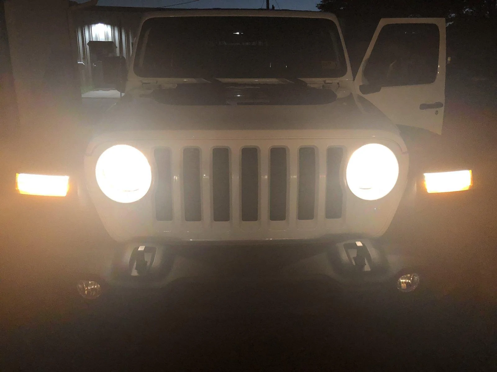

How much clearance did it give you over the original sport flares ?
It’s all 4. This is 35’s without lift. Waiting on a Tazer to program the LEDs to stop hyperflash and out warnings. But everything works. Super easy install.
Did you have any trouble lining the new high top flares up with the front and rear bumper? I can see the front looks good but can’t tell from the pic where the bumper meets the rear flare. ?
how much clearance did you get from original flare in the back and front ?
