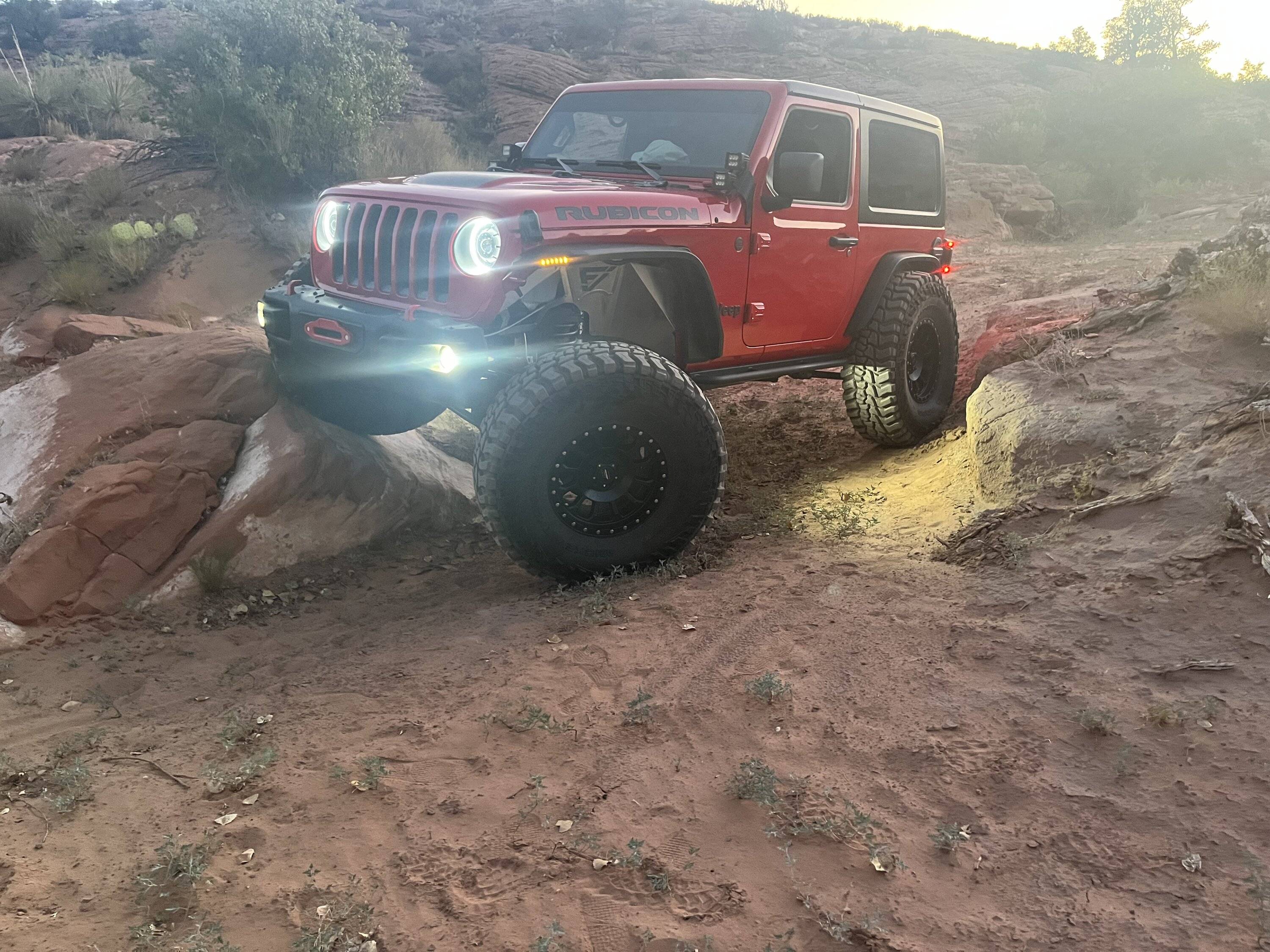

Threw on some forties and added appropriate bump stops to compensate. I still find that i occasionally rub tire on the pinch seam just behind the rear tires on a hard fast hit. Should i just trim the pinch seem? Add a stiffer jounce bumper? Is everyone on 40’s trimming the pinch seam? I know its a tire questions but with it only being the rear pinch seam i thought it may be more of a wheel base specific question

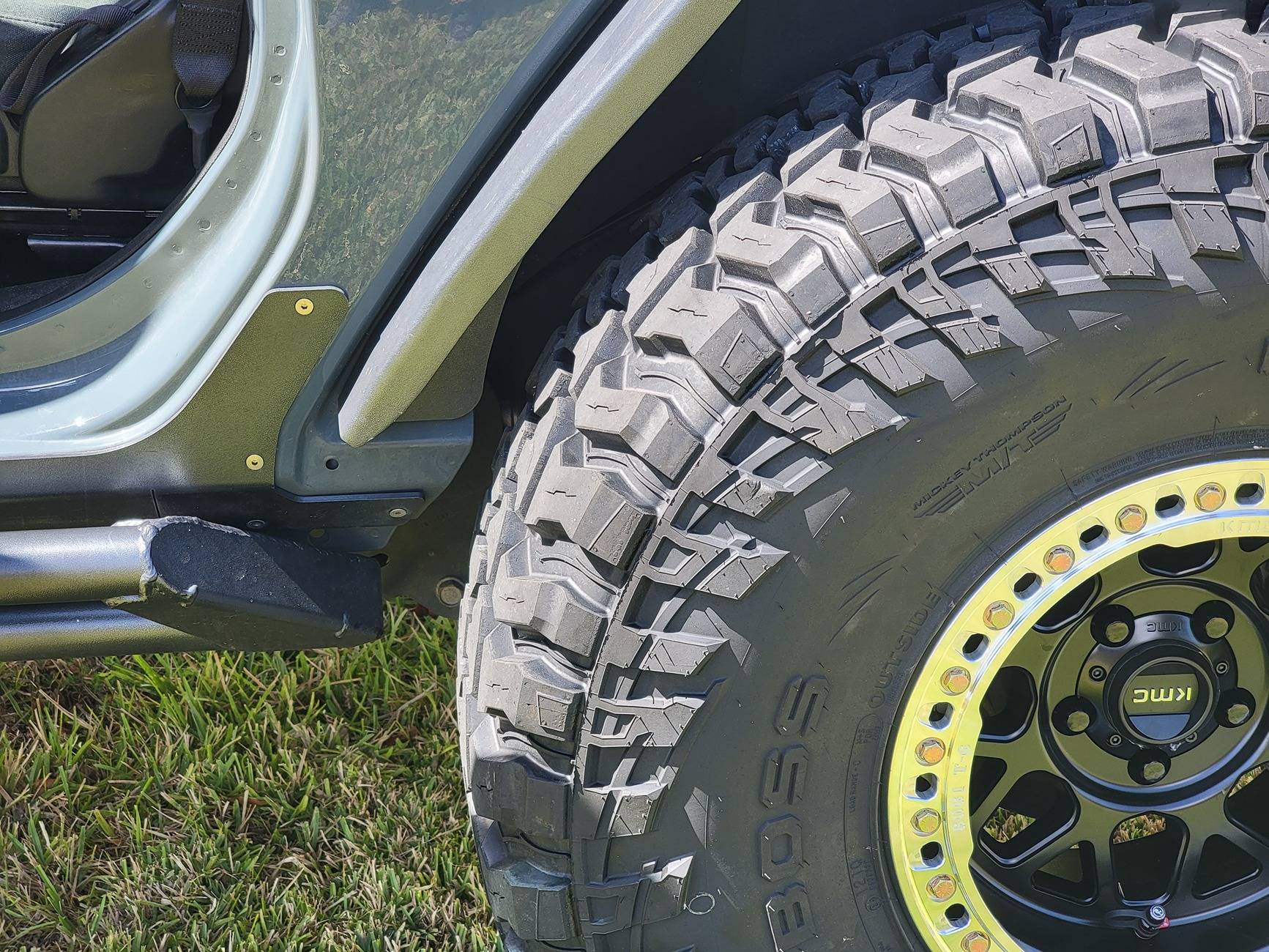

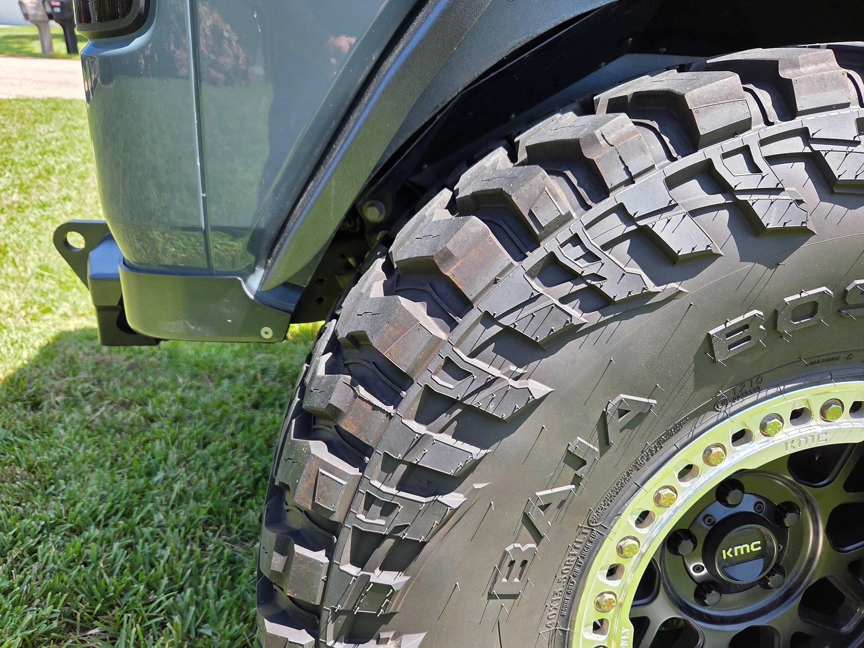

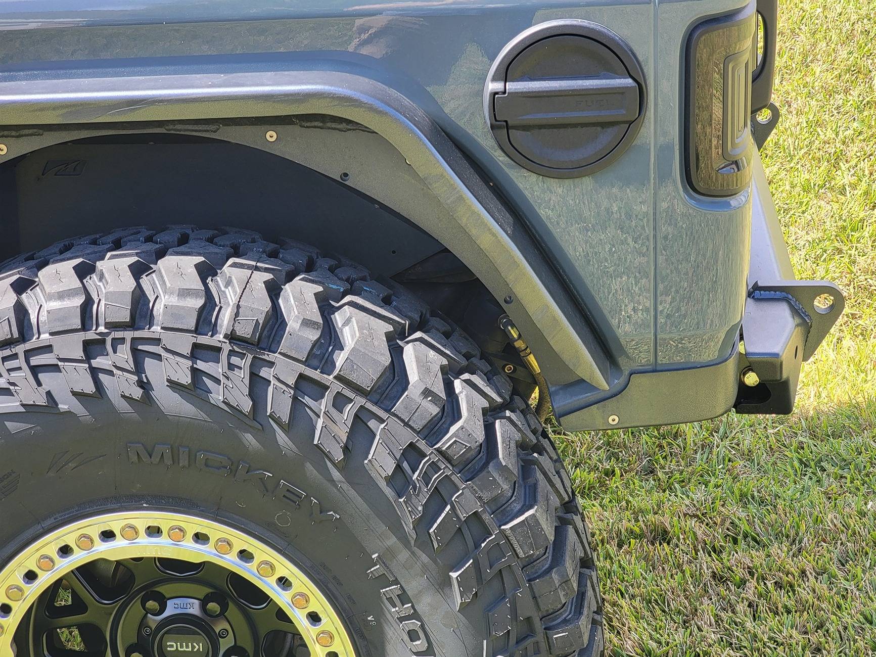

Trimming is the way to go. I am in the process of trimming mine now. Rather trim than have to add bump stop to limit travel. I also adjusted the axle back 3/4 of an inch to keep it out of the front pinch seam.
GreenWilly
Tony
May 19, 2022
161
532
22 JLU Willy's, 2024 JLR
Before and after pics. Still room for more articulation but you get the point.
