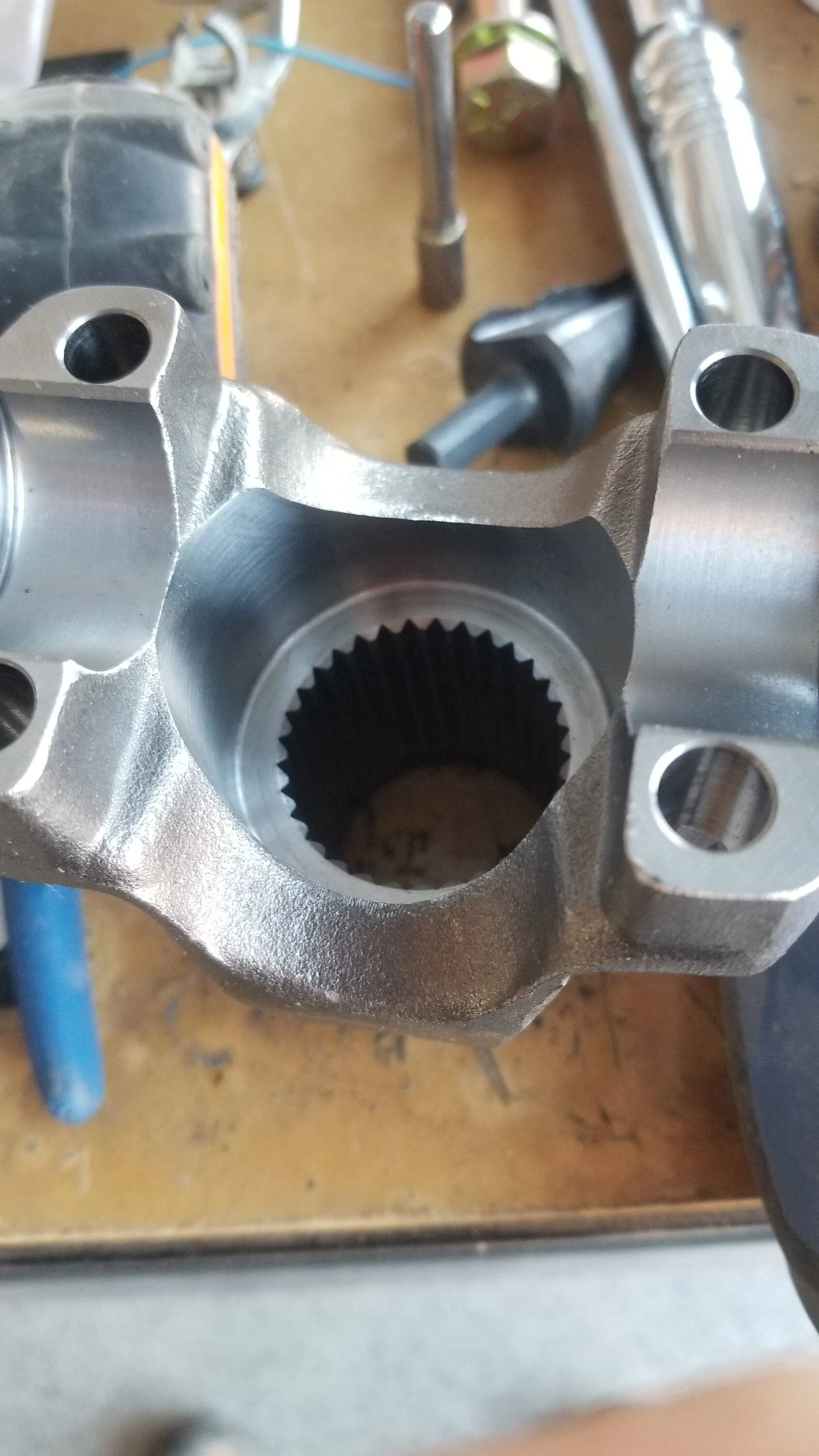

Help.. Instructions are wrong.. Rubber I ring from stock drive shaft cannot go into new yoke.
Instructions say it should...
We are just going to assemble without rubber ring as yoke has no slot for it..
Anyone know what's up?

You don't need the ring. Just coat the bottom of the nut with a thin film of RTV and install.

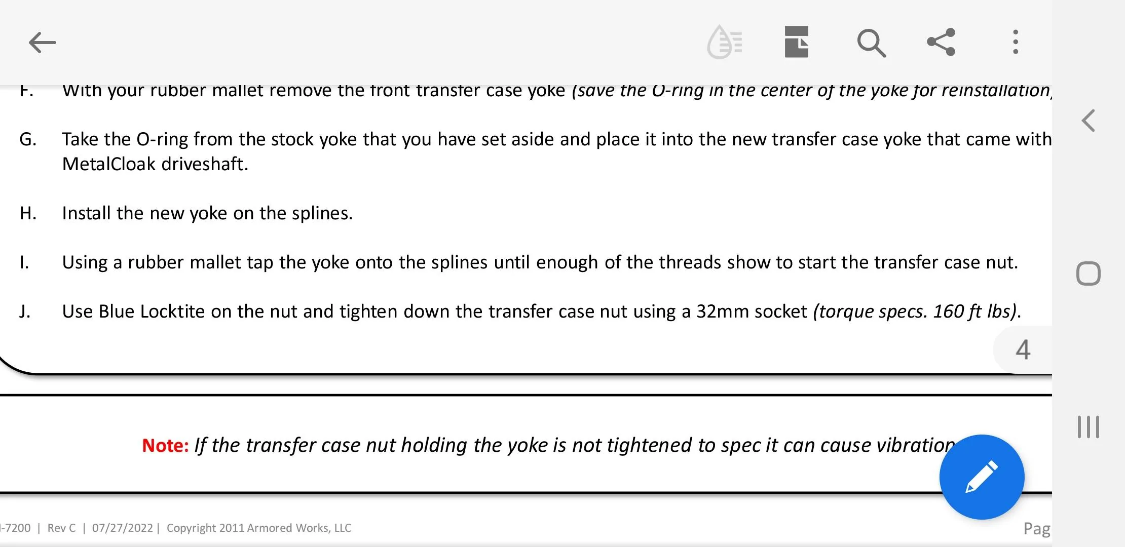

Hmmm, just followed the instructions exactly as written by metalcloak..
Item J says transfer case nut to 160ftlb..
