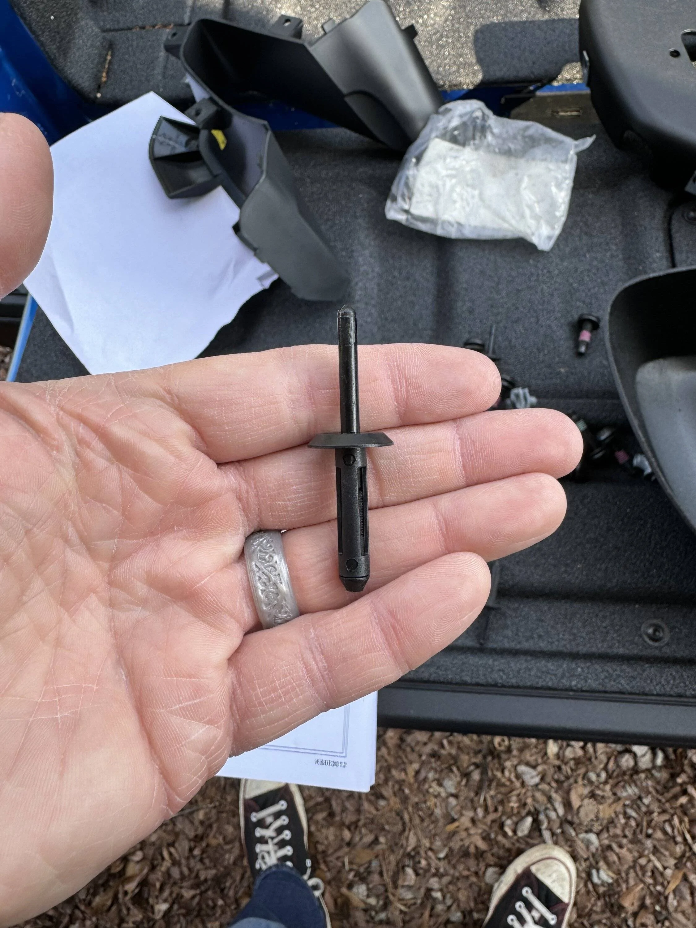

So I bought a stubby steel rubicon bumper to put on my wife’s gladiator, and decided to also get a set of end caps to put on.
Problem is the end caps came in three pieces that I need to assemble. No problem, except there’s one part that I don’t understand how to install and mopar’s instructions are of course completely unhelpful. Hoping someone here can point me in the right direction.
It looks like I need a specific tool to do it but I can’t find anything on Google to help me.

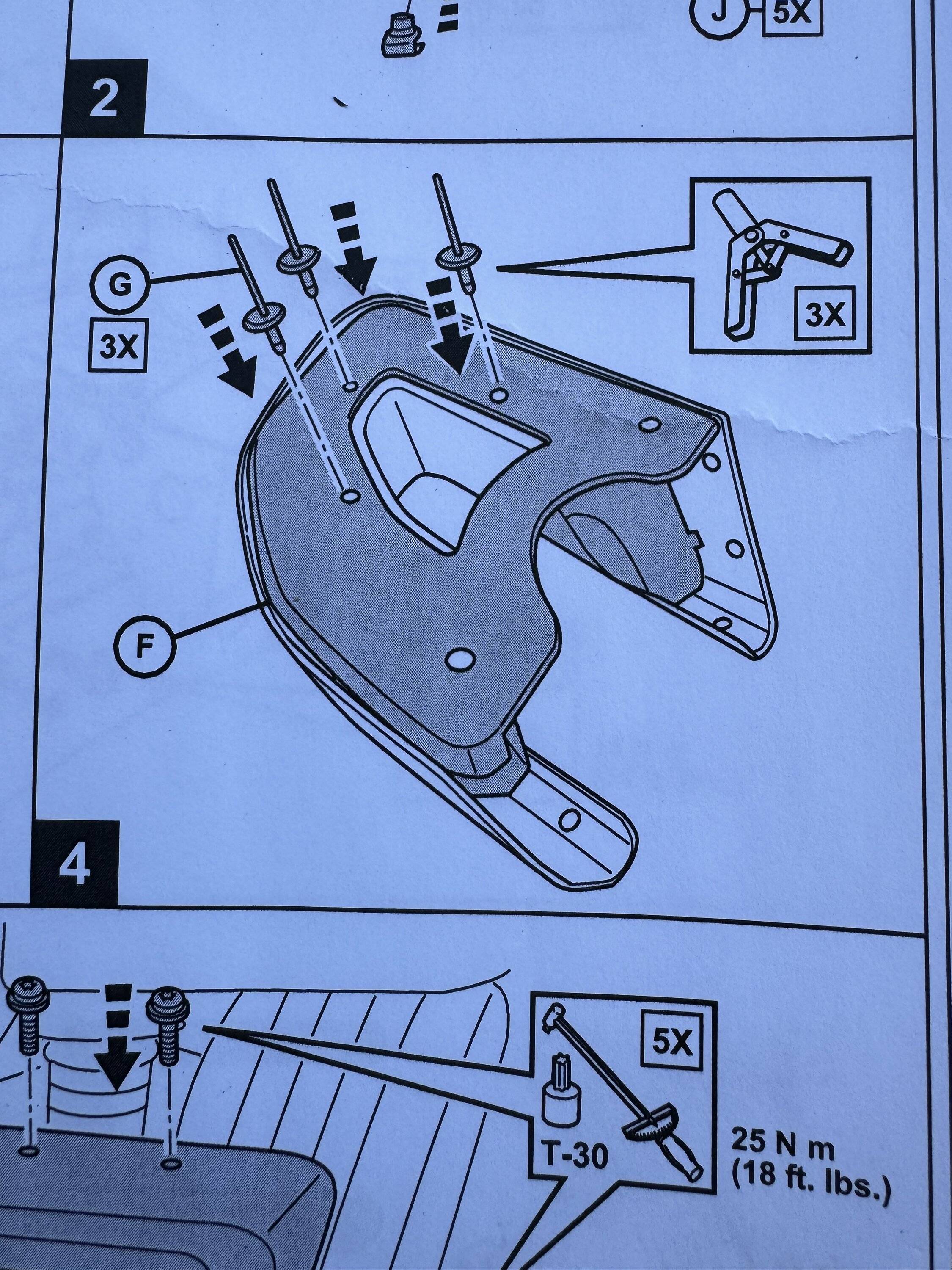

You need a "plastic rivet gun" available at Harbor Freight.
Pic of it in the inset labeled "3X" upper right corner of your second pic.
