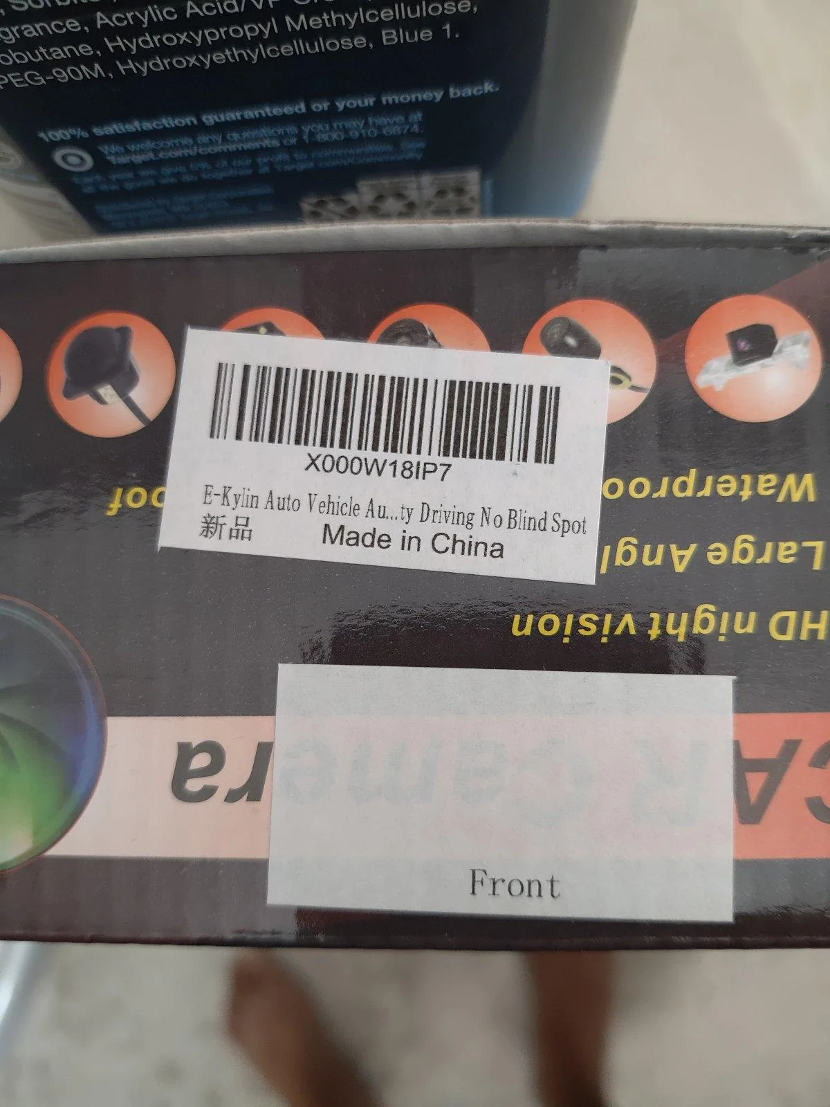

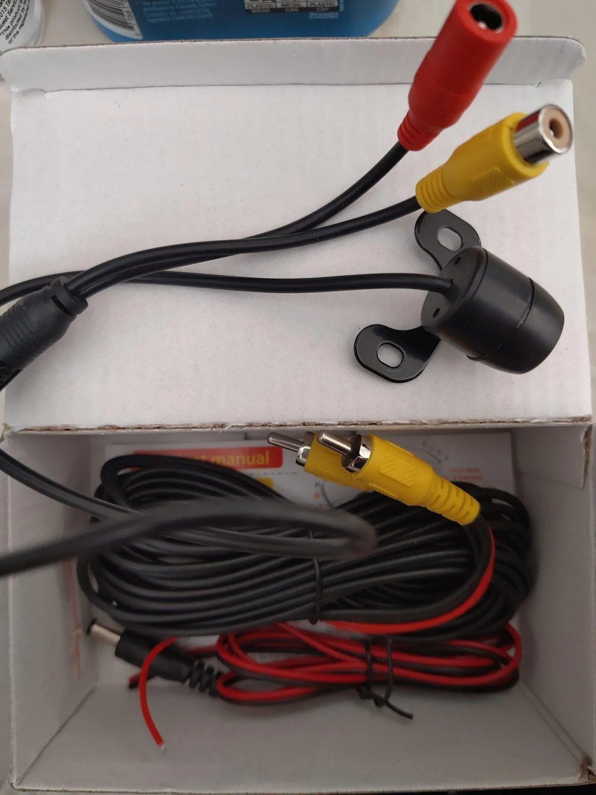

Hi and Dear Everybody. I’m installing Heigh10 on my 2014JKU 2.8 CRD with matching rear view camera. My choice for front view camera, an E-KYLIN AUTO VEHICLE AUTOMOTIVE CAR FRONT VIEW CAMERA FORWARD CAM WITH NO GRID LINES NON MIRROR IMAGE (LYSB017GC4GTA), unfortunately is unavailable right now. Any suggestion from the group of a next best match camera for my new set? Help is earnestly solicited and appreciated. Thanks.
