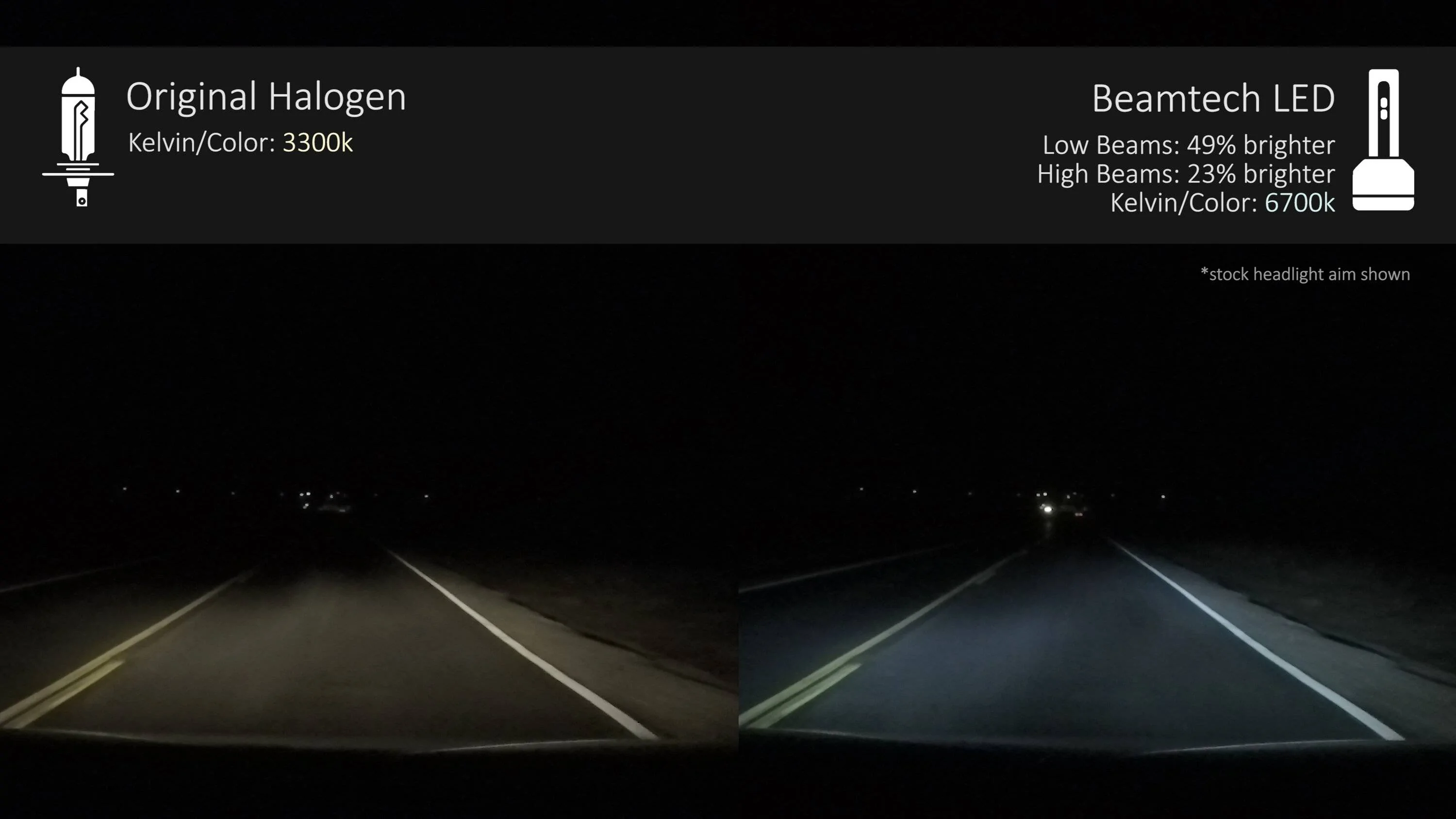

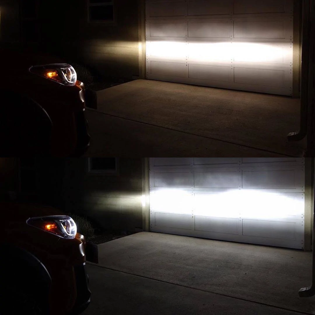

So here's a great example to use. I've been looking all over for an example of what i'm talking about with cheap bulbs and it's difficult to find. I always tell prospective buyers - LOOK FOR A BEAM PATTERN SHOT. If the site you are buying from does not post a beam pattern shot that's because they don't want you to see it. Every time someone on this site raves about a $40-50 pair of bulbs I look them up, and of course there's no beam pattern shot on the site, but there's also never any third party reviews. This time I found one...there is a third party beam pattern shot of the Beamtech V4.
THIS is what i'm talking about:
Jeep Wrangler JL Headlights - 9" or 7" Beamtech-fanless
Ouch. That's WORSE than the stock halogens!
Not surprisingly, the projection is a disaster too:
Jeep Wrangler JL Headlights - 9" or 7" driving-beamtech-led

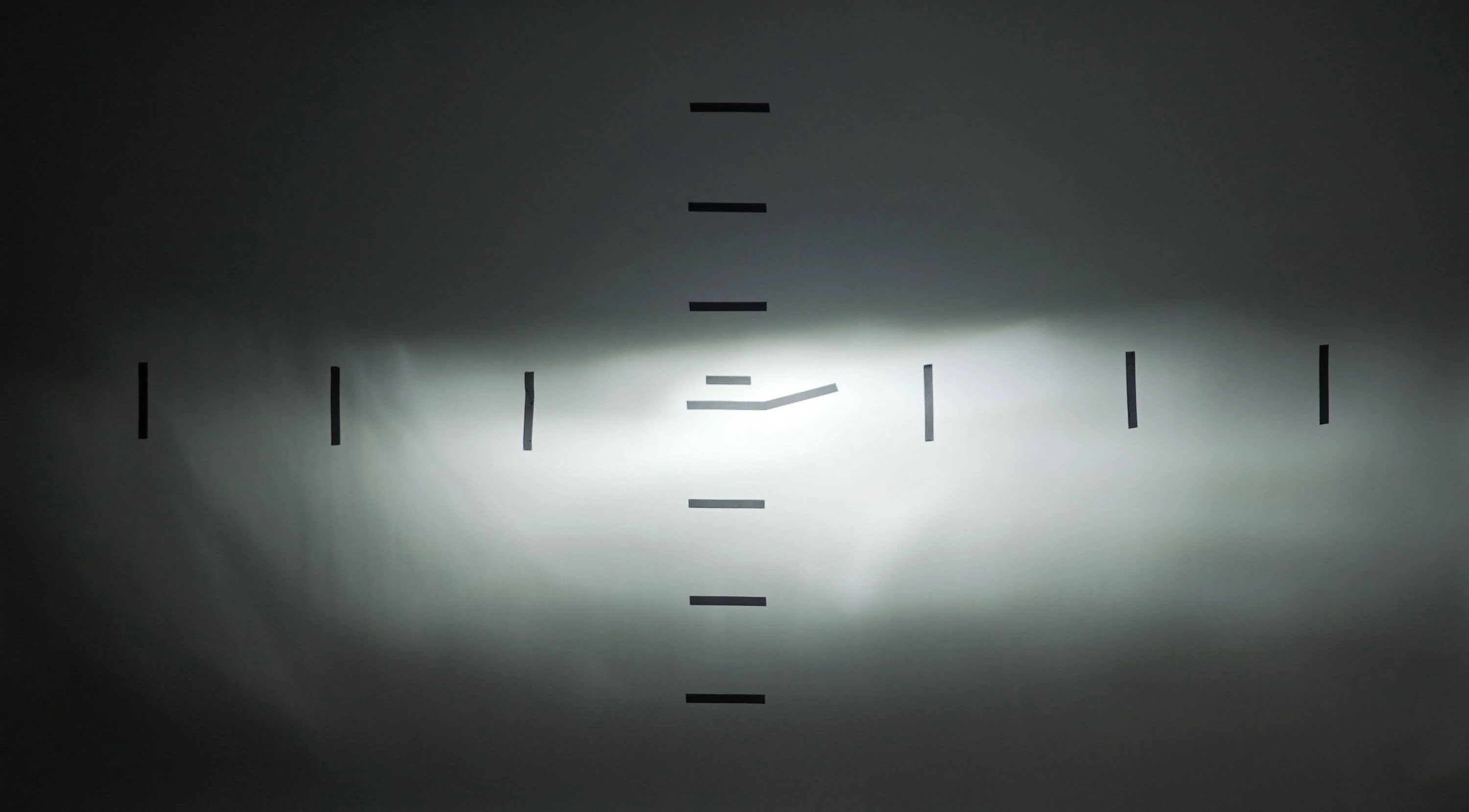

Now compare that to a GOOD LED bulb (this is the Diode Dynamics SL1):
Jeep Wrangler JL Headlights - 9" or 7" EFLlO4gW4AIeh_x
This isn't an advertisement for Diode Dynamics, by the way, you can get bulbs just as good cheaper (these are $200/pair), but it is an advertisement for quality bulbs.
