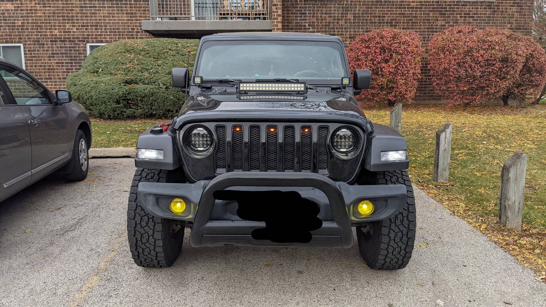

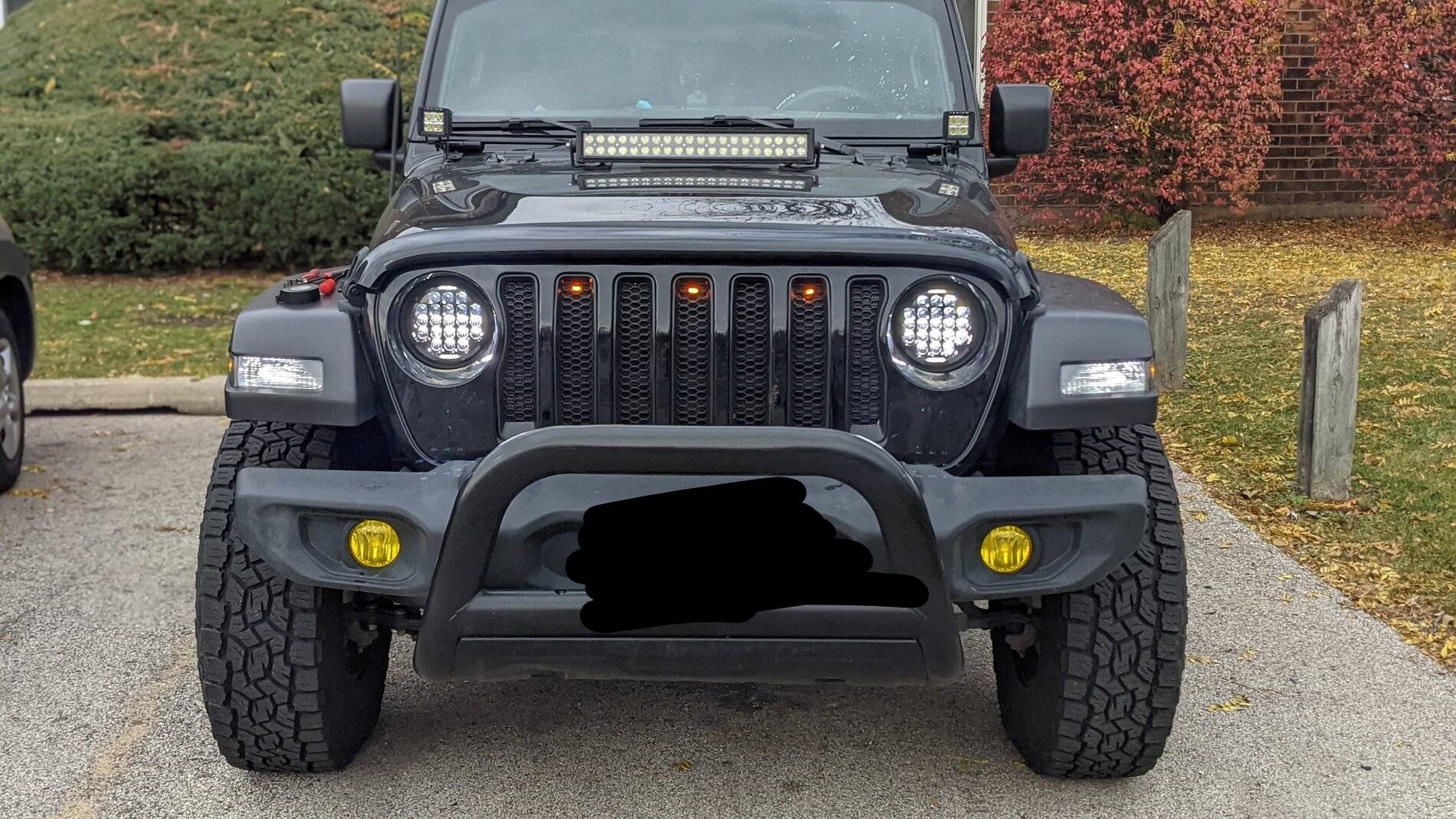

Grew tired of my halos and went with these because of how nicely they mesh with the light bar/cubes
Jeep Wrangler JL Headlight Upgrade PXL_20211120_170211663~2
Jeep Wrangler JL Headlight Upgrade PXL_20211120_170230868~2
Jeep Wrangler JL Headlight Upgrade PXL_20211120_170306907.PORTRAIT~3
