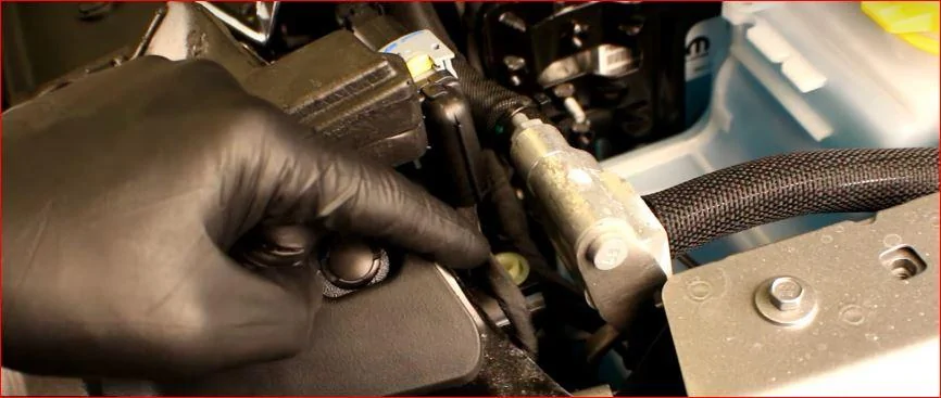

Just confirmed. Right = up Left = down
JL - LED & Halogen Headlight Adjustment:
Looking down at the adjuster's, you turn them clockwise (turn to the right) to go UP and counter clockwise (turn to the left) to go DOWN.
Jeep Wrangler JL Headlight adjustment adjuster
Thanks for the info. I figured it as much..

I did not hear it mentioned, but the following should also be in place before you do the adjustment:
  • Tire pressures need to be adjusted to what you run the tires with on the road
  • No large accumulations of mud, snow, sleet on the JL
  • Full tank of gas
  • No luggage, pay load in the back of the JL (leave in back what you always carry)
  • Should be adjusted with an average weight driver sitting in the driver's seat. No passenger's
  • After parking at 25' distance back from the wall.... rock the JL, side to side, 3 or 4 times to allow suspension to settle
To adjust:
When you adjust, have your headlamps on LOW beam, not bright beam.
-Do know that your fog lights also can also be adjusted as needed. Each fog light has an adjuster.

@RogueKJ
Don't know how if the parts have changed or what but I just did this on my 18 JL Sport and it's actually clockwise to lower and counter-clockwise to raise.
That's what the video says too but everyone else here has said the opposite.

Lol so which way is correct I have to do mine when I get back in from work. It will be a few weeks before I do mine, but I’ll report back. 2018 jl rubicon.
Whichever way works? Just adjust and see what happens. You'll figure it out quickly when the ISS calls to complain about getting flashed.
I marked mine with painters tape on the garage door, so that I had a starting position. Then adjusted as needed from there, very easy to see which way it is adjusting on the door.
