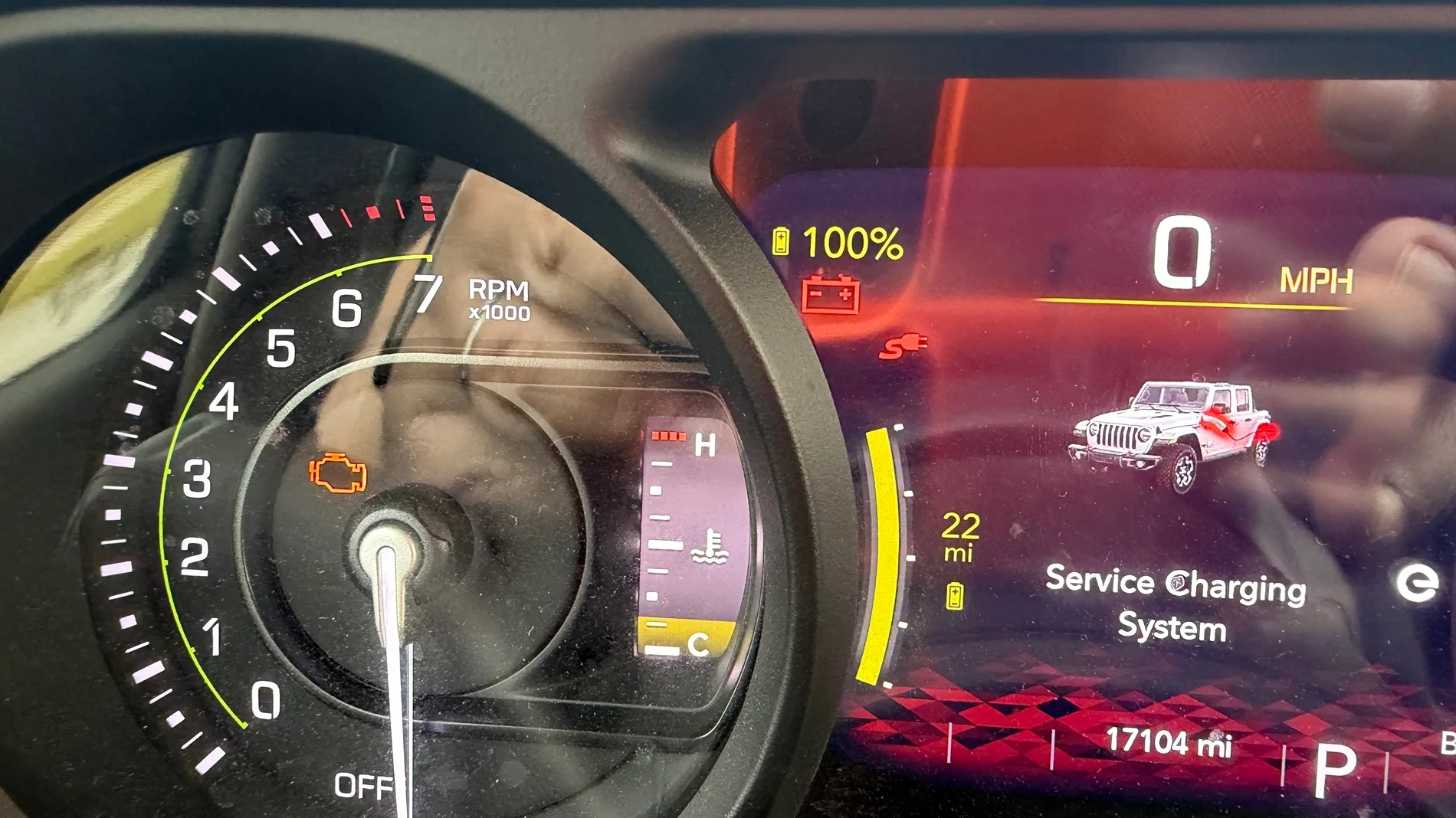

Mine started acting up a few weeks after getting the 68C recall done. Similar to what you're mentioning above. My battery percentage would also do weird things like drop from 50% to 30% without hitting the numbers in between. Or it would switch from Electric to Hybrid when I still had 10-15% left on the battery. It died in my driveway a few days later and has been sitting at the dealership for almost a month now.
Jeep Wrangler JL Has your 4xe been having issues accelerating/acting strange recently? Please comment on this post! IMG_6835
Our Grand Cherokee 4xe also passed 68C. Didn't notice any of these issues on it, but the battery no longer holds a charge after passing. Loses almost 20% overnight and gets about 7 miles of range. That one is also sitting at the dealership for almost a month now and they haven't even figured out what's wrong with it yet because it hasn't thrown any codes.
