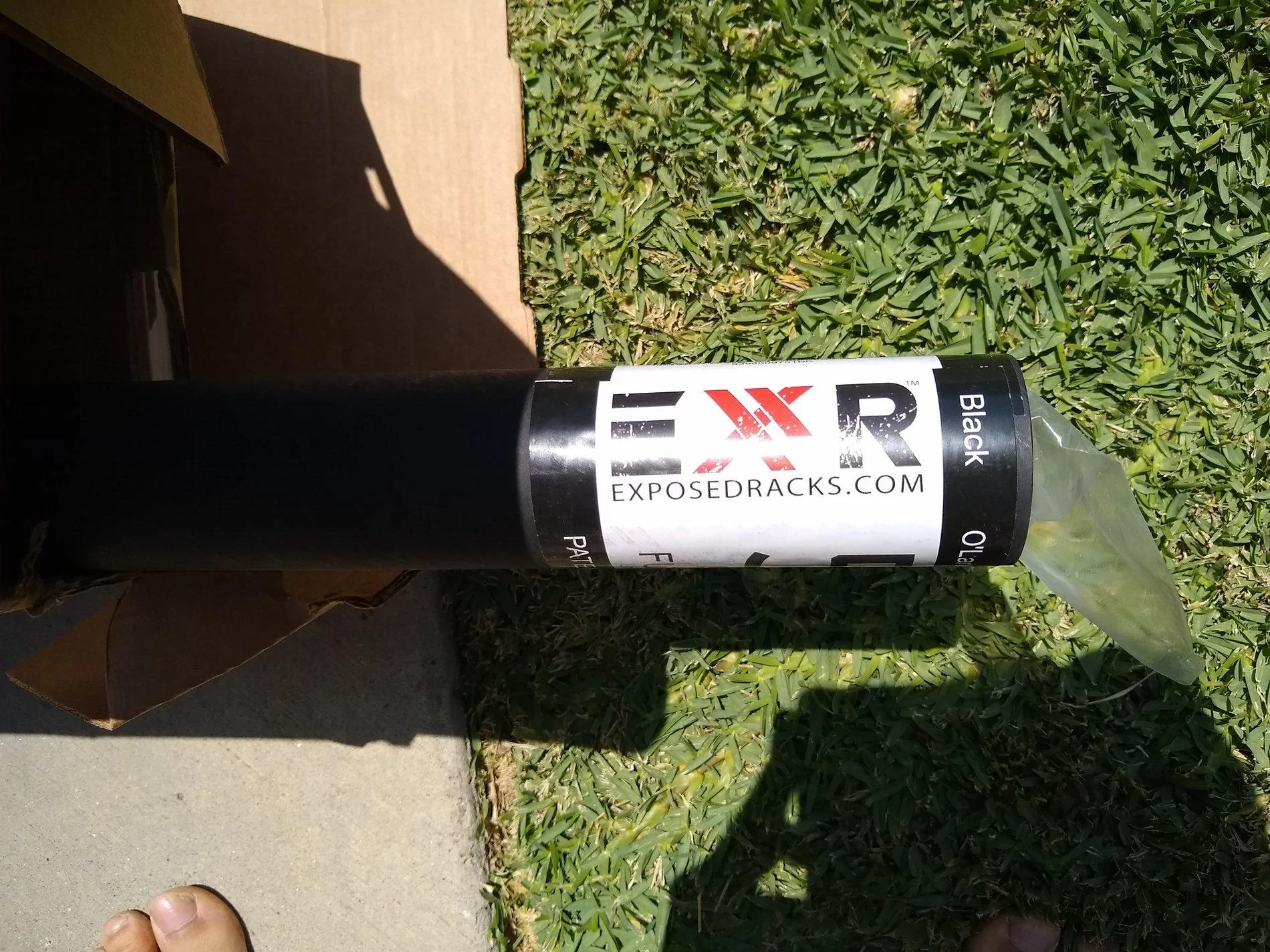

I just got them today! and kayak click in accesories just shipped!

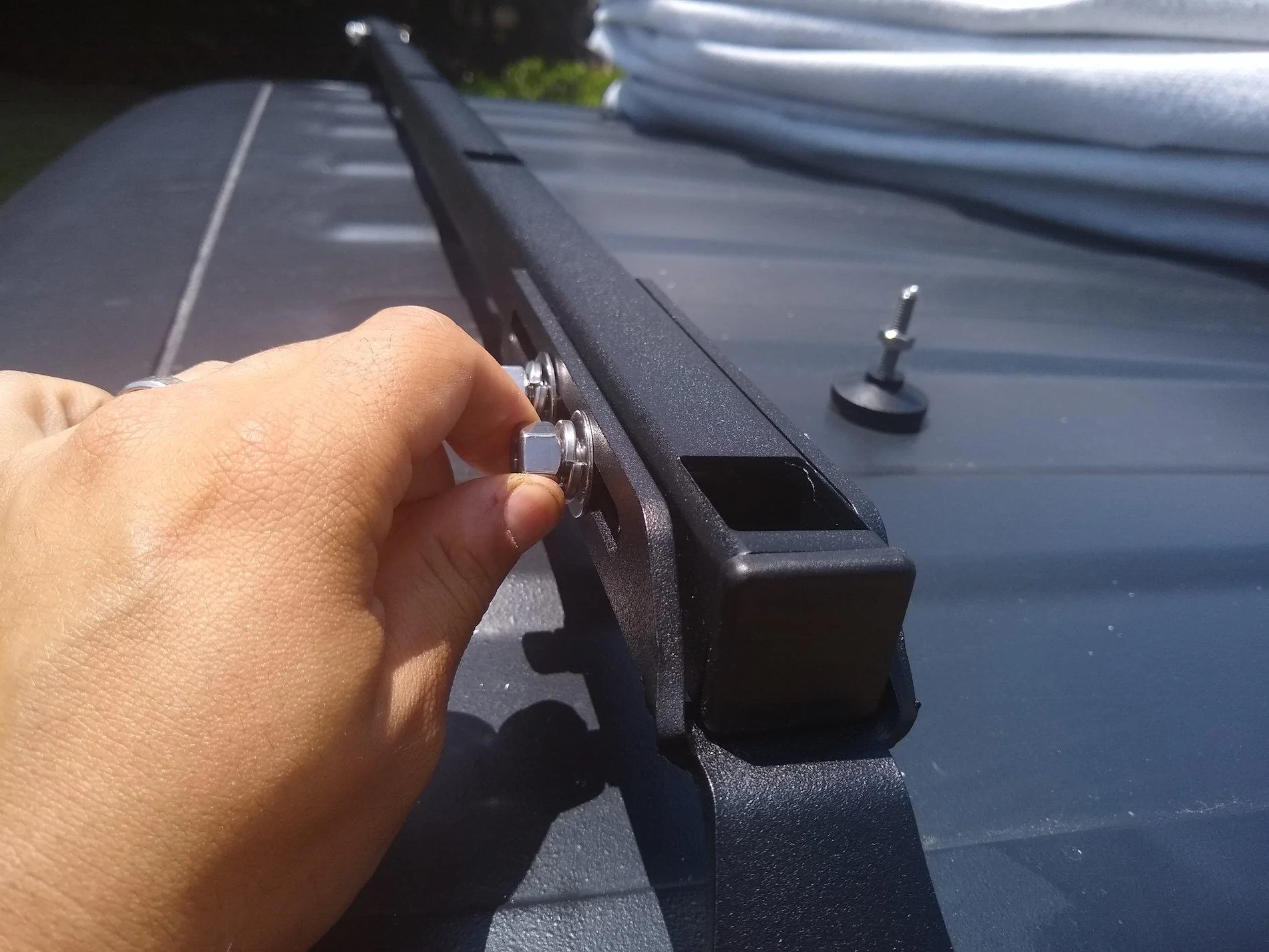

Installation is pretty easy until you have to install the hex bolts and the little brackets that go under the rain gutter. That is such a pain and you can EASILY stripe the bolts so be careful. Also, you will most likely cause scratches inside the rain gutter. I did, because the supplied foam around the brackets is not very good and doesn't cover all of it, so maybe get some thin foam before installation if you care about scratching.

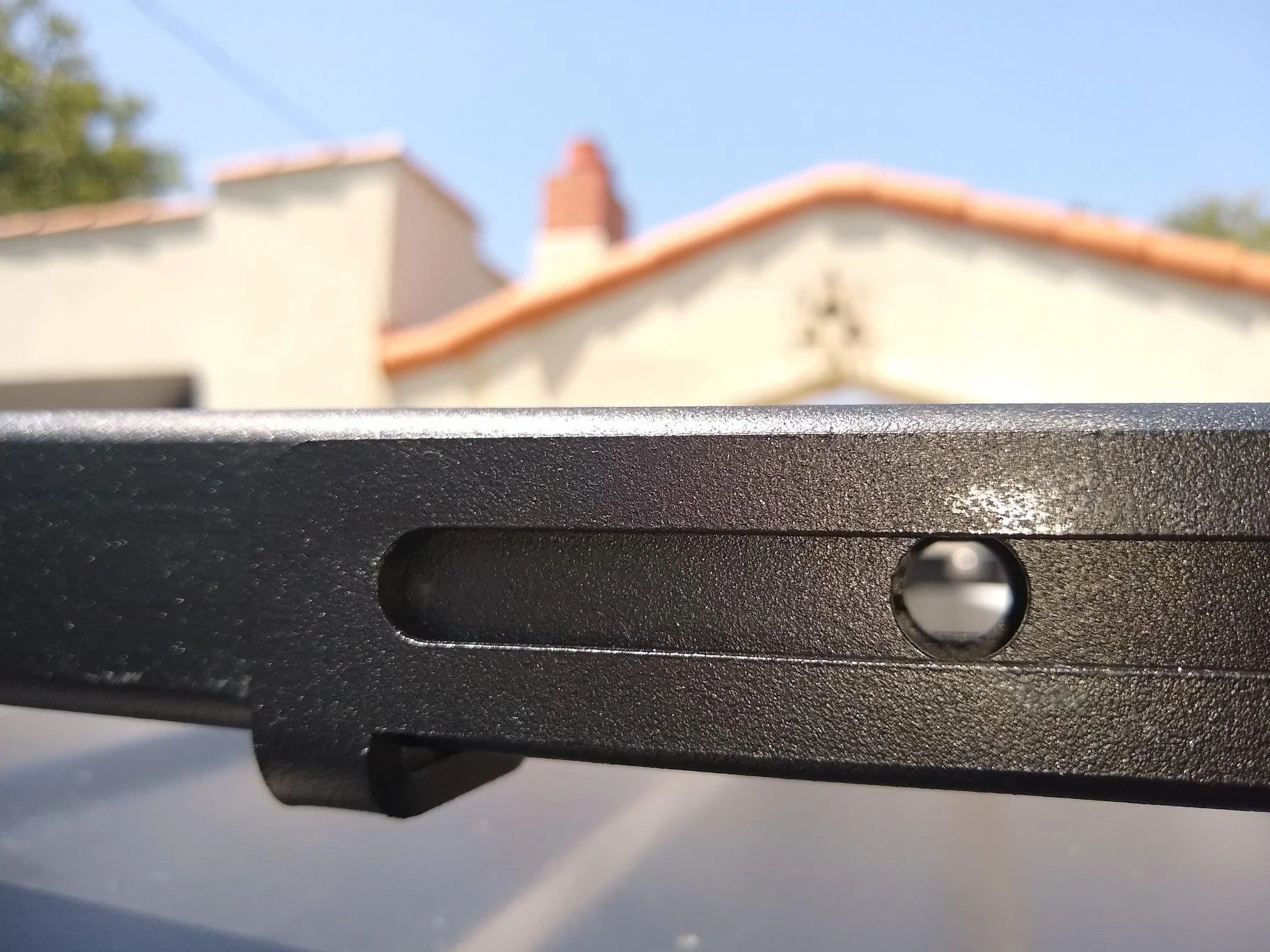

Today I tried removing the bars to install support feet. partially failed.
the bolts can stripe easily. I used hand tools and tiny wrench, but the steel on the bars is very hard and if it touches the thread, your bolt is gone.
make sure the holes on the bars are well aligned with the brackets, and be VERY light with tightening.
Luckily for me a quick trip to the hardware store will fix my issue.

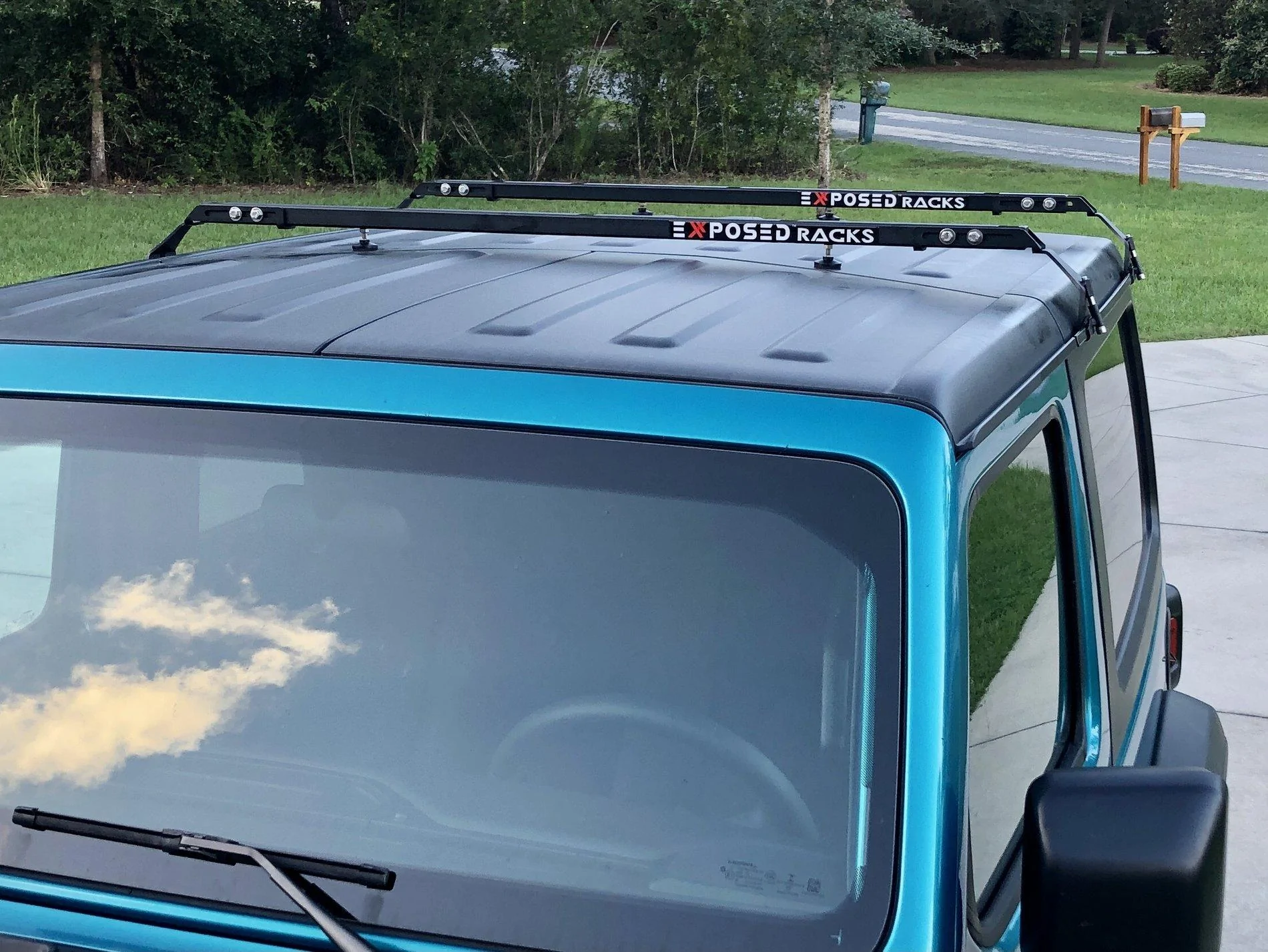

Just a quick update, my racks came the last week of July while I was on vacation, so I installed them in the hard top the following week. Pretty easy and straightforward, maybe took an hour or so? However, I’m still waiting on the click-in brackets to connect to my RTT. I got an email on Monday though saying they shipped, so I should have them by early next week, and will hopefully be able to get the RTT up there next week as well. Gonna start getting cold up north soon, so will spend weekends camping further south, which will be wonderful.
