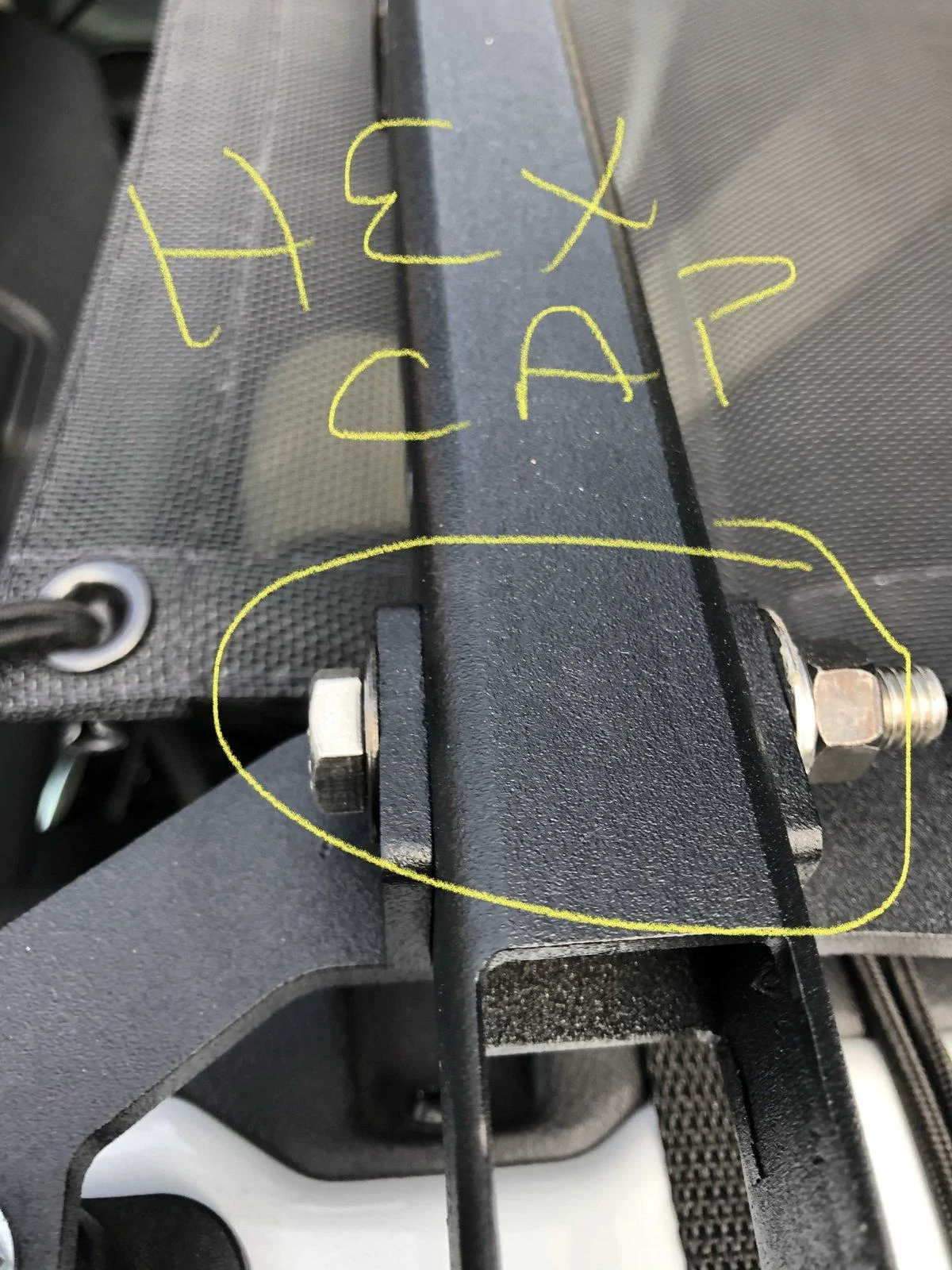

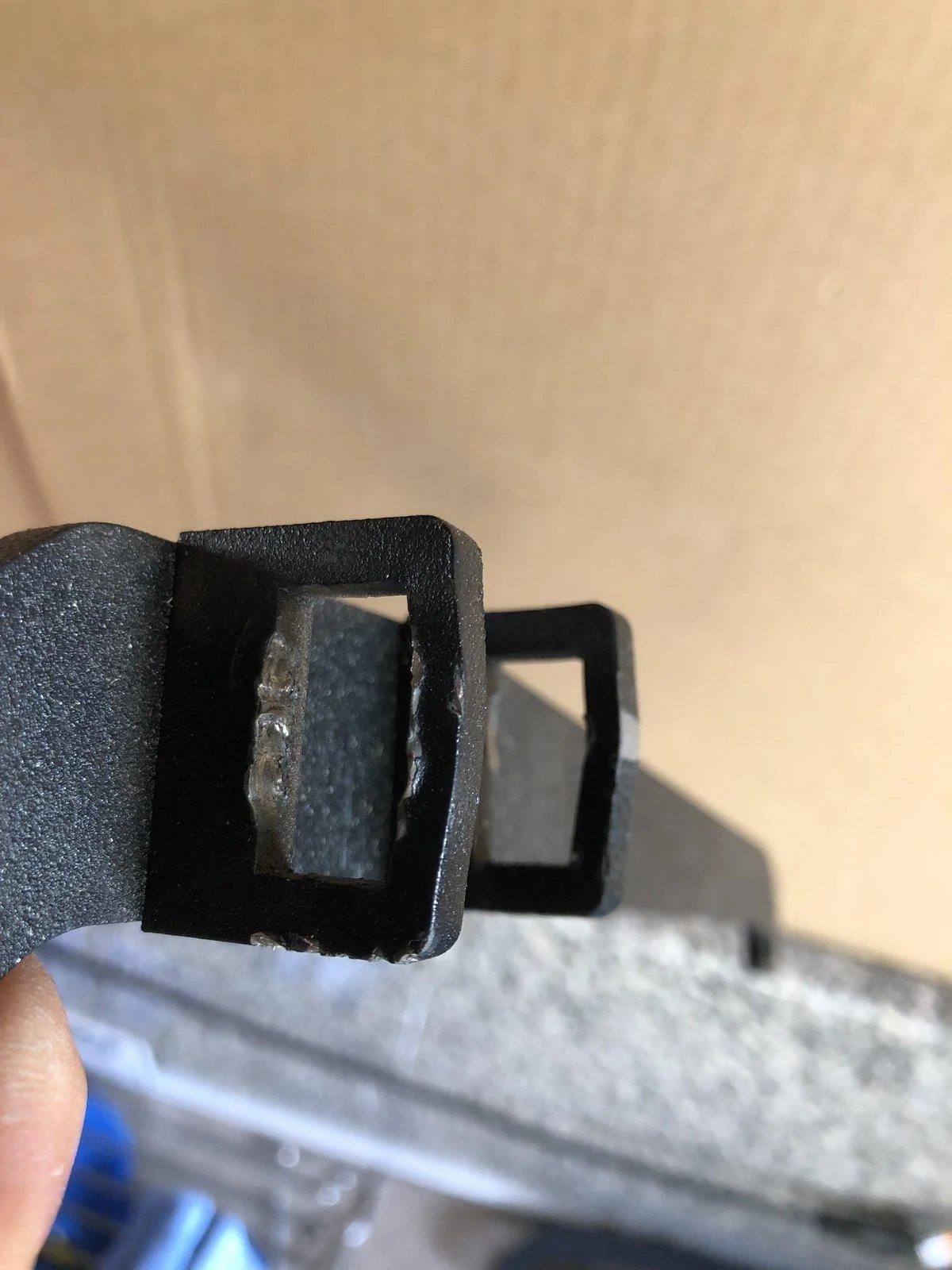

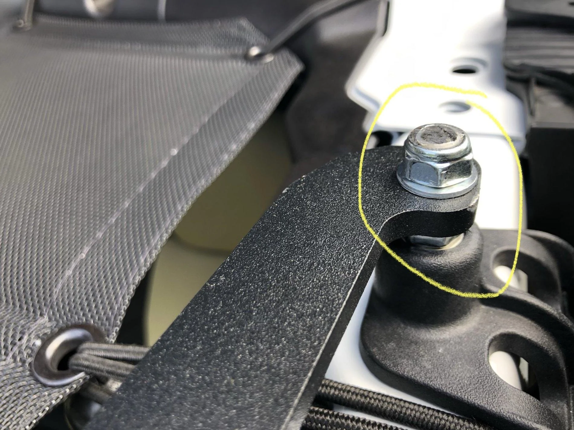

The supplied carriage bolts may strip out the hole when trying to remove. I stripped all of mine. The company was working on different bolts. They sent me hex caps that work much better and no worries of stripping them. And I cut all the extra threads off all the bolts. The back ones prevented the top from sliding in the track

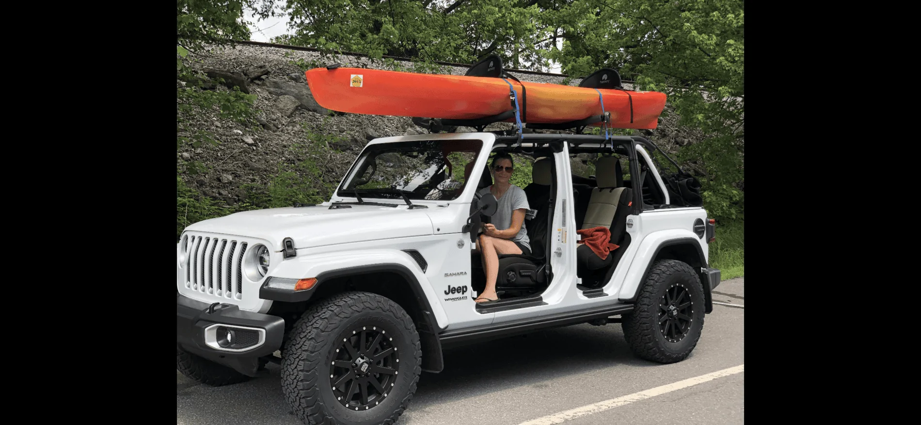

Used mine for the first time. Took a while to figure out the easiest way to strap it down. Still trying to figure out how to carry the kayak without removing the windows and just using the sunrider position. It needs to be about 5” taller to clear.
