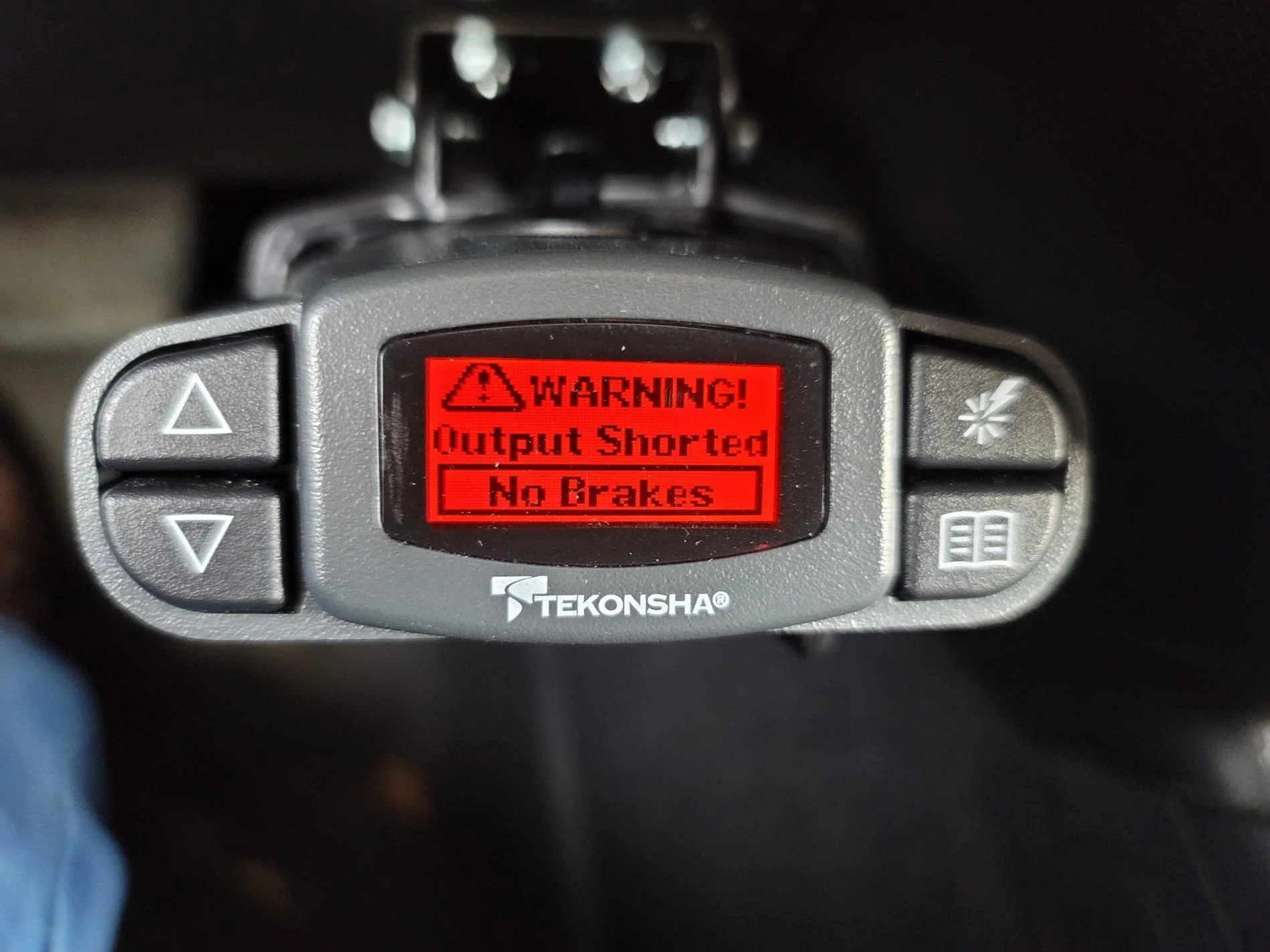

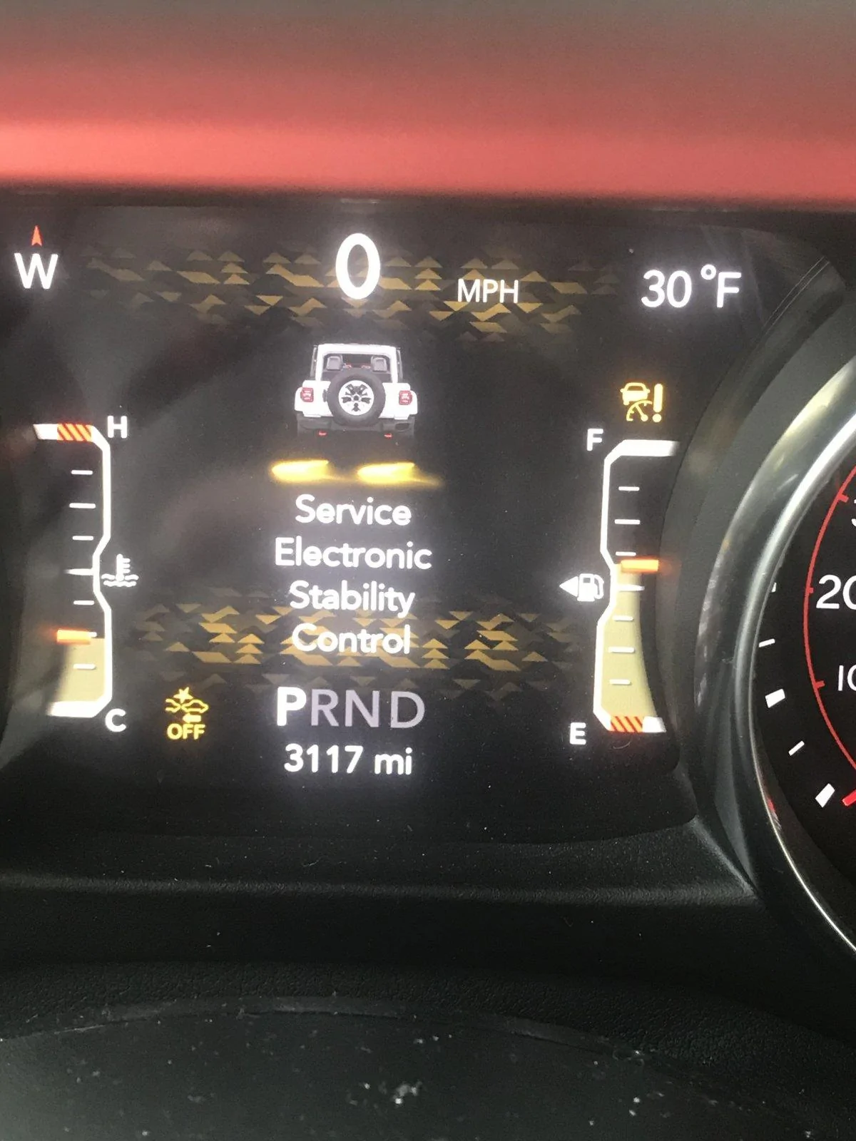

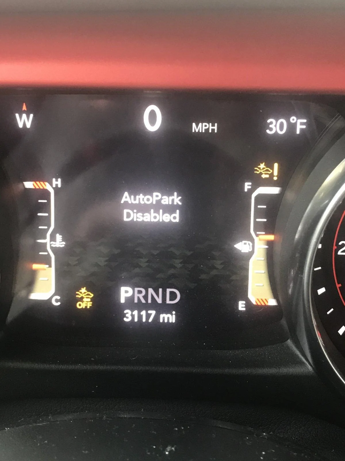

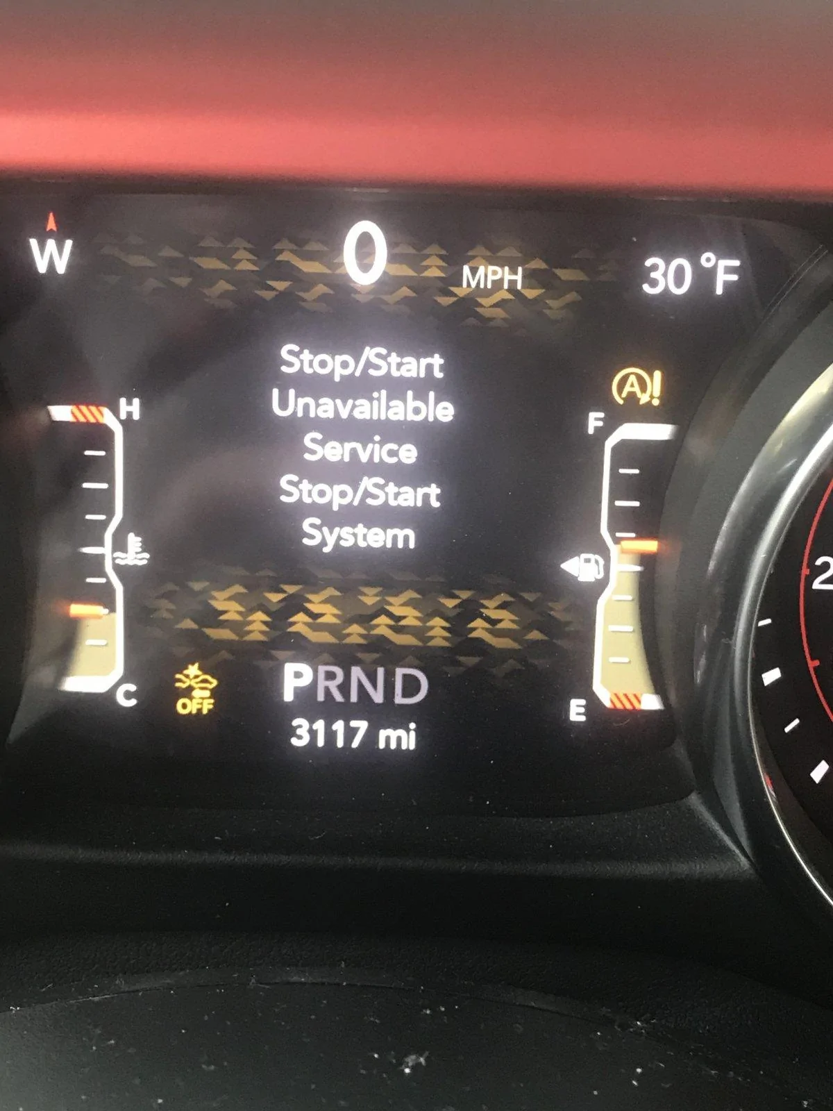

Having a real issue with my dealership who installed by Mopar brake controller. Their saying it’s normal to have error messages with trailer not attached. My build date is July 2020 and from what I have been told through this forum is that the error messages should not be happening. One service bulletin did not apply to me due to my build date. Can you give me the service bulletin your referring to and the specific reprogramming needed. Would love to show my dealership something in writing. Thanks for any help you can provide.
