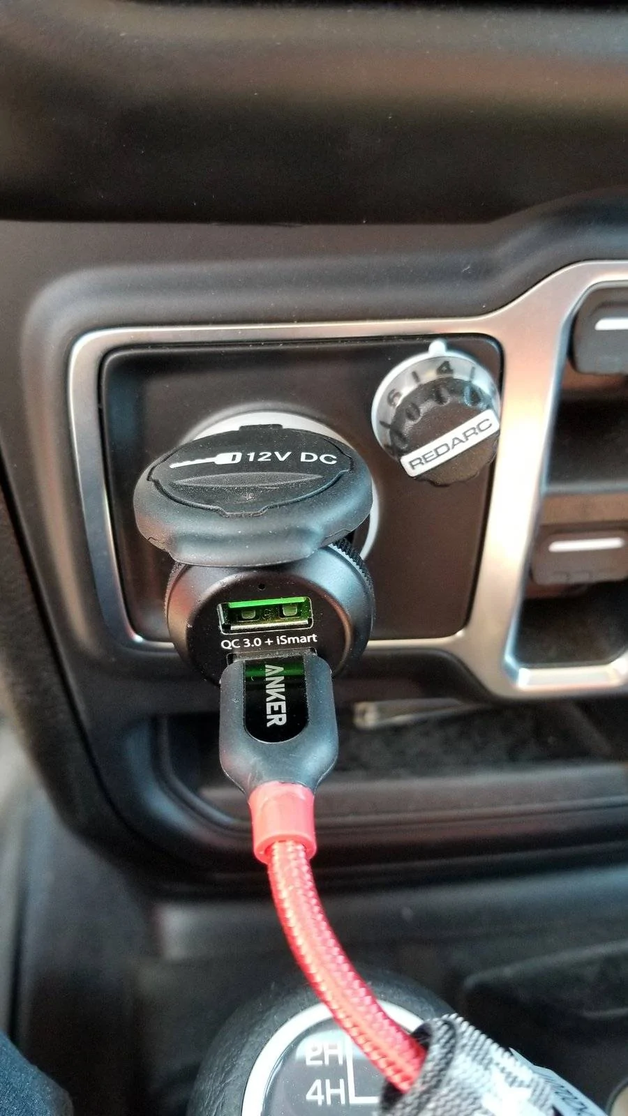

I recently saw this pic from someone in a JT forum. If I was going to do it again, I might do this because the redarc is a great unit (functions the same as the mopar one) and that is a good location w/ keeping the 12v port. Now I will say from installing my mopar harness, I don't think installing the redarc in this location is going to be easy. There are some features on the backside there behind it that will make this a challenge. But this is next level install location, I love it.
