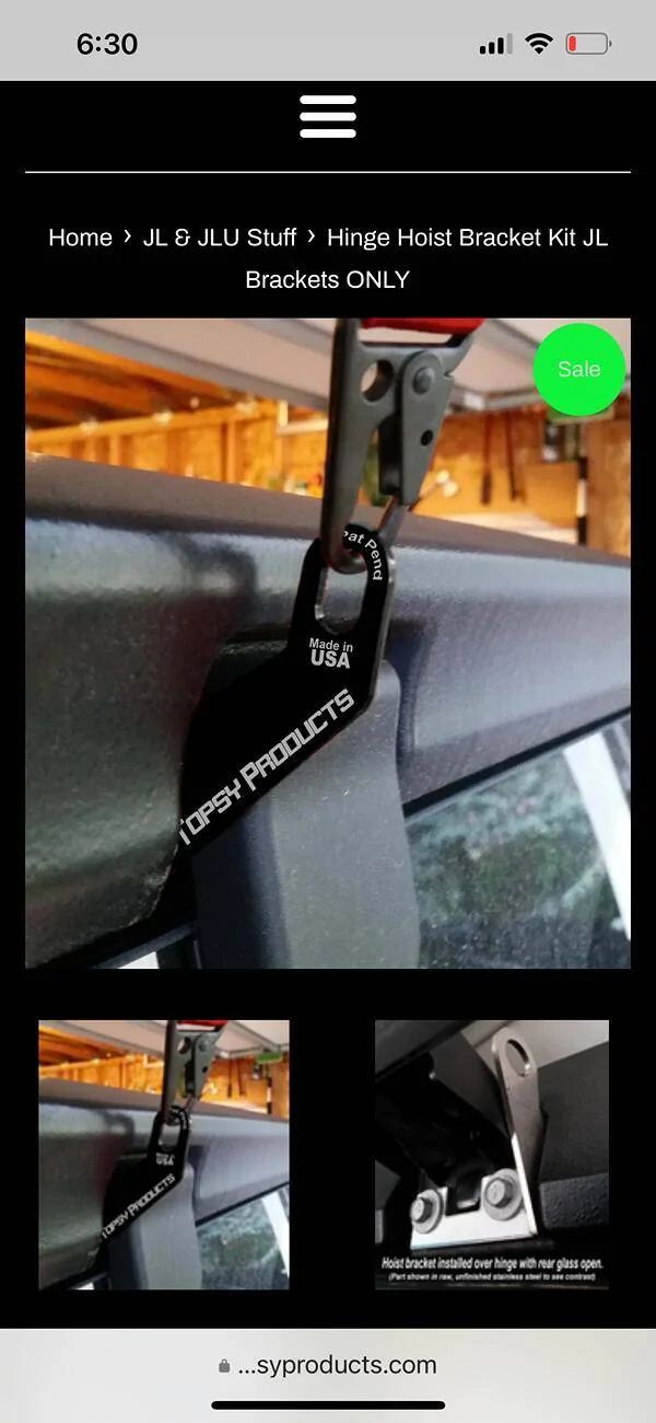

For the rear this company makes some choices.
https://topsyproducts.com/collections/jl-stuff

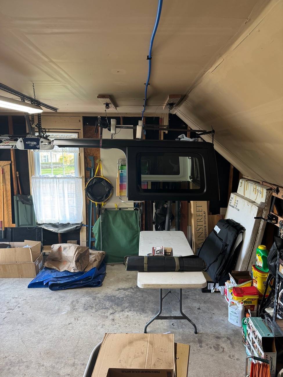

I went with the Lange setup. You grab by the installed hooks allowing the window to remain shut. I had the sloped rear ceiling so keeping the window shut was important.

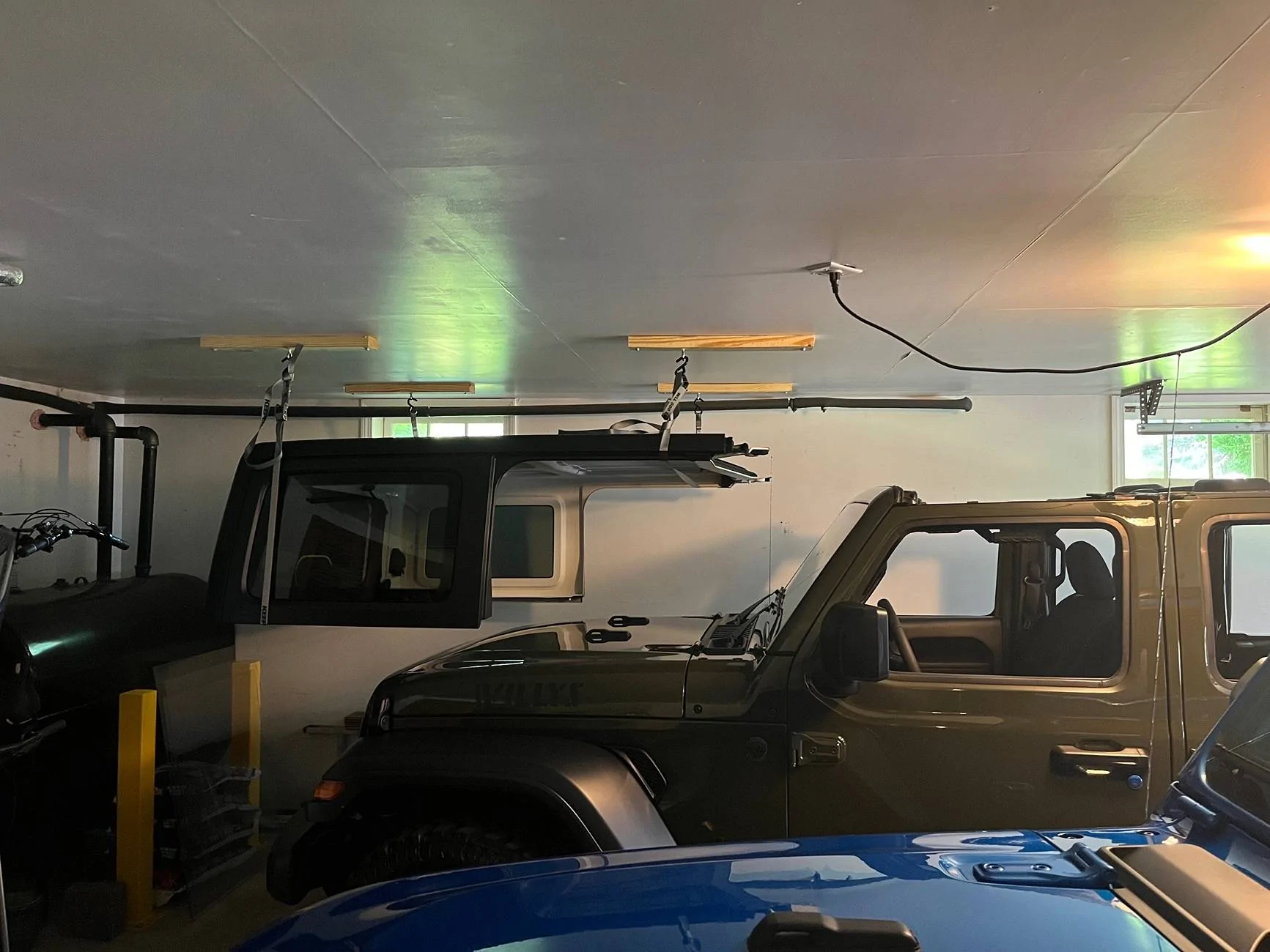

I use Lange and keep my window closed. I’ve heard no complaints on Harken, so likely just personal preference.
As for the install - if the rafters are exposed and you have an impact driver for the lag bolts, I think you could get it done pretty quickly. You could do a lot of pre-work, so you’re taking a ready to mount setup.

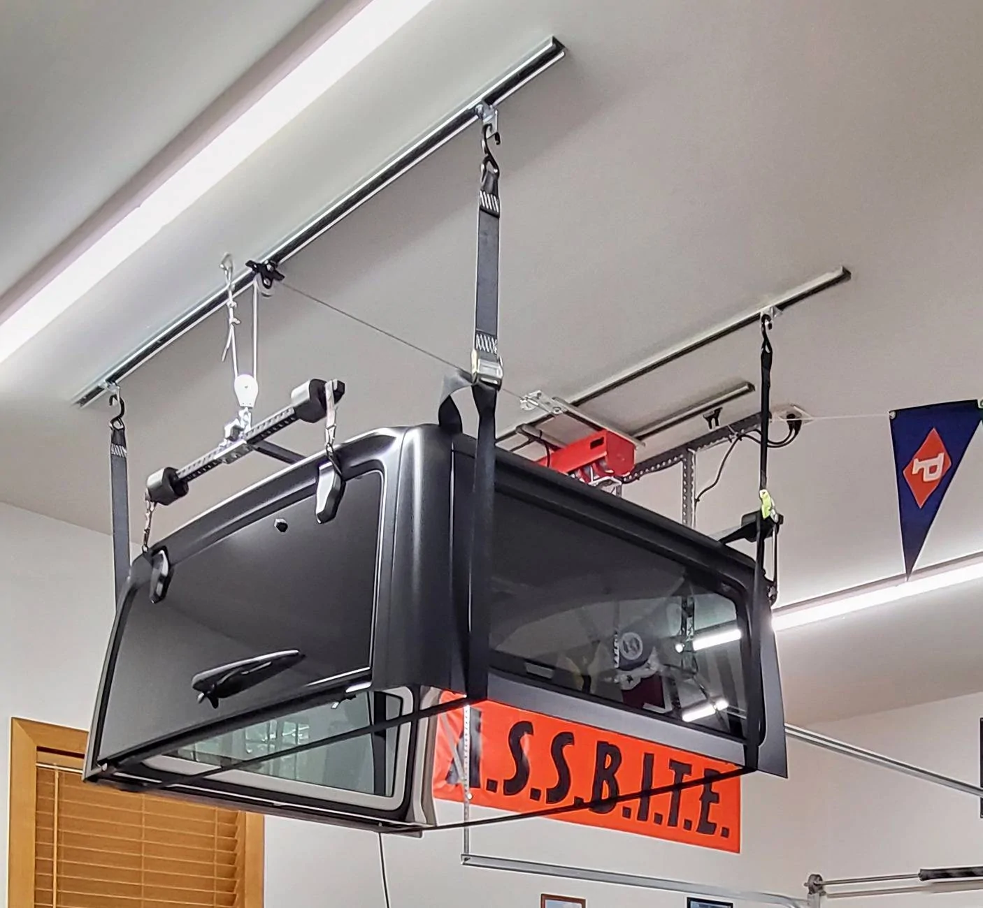

I store mine with the glass down as well. Agree on the topsy hooks. I also use their strap.

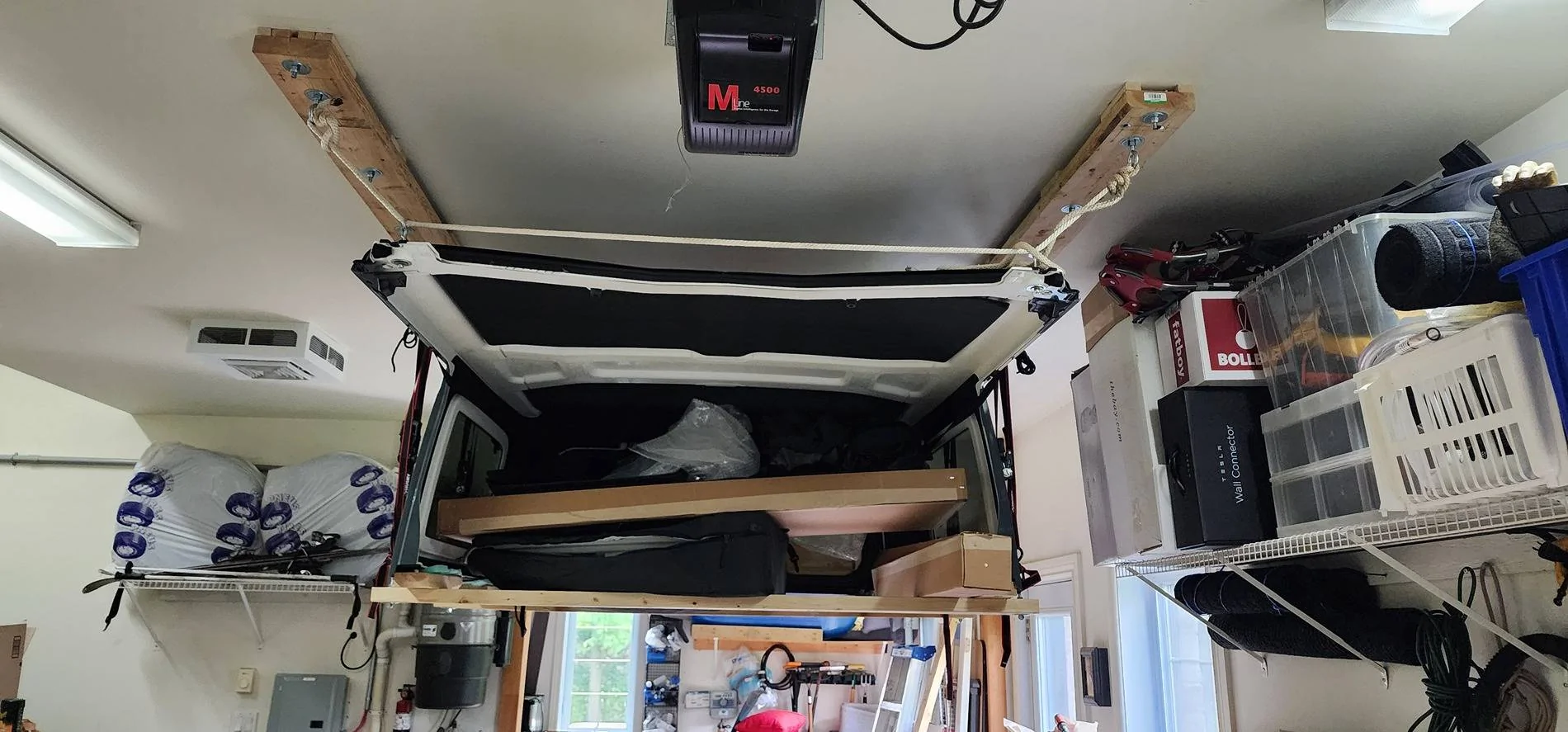

I reinforced my own i beam perpendicular to the ceiling joists then used threaded rod to sandwich that together with another 2x6 so this really helped spread out the load.
I used the HARKEN rope hoist and it's straps for the initial lift then, I put 2 2x4s across/under the hardtop and use ratchet straps for final storage position/holding all the weight. This now also make a great storage place for the 2 front panels.
Then in the winter those 2 2x4s turn into dry storage for outdoor furniture cushions and such!
Here's a couple different pics.
