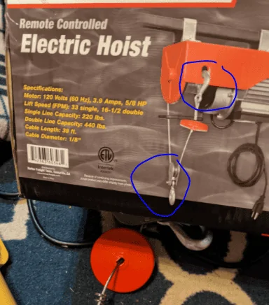

Never owned an electric hoist, and I picked up one from harbor freight last night. The question is about the rope block (weighted red stopper) and the spring seen in the attached picture. On the box it appears that the block is held stationary at the top of the rope. In the box picture you cannot see the spring at all, so it seems to me that I should somehow put the spring inside the small hole in the stopper, but I don't want to break it, and there is nothing in the instructions that I can see on how to accomplish this. Assistance would be appreciated.

The block and spring are for a straight pull. The picture you are showing is for a double pull to increase capacity. You wouldn't want the spring getting in the way for that kind of pull.

So what makes the stopper defy gravity as seen in the picture? I plan on setting it up for a double pull just to be on the safe side.

Could be staged.
I will have to look at mine when I get home tonight.
In the picture they have a metal clamp on the wire holding the red disk up.

The double pull refers to taking the clamp and mounting it to the top of the winch, and installing the pully clamp. That's how you get the strength for 440 lbs vs 220.

All the reviews I have read about this hoist have been fairly good. as long as you are within the weight requirements you should be good. They have another hoist that is only slightly more expensive, but doubles your load to 880 lbs I believe when you set up like this for a "double pull".
