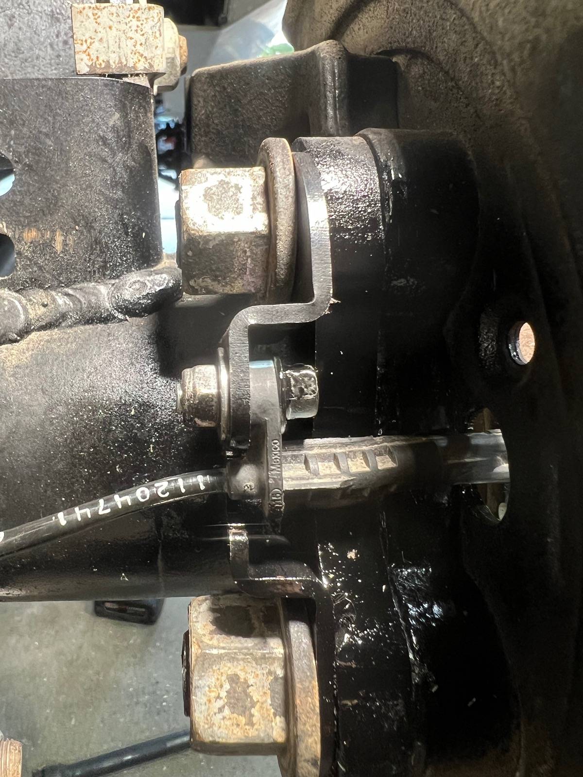

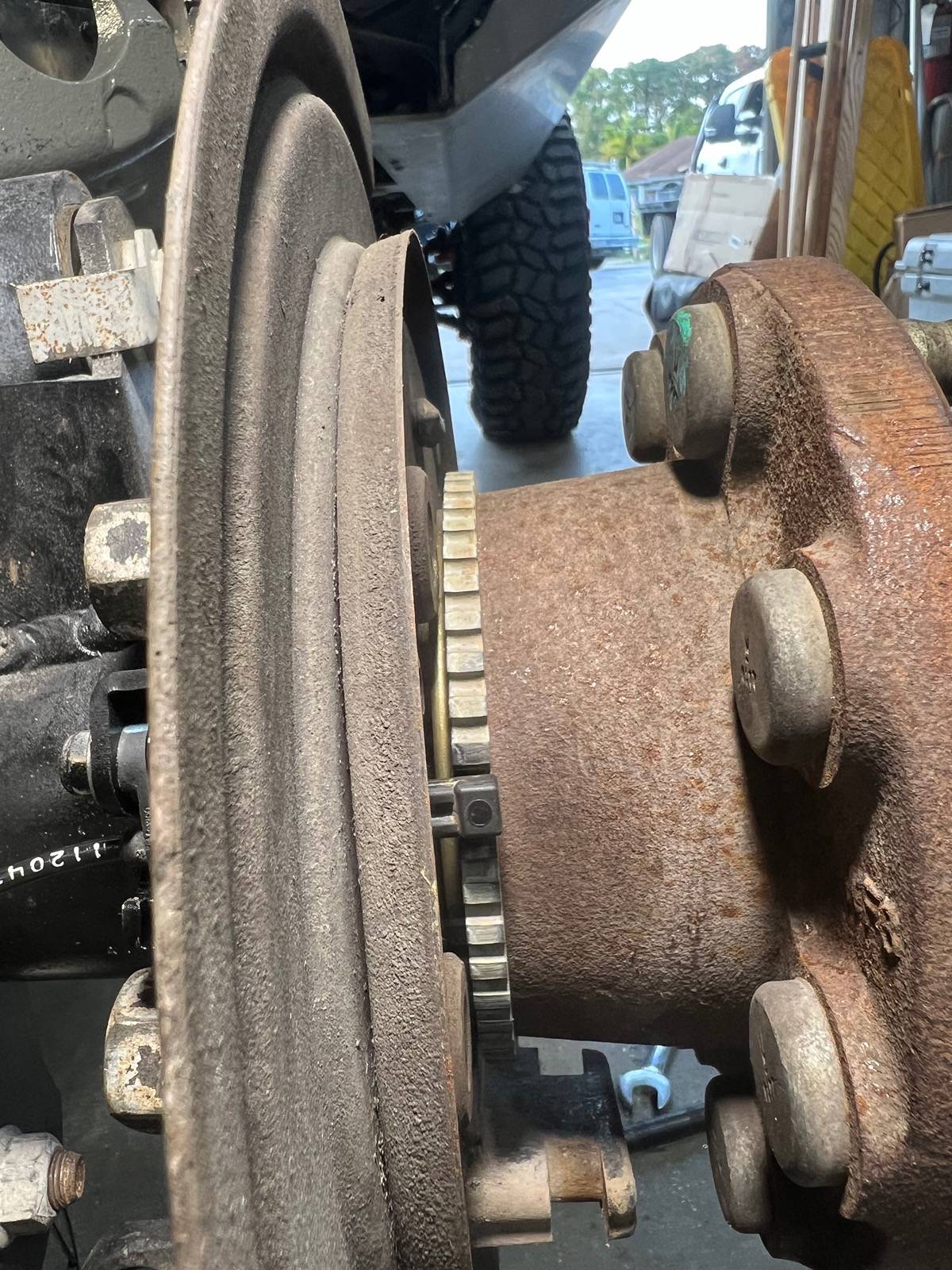

I figured since I haven’t been able to find anything on it and Artec has yet to make a jl bracket I’ll share what they vaguely tell you.
Yes a jk 14 bolt abs sensor bracket will work, is it a long term solution? Well no but it works for the time being.
If you thread in a bolt to the thread insert and knock it out with a hammer you can through bolt the jl sensor from the inside of the bracket and it puts it near perfectly inline with the tone rings.
So far so good. They haven’t shifted at all. No lights on the dash.

Is there a specific air gap measurement you found that works? And what tooth count, and brand tone ring are you running? I’m looking into doing the junkyard axle swap on mine. Trying to do as much research as I can before I commit to it.
I just eye balled it and haven’t had any issues. It’s pretty easy to judge how far off it needs to be.
I’m using the Artec 52 tooth tone ring. Hopefully Artec comes out with the jl wheel speed brackets soon.
I have almost 2k miles on the swap and haven’t had any issues. Only thing I noticed is if I drive through a large dirty puddle it trips up the wheel speed sensors for a second but then goes back to normal in about a minute.
It’s really not as hard as it looks it just takes some time and planning everything out before hand helps a ton.
There might be more info for you in my build thread.
