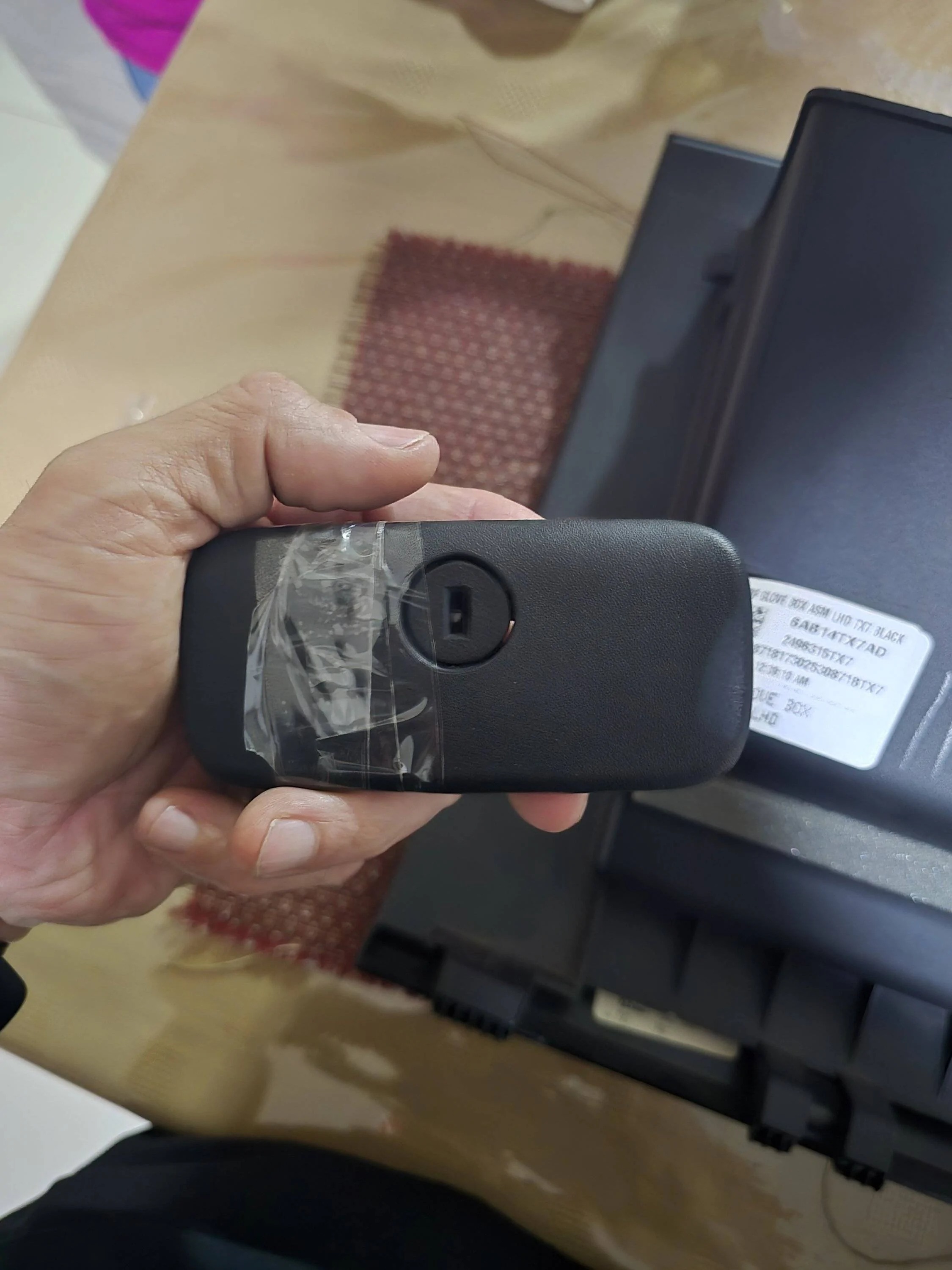

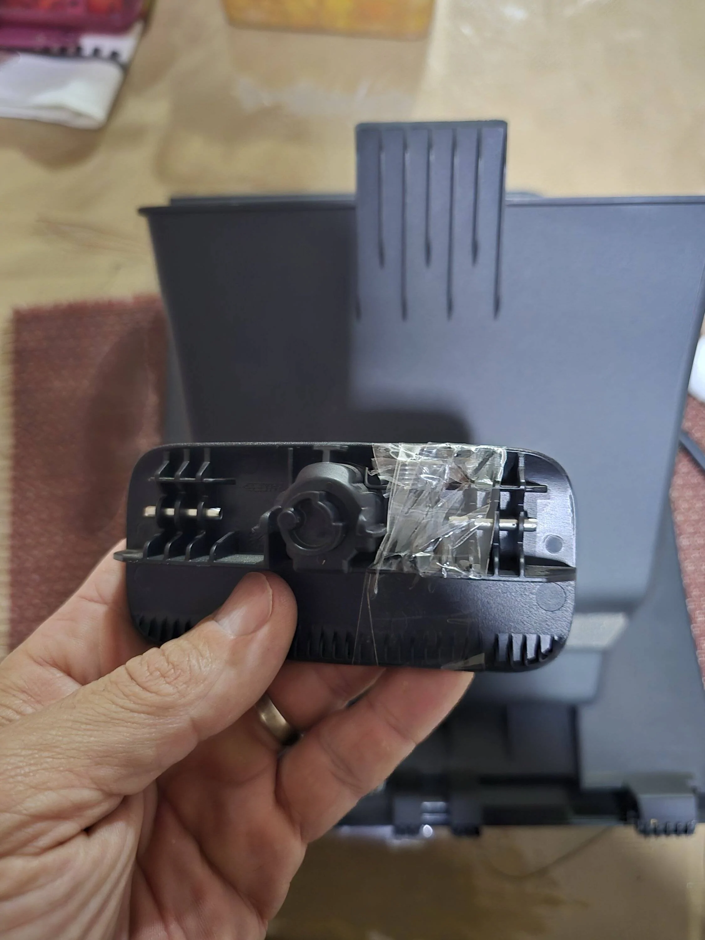

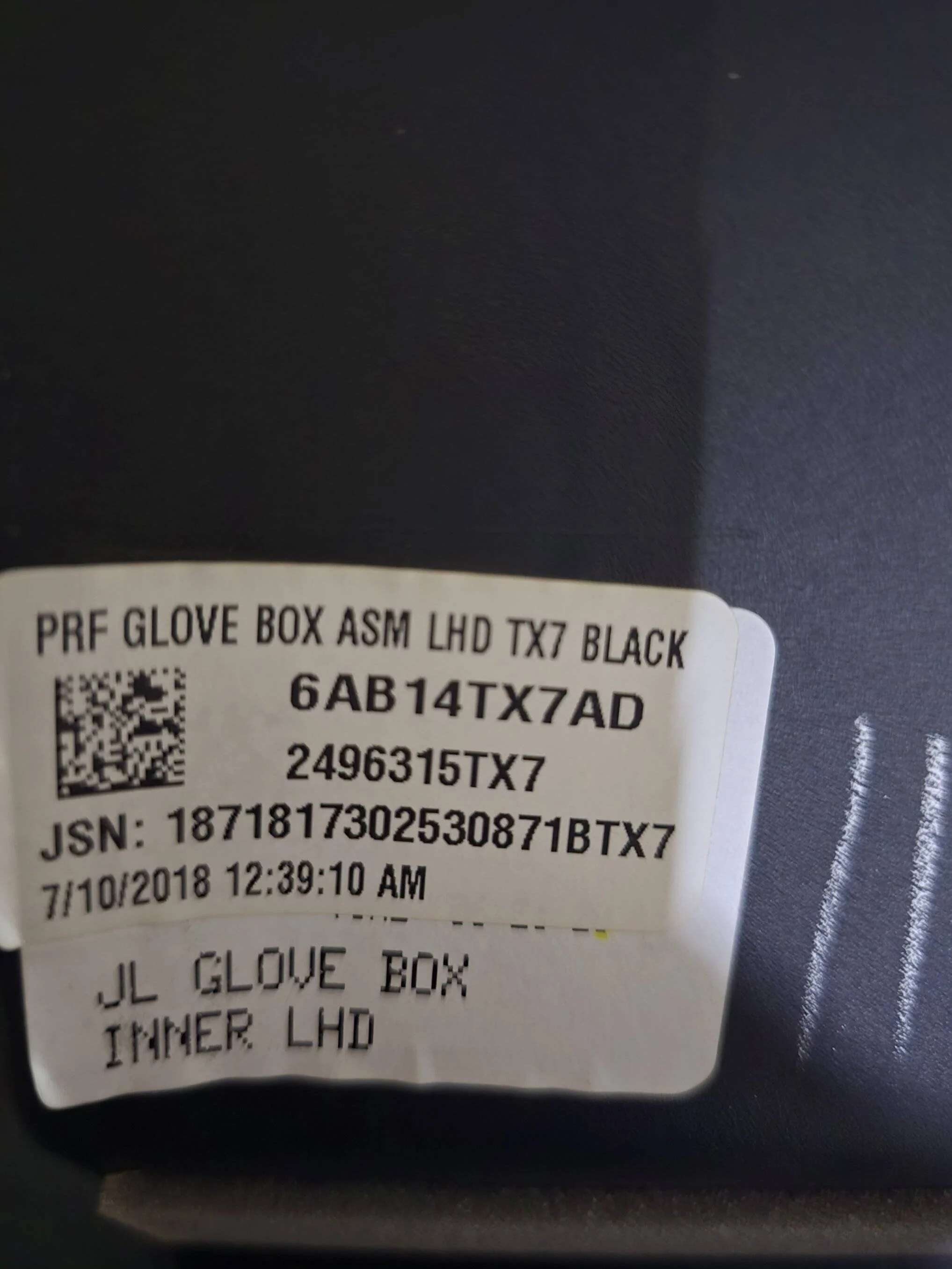

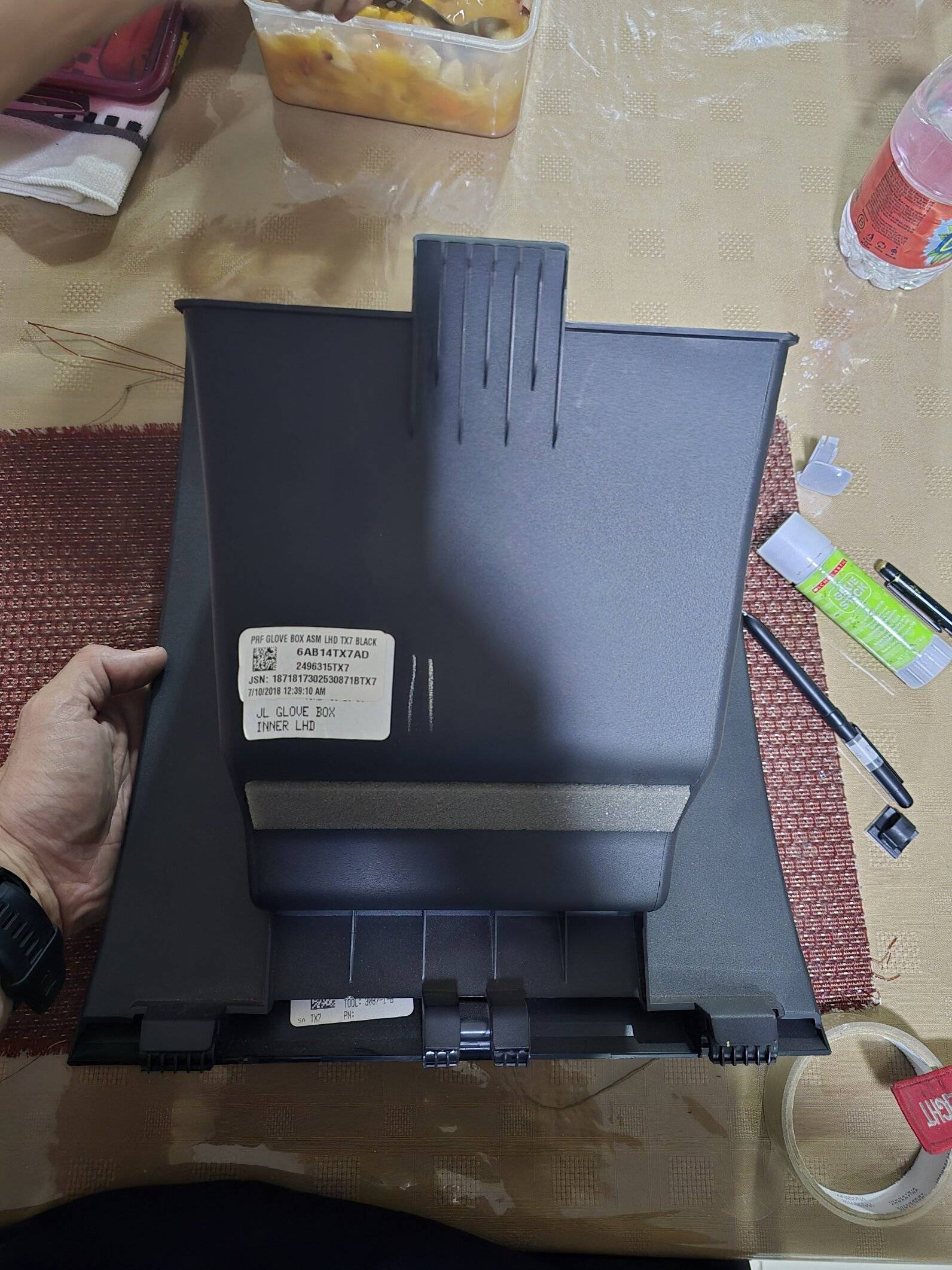

Good day, my glove box latch broke last night on my 2018 JL. After some research, I found that you need to order two different part numbers:
Entire Glove Box: 7FV19TX7AA (Replaces 6AB14TX7AC)
Cylinder: 68384451AB
My question is, how difficult is it to attach and set the key to the new cylinder?
