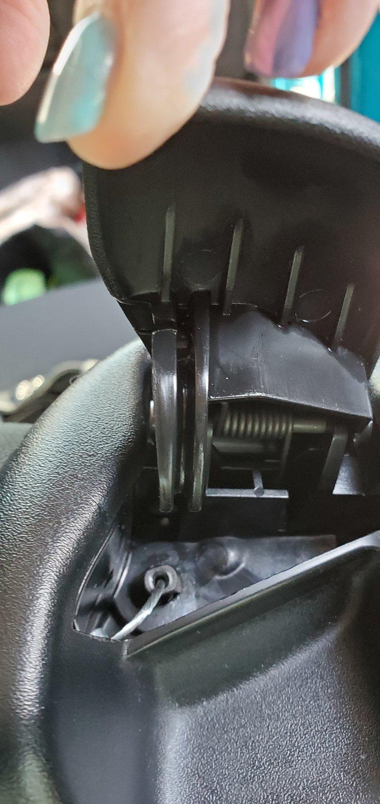

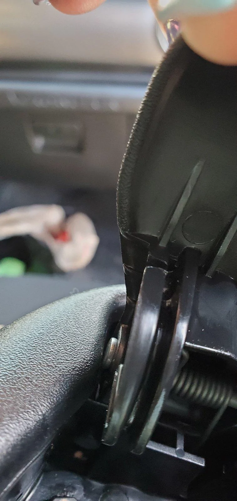

Hi! Needing some help here.I have had my 2019 wrangler for about 7mths...this is the 3rd time my passenger seat latch has broken. Dealership has fixed it twice and it just happened again after just using the latch twice.
Any tip or tricks to fixing this as the dealership seems not be able to repair it would be great!

Edit: Looking more closely at your pictures, your cable is popping out of the handle. My fix won’t help you.

It looks like your problem is that the cable cinch has worked its way out of the latch detent. Typically the cable pressure itself holds the cinch in the detent. However, if there is enough slack in the cable it can get loose.
If you can pull up on the cable, work it into the slot and fit the cinch back into the detent then you can save a trip to the dealership. Better yet, if you can dab a little Gorilla glue over the detent with the cable back in place, maybe it won't work loose again. At least it can't be any worse. --- Wait, yes it can...
