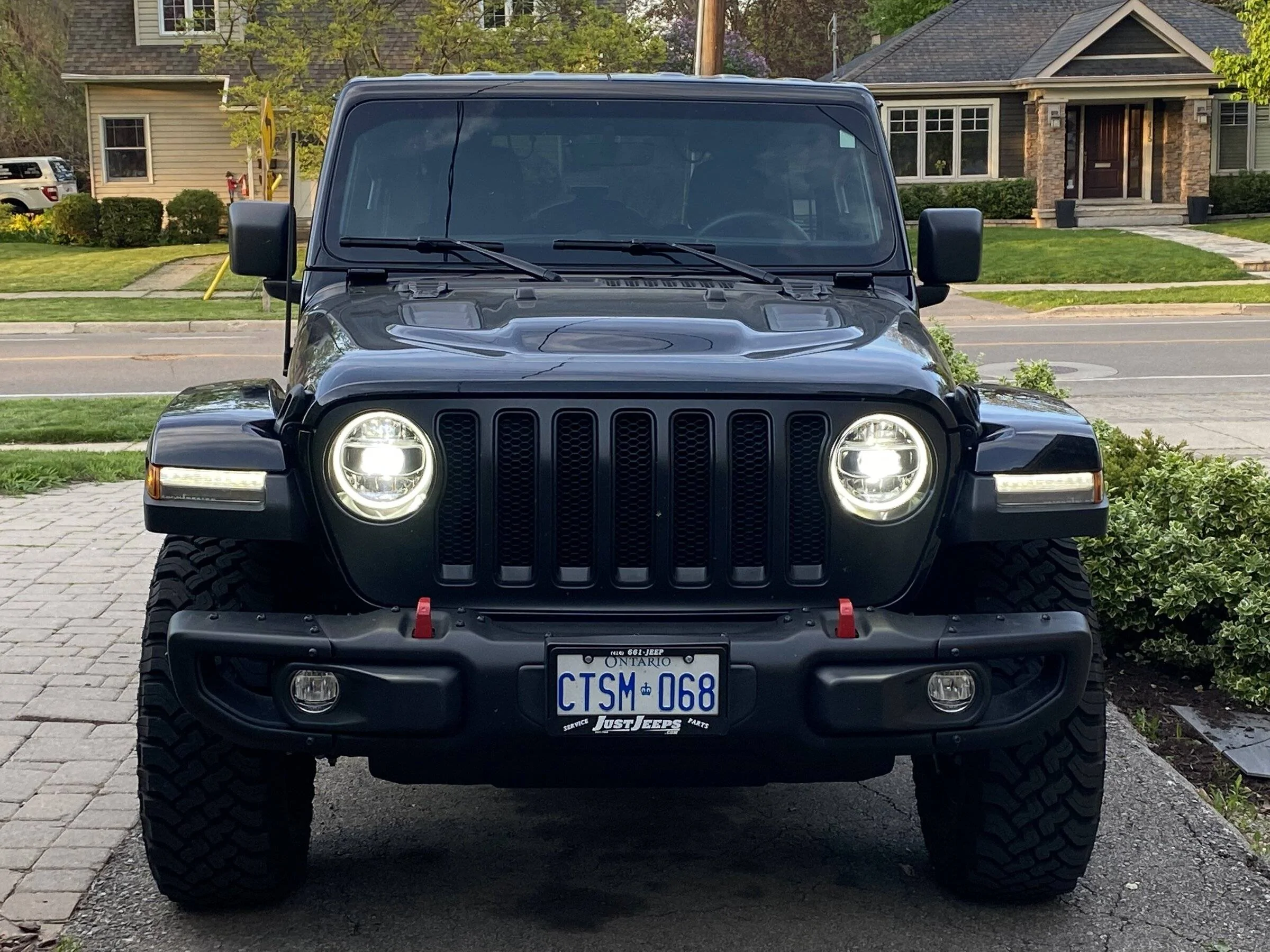

I had the same issue last year. Couldn’t find a JLUR with Steel Bumper and LED package, didn’t want to wait. So I bought some take off headlights and DLRs from someone on this forum. Picked up the front bumper and a Tazer Mini from Just Jeeps in Toronto. Installed last weekend. Really happy with the result.
