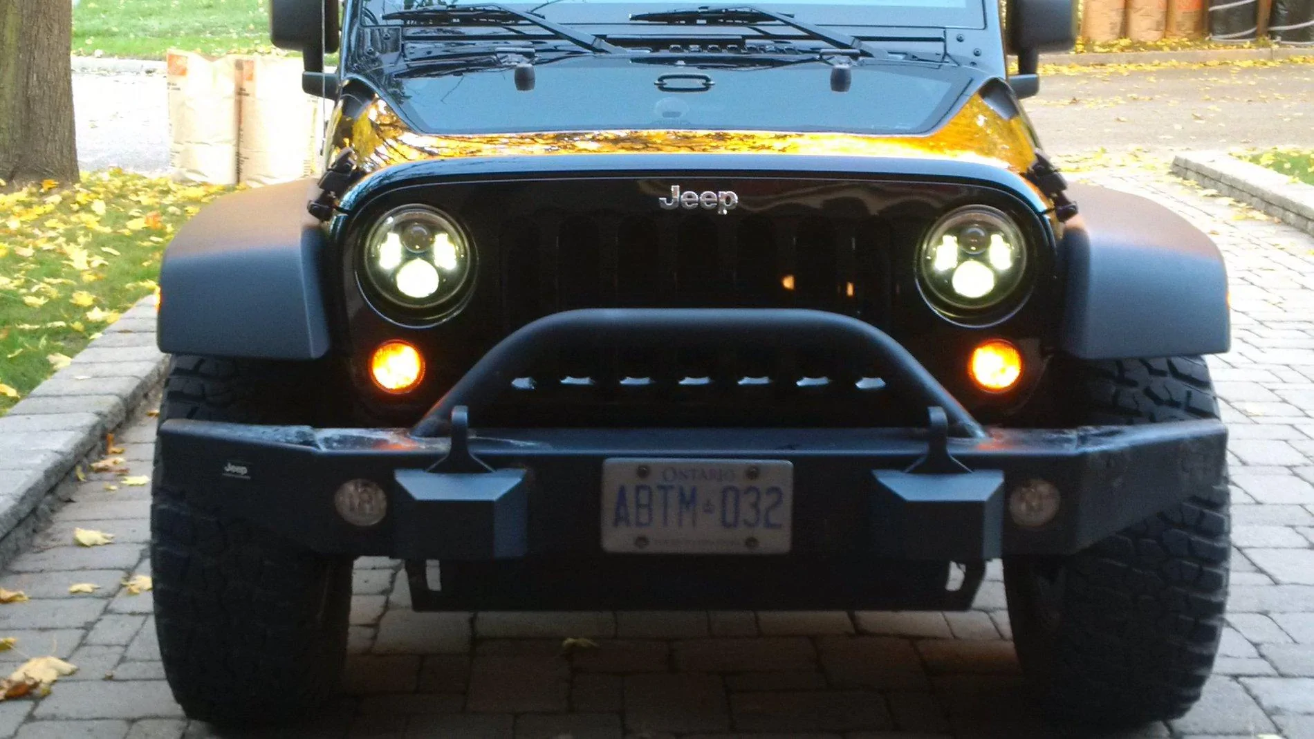

I'm not 100% sure how the Sunpie headlights work or how they are wired up, but you may need to buy yourself the AEV Procal Module for JK in order to get your headlights working the way you want.
I ran the JW Speaker 8700 J LED headlights on my 2012 JK, and with the AEV Procal Module for the JK I was able to program my DRLs to come on in a number of different ways i.e, Regular intensity low beam, Half intensity high beam, Marker lights/Turn signals, European (never got this option to work), Fog lights or even turn them off entirely.
I ran my JW Speaker LEDs in the Half intensity high beam setting for about 5 years with no issues.
Keep in mind that the JW Speaker LED's were 100% plug and play with no need for anti flicker modules or any additional wiring, so your Sunpie headlights might not work the same way.
