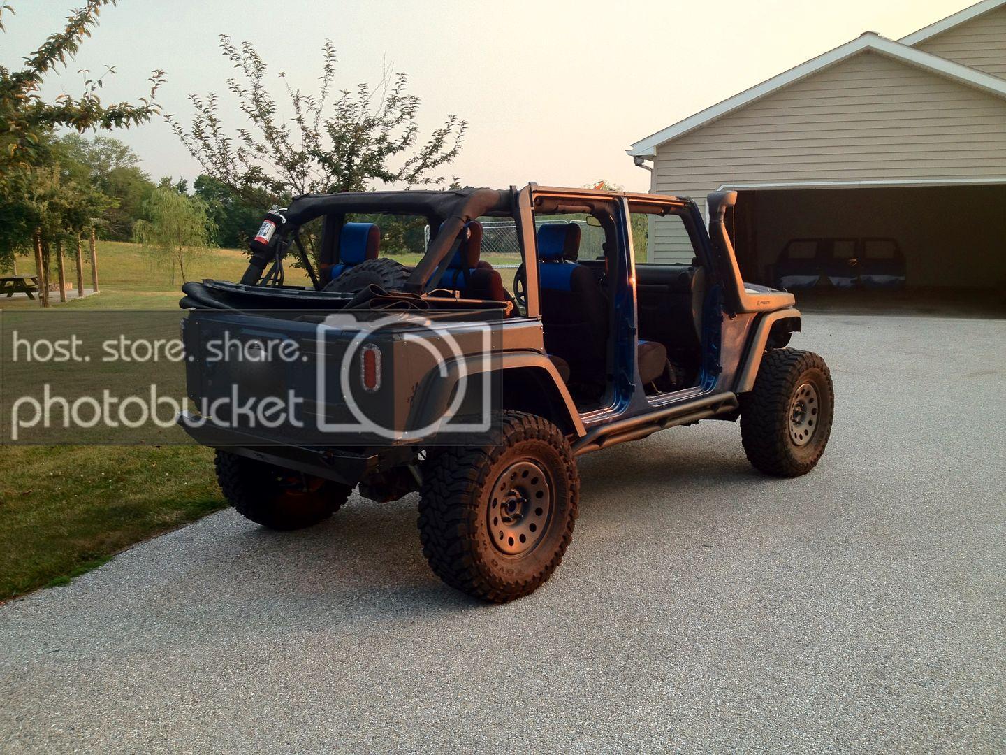

So a little background up first. I used to go to Rausch Creek at least once a month with my JKU, but that was 7 years ago and since then I sold the JKU and moved to North Carolina. I am moving back to Pennsylvania in a month and just got a new JLUR so I want to get back on the trails. My question is what mods should I do before heading back to make sure I am going to be ok. I know to bring all the recovery gear, lunch, and water. I am mainly wanting to do greens and blues so I was just wondering if I NEED any certain skid plates or armor first like I did with my JKU. Pics of my old JKU for now too. Thanks for all the help.

I would take it stock a few times learn the Jeep learn the terrain see what works and what doesn't for the area, skids and diff covers are a good add at any size if there are rocks involved

That was my plan, however I just wanted to ensure there weren't any super vulnerable parts that I should protect first.

The most exposed part I would say would be the front diff cover, it's the same pot metal cover that they have been putting on since the dawn of time, next I would say the fad on the front axle it has a skid but nothing I would trust, next would say tranny it's fully exposed and the auto as a few low hanging lines.

I added front and rear skids and rear shock/ca skids, because I beat the H out of them around Tahoe. The rear shock mount are pitiful you need to shield them imo. My front diff drain plug was uneven after a few trails, so I put the Rancho skid on it.
I’ve not scratched the stock fad plate yet.
